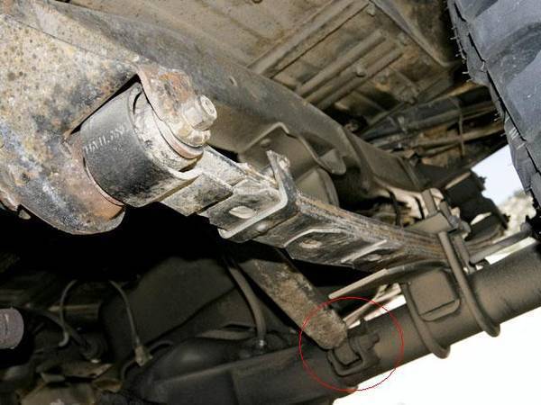

    Alright alright, got some nomenclature buggered up here and there and it's been 9 years since I was under the ass end of a Chevy. Ok. I just crawled under the Tacoma and see that the shocks mount to the leaf spring perch. Not the case on the 81 Chevrolet K5 Blazer. The spring perch was separate from where the shocks mounted to the axle see picture.

    I know what your talking about now. Moveing the shocks still have no impact on the U joints, though.

    You are not moving the shocks. You are moving where they attach to the rear axle. With the short wheelbase of the full size Blazers it did make a difference. Before the constant strain on the u joints would eat them up in regular driving. Now, cut off the existing mounting location rotate the whole rear axle assembly a few degrees and reattach the mounts.
    Just trust me on this. I have seen it work.
