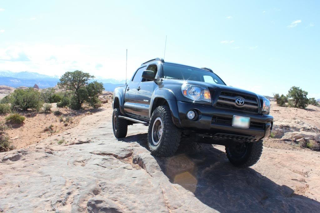

    I have that exact setup and have been down quite a few trails in Moab and Durango/Silverton/Ouray and have never rubbed.

    I should add that I had to buy LR UCA's too. Without them you will not have the correct caster and it will rub. I don't care what Toytec will tell you about not needing UCA's with their lift, you absolutely do. I was told that with both the Taco and FJ, and they both ended up needing them.

    No, I have 68k miles with this setup and have towed a trailer weighing 5,000lbs. It has never rubbed, not even once.
    If I were to do it over again, I would probably go with an Icon setup though.
