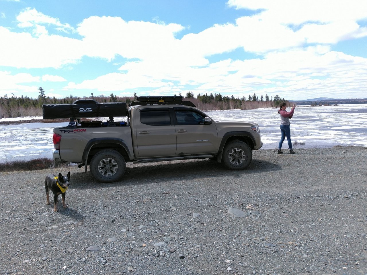

    We have one of the larger tents-a CVT Mt. Rainier- but on a short bed. Lots of people seem to go with the smaller models, though. Ours hangs over the tailgate a little, but we absolutely needed the space with me (6'3"), my wife (5'10") and at least 2 dogs. The Mt. Rainier is a "4+ person " model. The next size up has 2 ladders, ours just has the 1. How do you plan to mount the tent to the truck?IMG_20190508_115821.jpg

    Nice setup. It’s gonna be me, the wife, our lil man and our pooch so a small tent seems tight. You’d be surprised on how hard it’s been to find any pics of the larger tents on anything smaller than a tundra or those Jeep truck things. I’ll be mounting it on a 12” RCI rack.

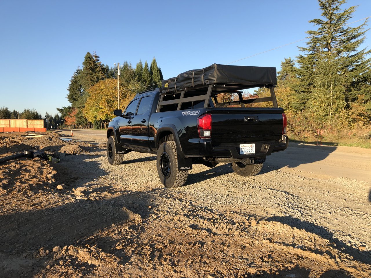

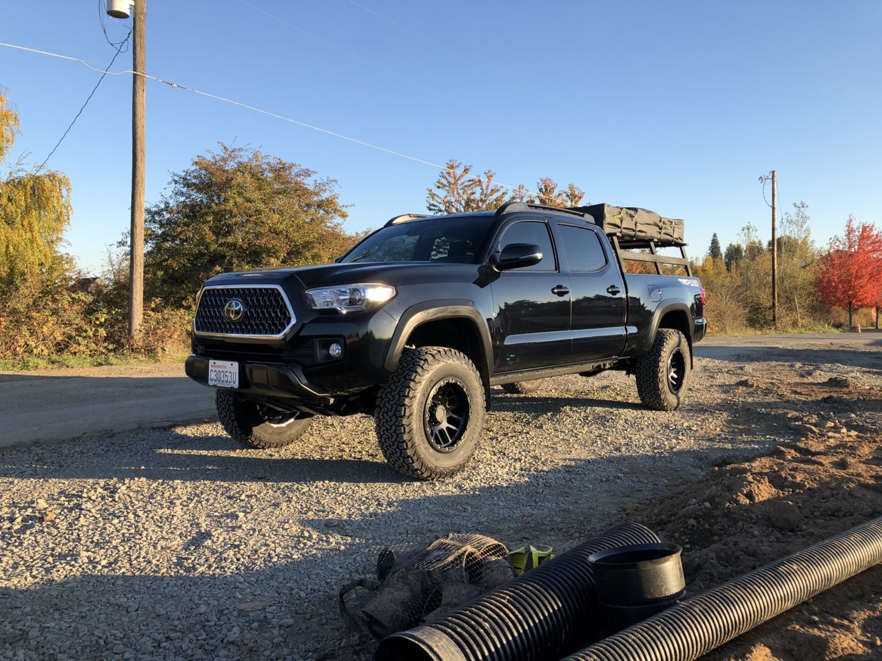

    751331E6-18AB-4A89-ADEC-3D2D5F0A7011.jpg 71FBB90C-50EF-4D34-8DF2-384B58ABF3F4.jpg
    Here’s a picture of my Smittybilt Overlander XL Gen 2 on my DCLB. I’d take a side picture but the rack and tent are both stored in the garage.
    It looks like the Overlander XL and Roam XL are pretty close to the same size when closed (72x48) so it should fit exactly like mine - flush with the back tailgate and enough room to remove the cover by the back window. My rack is also pretty much the same height as the RCI so this should give you an idea of how perfect the fit is.

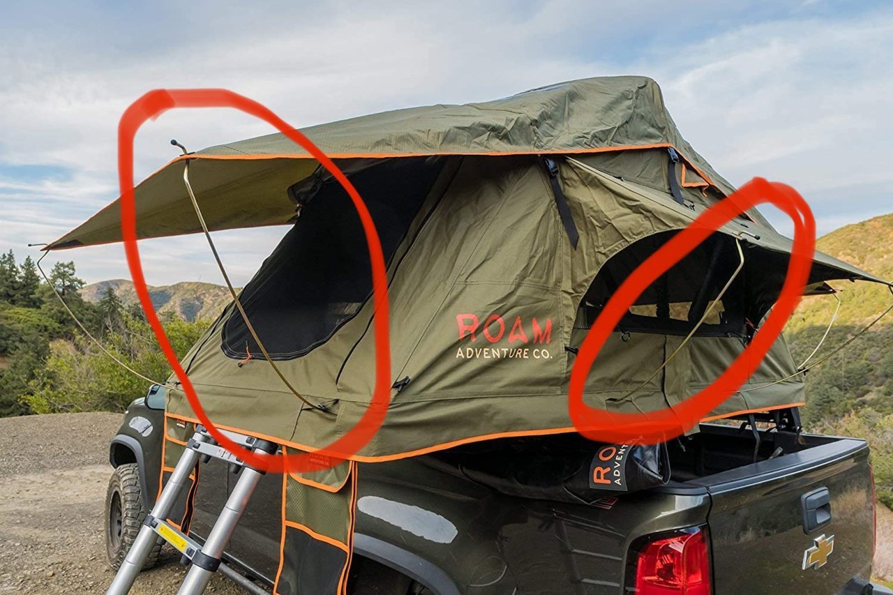

    Also, one issue you might have is with these metal window awning poles for the side of the tent that is mounted to the rack. They slot into the frame of the RTT and will probably interfere with the roof of the truck since the frame of the RTT sits below the roofline with the 12” tall rack.
    The side of the tent that folds out will have no clearance issues so you can use the awning poles provided. I simply used a bungee cable and hooked it to my roof rack in order to get tension on the opposite side awning.

    That looks real nice. I appreciate it, and these are the pics I was hoping to see. I just pulled the trigger on the Roam XL with their Black Friday sale.
