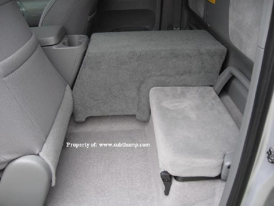

    Recently got a 2015 access cab and I’m looking for ideas for a rear storage solution WITH an integrated subwoofer. I’ve been a lot of ideas without a sub, but curious if anyone here has a subwoofer and can share some ideas. I don’t want to place a sub enclosure on top of the platform, I want it hidden and protected.
    I’d like to fit a full size 10” woofer (JL 10W6 or similar) that will require an enclosure about 10” tall at least. My original idea was to build a box that’s the same height as the rear seat support, and just put it on the ground behind the drivers seat and then put a platform on top of it (will be hard to fit a full size 10” non shallow mount sub though). My other idea is to get one of these enclosures that would fit a large 10” sub, and then put a platform on top, with usable storage underneath. However I’m wondering if the main platform above it will be annoying high to load heavy coolers etc. If you have any photos of your setup I’d love to see it.

    This is great to know, I’m looking at that enclosure and it seems perfect. It’s interesting though that the dimensions appear identical to the “Subthump” brand one in my photo, but the internal volume is almost .2 cubic ft smaller (.8 vs .96). Does yours allow you to adjust and recline both driver and passenger seats all the way back? Have any photos by chance of your setup with the top platform on when you had it?

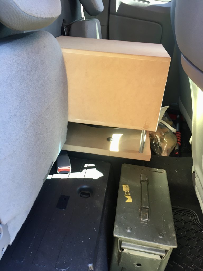

    Just started building this but it’s 1” furniture MDF made exactly to JL’s sealed box specs. Lot’s more to go but it’s what I’ve got for now.

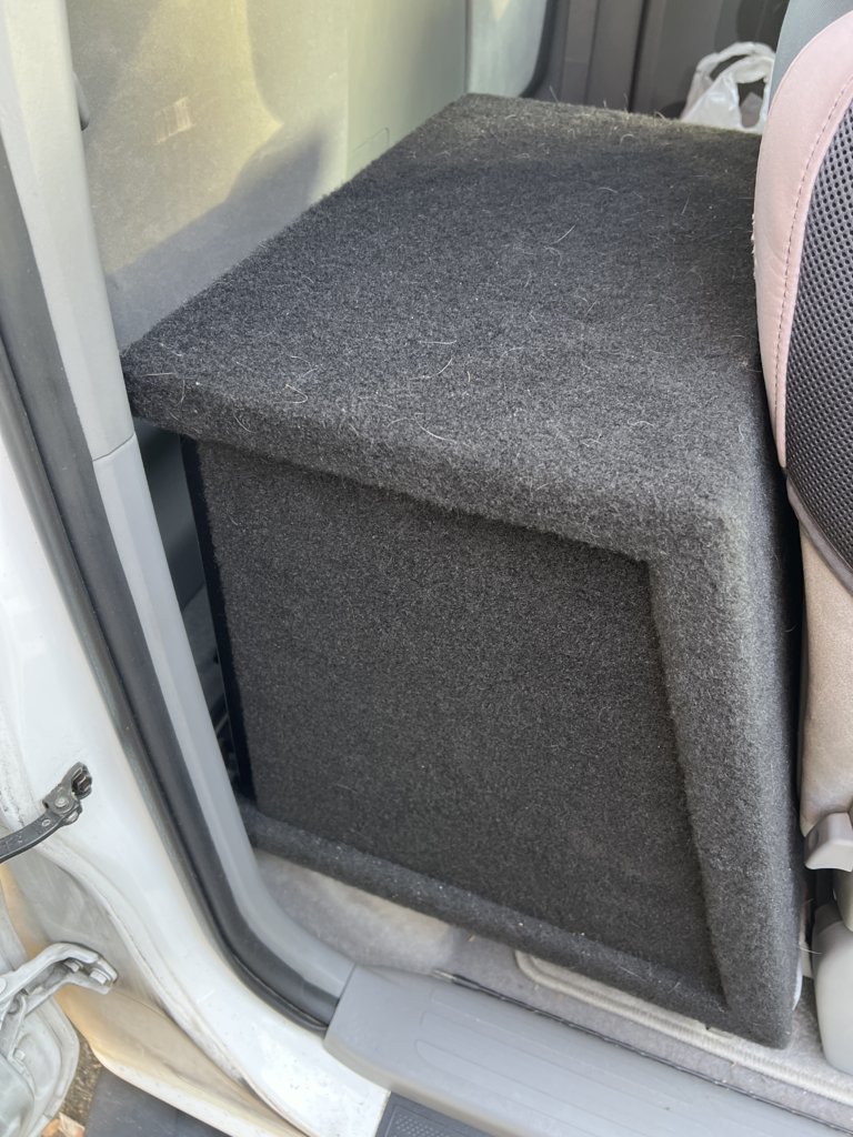

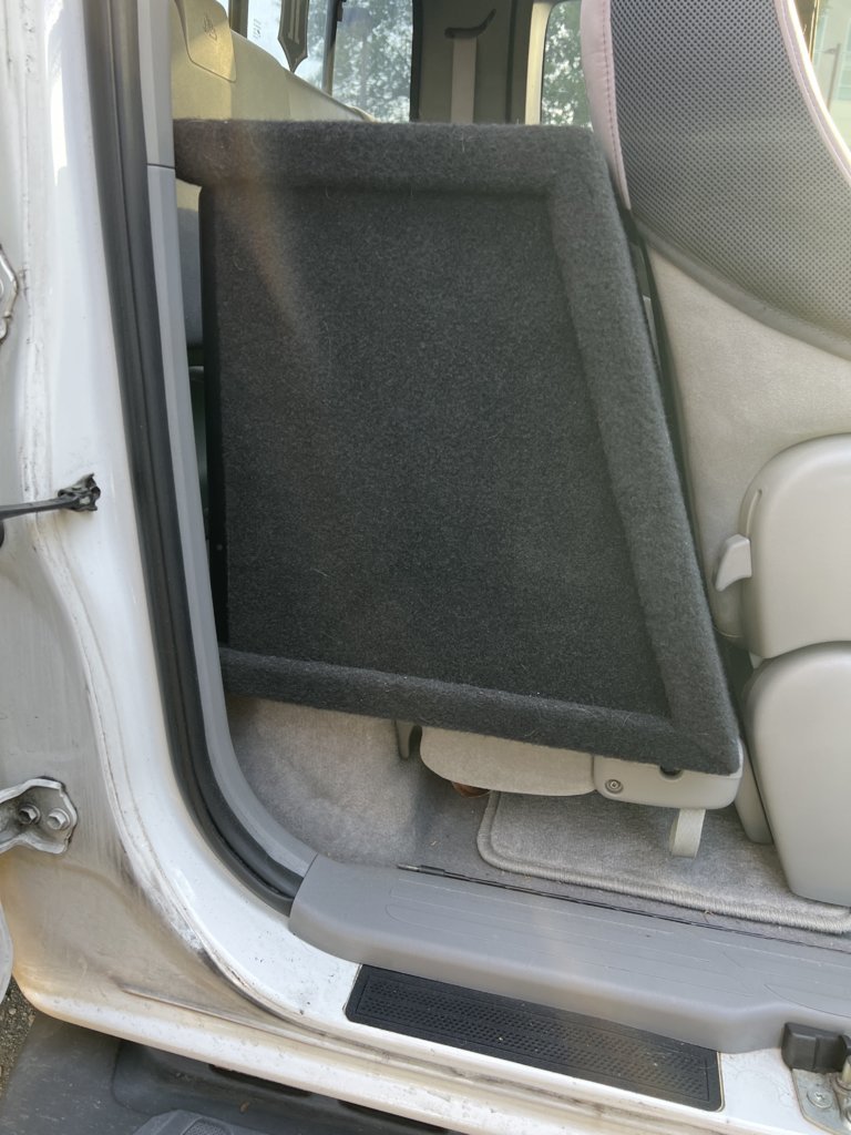

    Damn! I had that same sub years ago powered by a JL 1200/1, it’s an insane sub. I was thinking of getting a similar wedge and just putting it on the floor behind the passenger seat like you but I think I want to retain that area for storage, I can’t decide. Do you have a photo of yours? Curious to see it back there.

    the one negative about the enclosure is no, I cannot recline my seats all the way back. Not really an issue for me as im only 5’10”, but that could be an issue for others.

    The back wall and the sliding window get the brunt of it; lol. Pretty much shakes the entire cab.
    The enclosure is 103lbs so it doesn't move or vibrate that much.

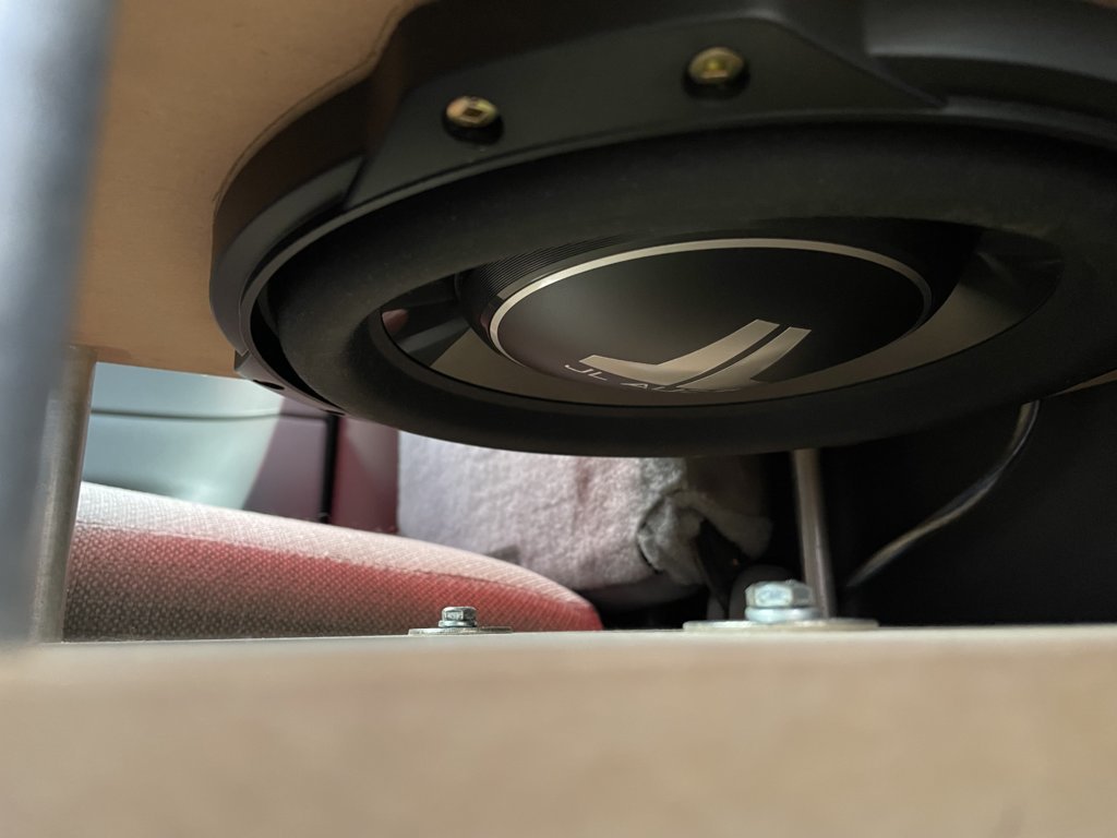

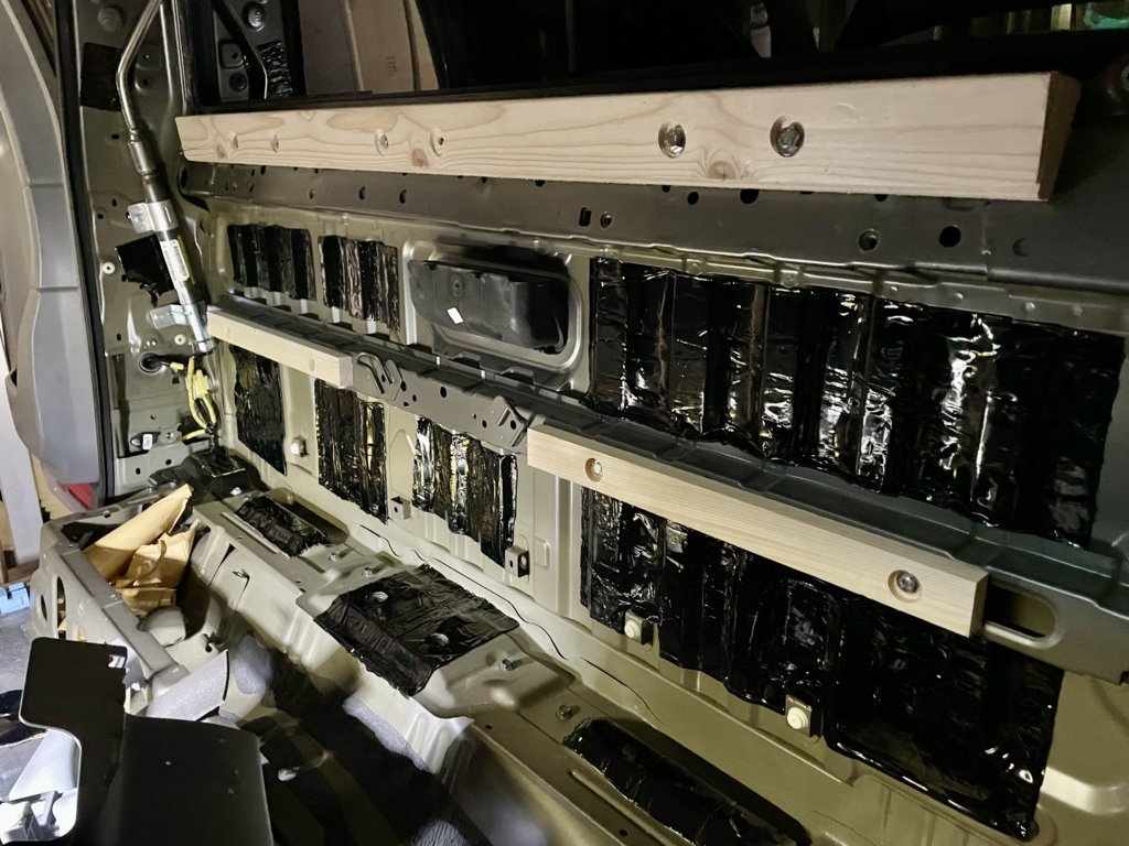

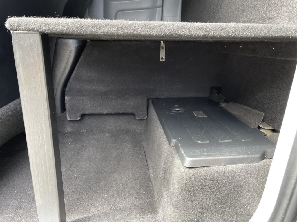

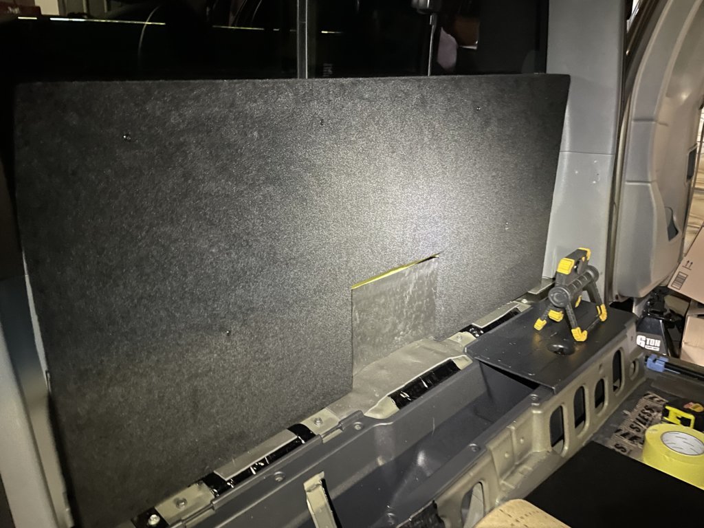

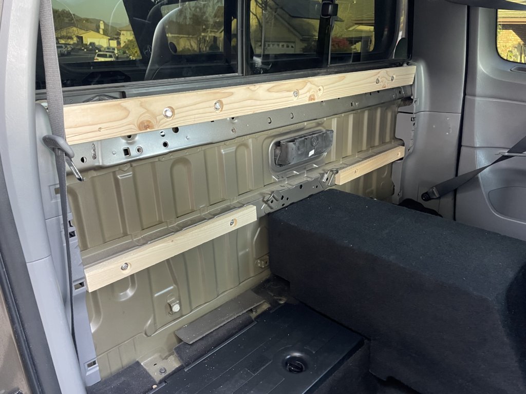

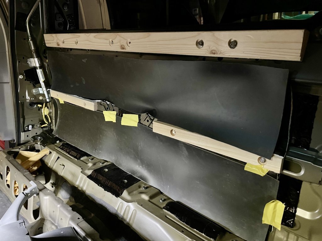

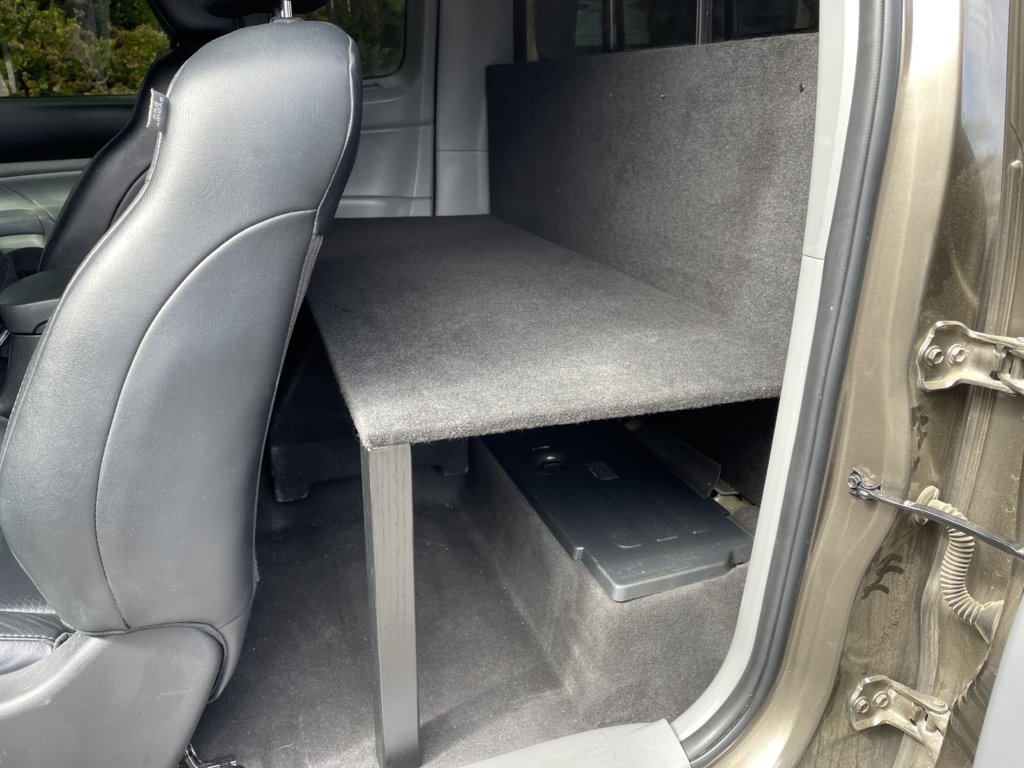

    Incase anyone else is looking for ideas for an integrated subwoofer/storage system, I ended up going with the idea talked about here. I have a JL 10w6 in this and it sounds great and you can’t even see the sub unless you’re bending down. The rear cabin wall panel is built around the sub, and the back wall is treated with CLD, 3M thinsulate (over the cabin vents and also for decoupling), mass loaded vinyl, and then the rear plywood has CCF adhered directly to the back. I used 1x2s mounted to the factory threaded openings to get the back wall sitting straight, and also to make mounting the plywood much easier.
    Definitely lost a bit of space having the sub, but the extra layer of storage more than makes up for it.
