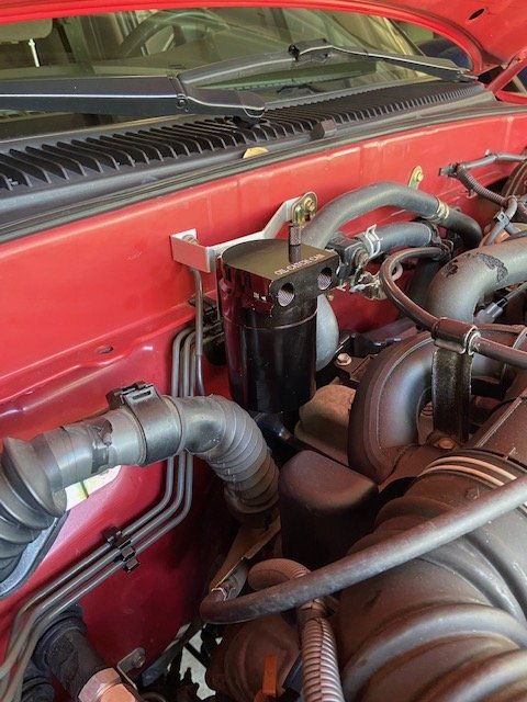

    Curious where and how you mounted it, how you routed hoses and hose sizes.

    Thanks! That’s the idea I needed and the exact catch can I have minus the bracket. I have some 1” aluminum bar stock left over from my AT cooler project so I’ll fab up something tomorrow.

    I have the same can, I just flipped the bracket on the can itself upside down. That took a bit of filing to get it to sit right. Then I just hung it off of the bolt for that ground wire on the firewall right above the can in THatt’s picture.

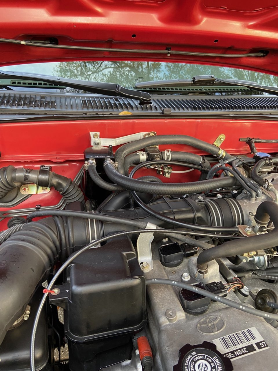

    First pass. I need to drop it down an inch but I ran out of stock so a trip to ACE is in my future. The inlet side hose will be 3/8” ID but the outlet size has to be 1/2 or 5/16” to accommodate the nipple on the manifold. That’s a trip to Discount Auto which as luck would have it, is between here and ACE.

    Looks good. Just be sure you can unscrew and drop the can to empty it without a bunch of hassle.

    Done. Not sure I’m happy with the placement and how the hoses run but it will do for now.

    I love what you did....but think most of the carbon build up is from the egr love.....
    the oil just tops it......making terrazzo.....
    you'd think the oil would wash the carbon away.......but no carbon is a bitch......

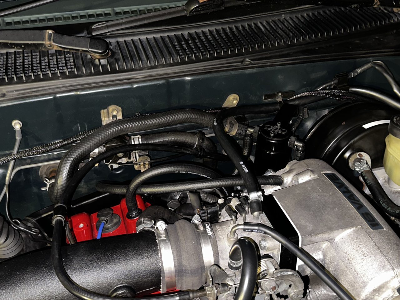

    5 PSI supercharger 3" lift Bilstein 5100 shocks Old Man Emu springs General Spring leaf springs with 2" blocks and extended shackles 31" Firestone Destination XT tires LCE header and catback exhaust HPS CAI Tundra S13WE front brakes KC HiLites flood, ditch, fog, and backup lights Eaton Bussmann relay/fuse panel with custom power tray All Pro bumpers, sliders, and skid plates

    What intake fittings are you guys using? The hose for the PCV is like 5/8 ID.
    And could you plum in the CCV that is towards cylinder 1?
