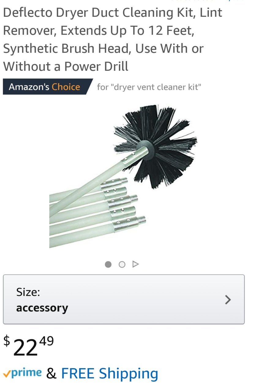

    I had the exact same problem. My vent is about 16ft long. Thought I had enough airflow until I ran a snake cleaning brush through it. Filled up a 5 gallon bucket with shit. Cut my drying time in half.
