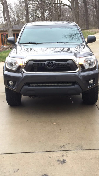

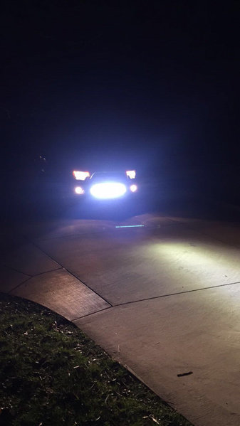

    I just put this light bar on the bumper 2014 OR. So far I love it. It is plenty bright and it wired up easy. The only issue is it whistles when I'm going about 65 on the freeway with a cross breeze. But other than that, no I have no complaints.

    I have the 150w light.

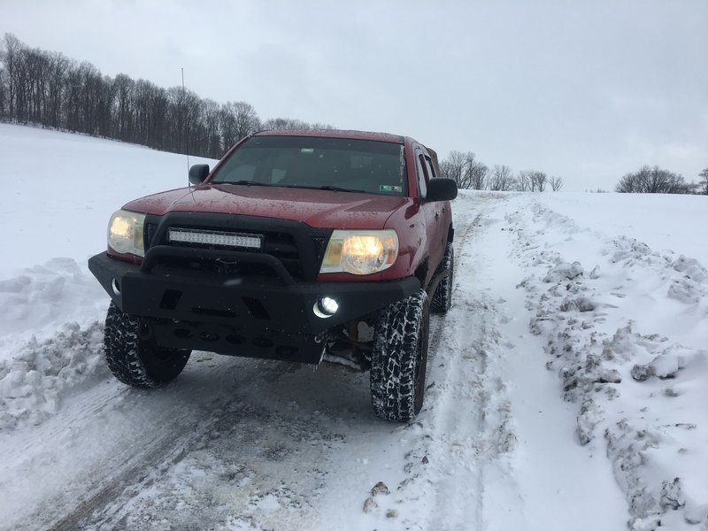

    I have one $20 for a 20". I've had it about a month so far. Had it though a blizzard, a few car washes, some mud, and a lot of cold weather. Still works no issues.

    What brackets/mounts did you use to get the stealth look behind the bumper?

    I used the mounte that came with the light. The 31" bar with the brackets is the perfect length to bolt into the aluminum blocks that hold the front bumper. I used 4 1/2 inch screws and dropped them them through the hole in the blocks and secured them with a nut and some locktite. No drilling required and no modifications to the truck required. Here are a couple images of the block I'm talking about and where I mounted the light bar.
    The photos are stolen from brandonbryan12's post on 05-11 front bumper removal. I can post some of my own images later this evening.
    These are the two blocks I'm talking about.
    This is the hole where I placed my 4 1/2 inch bolts.
