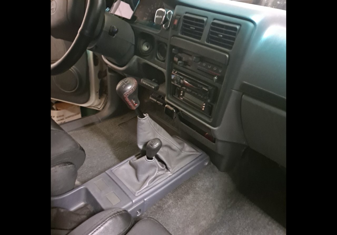

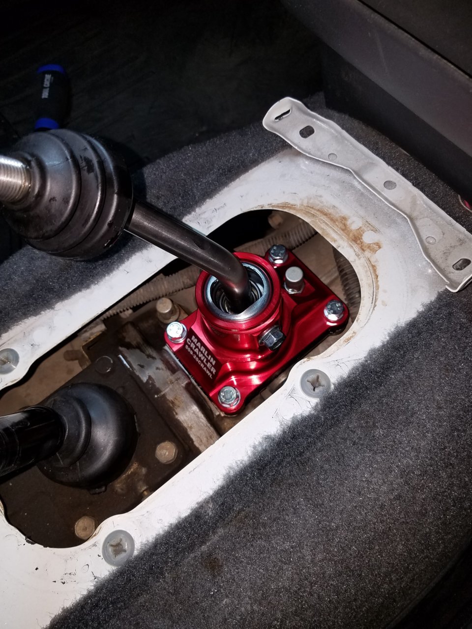

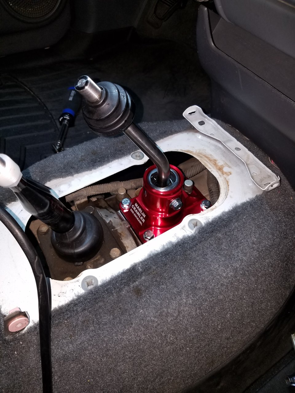

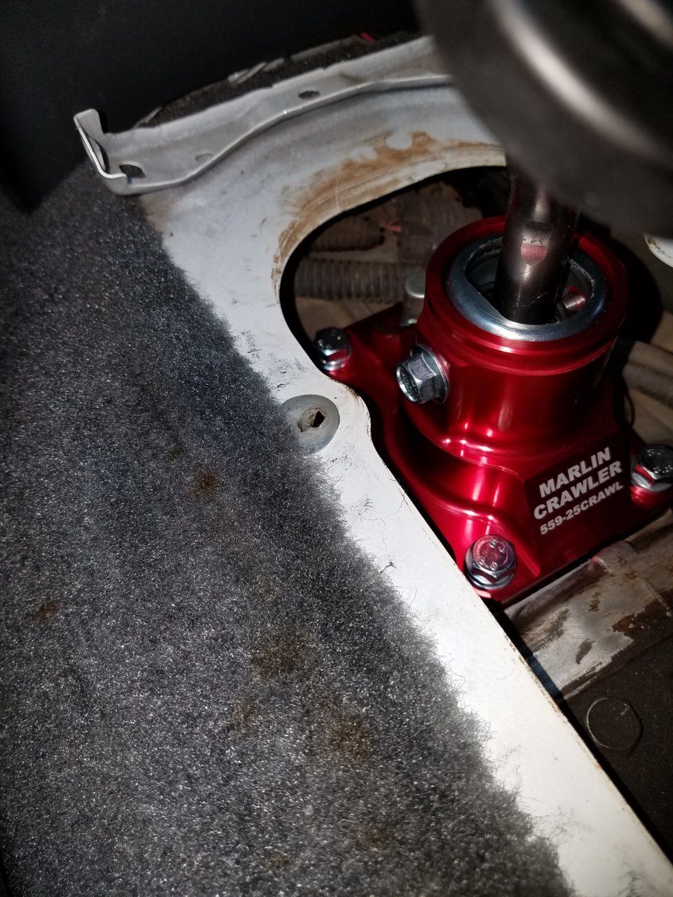

    I got one for my '96 Tacoma, I've had it in for a couple of years now. There is a slight learning curve to the shorter throw and the clutch but it goes by quick. I makes a little more noise since the stock shifter stick has rubber inside to help dampen the transmission noise. Over all I am glad I did it. I had the LCE short shifter kit in for about a month and switched to this one. I should have done this one to begin with.
    20180412_191627.jpg 20180412_191641.jpg 20180412_191651.jpg 20180412_191708.jpg

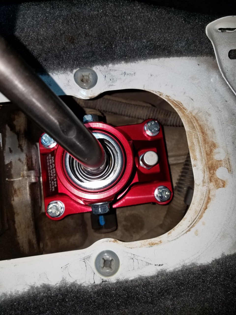

    I've had one for a few years and I really like it! The kit has a shorter throw, but the shift lever they provide is longer than stock so it's not hard to reach.
    I had a helluva time trying to get their lock ring installed so I ended up reusing the stock one.

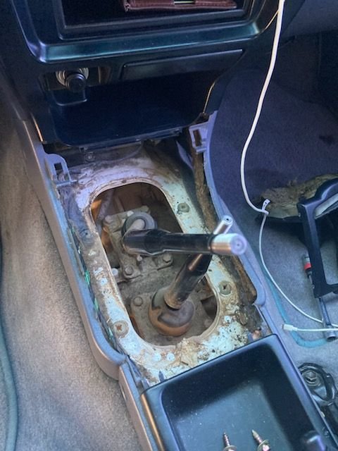

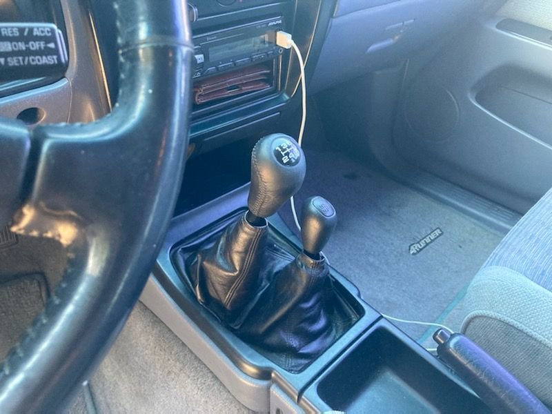

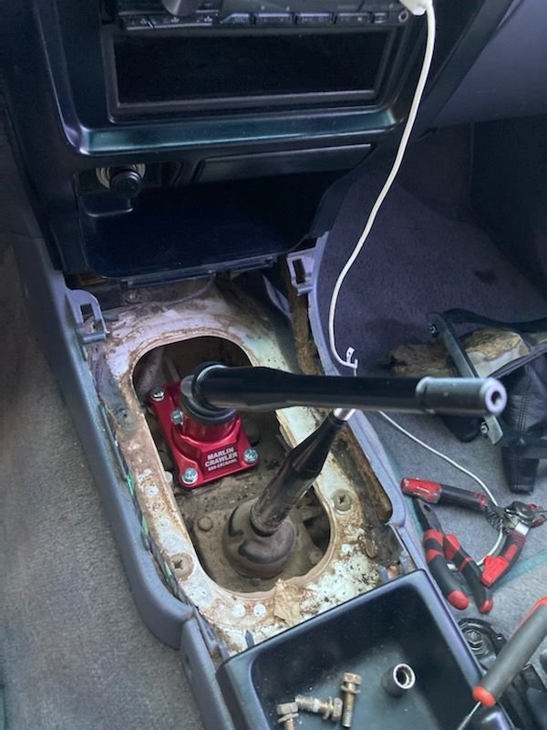

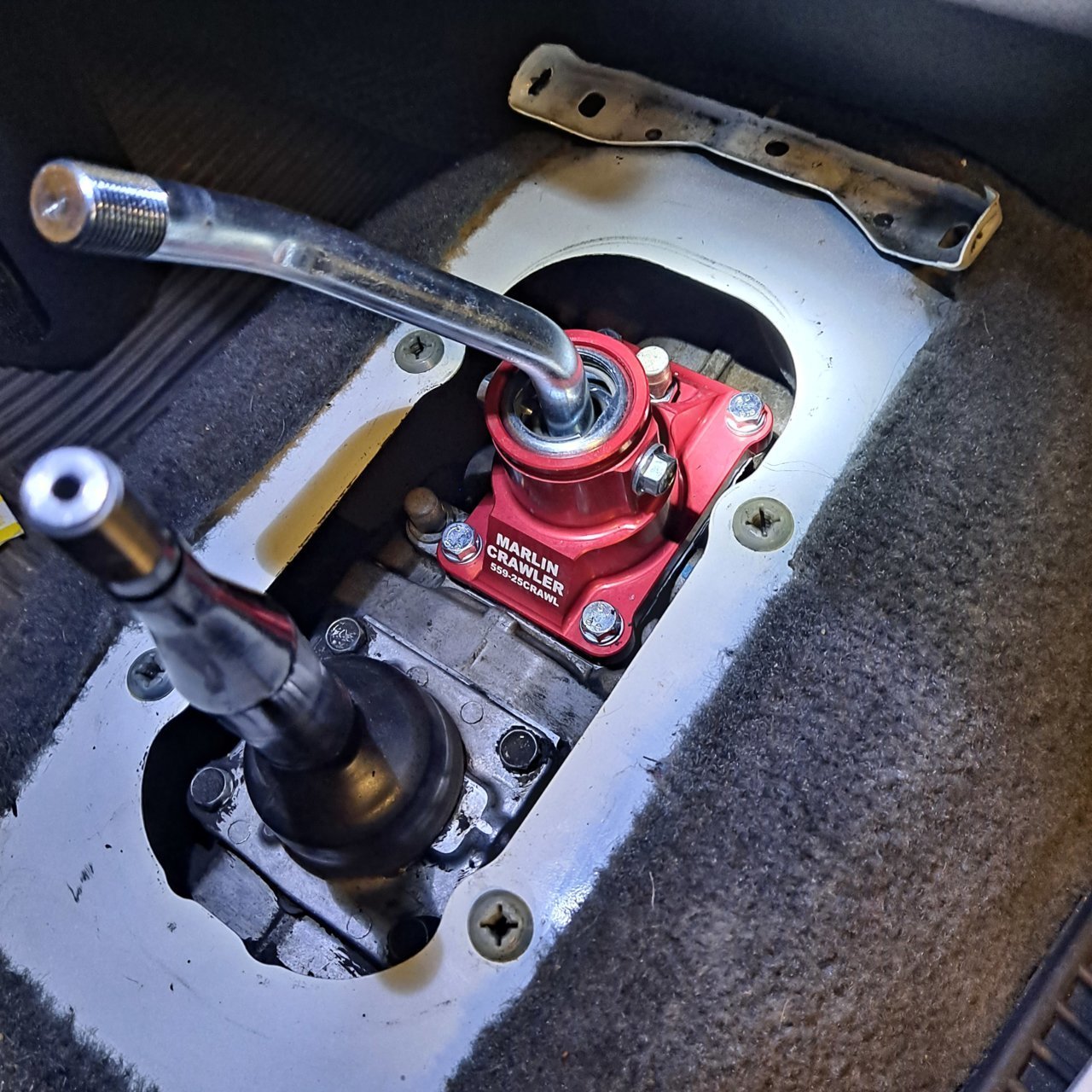

    Got mine installed on Friday night!
    kKrB0a_e34a57f2f6810c90c01edc38c05fabd1138f7992.jpg 51pxkM_2824f1e9add22061feb77bb26effa9da719485e8.jpg BBO8U8_323f6b794a624df426d37bf4f2f396c8022316fd.jpg
    I have to say, I love the way it shifts now! Super clicky and decisive and the new socket and seat definitely makes a difference. Only con for me is I absolutely hate how tall the shifter is now - it probably sits about an 1.5" over where it did before. I'm thinking of having the shifter machined down a bit to match stock height again.
    All in all, easy upgrade and did improve the drivability of my 4Runner!
