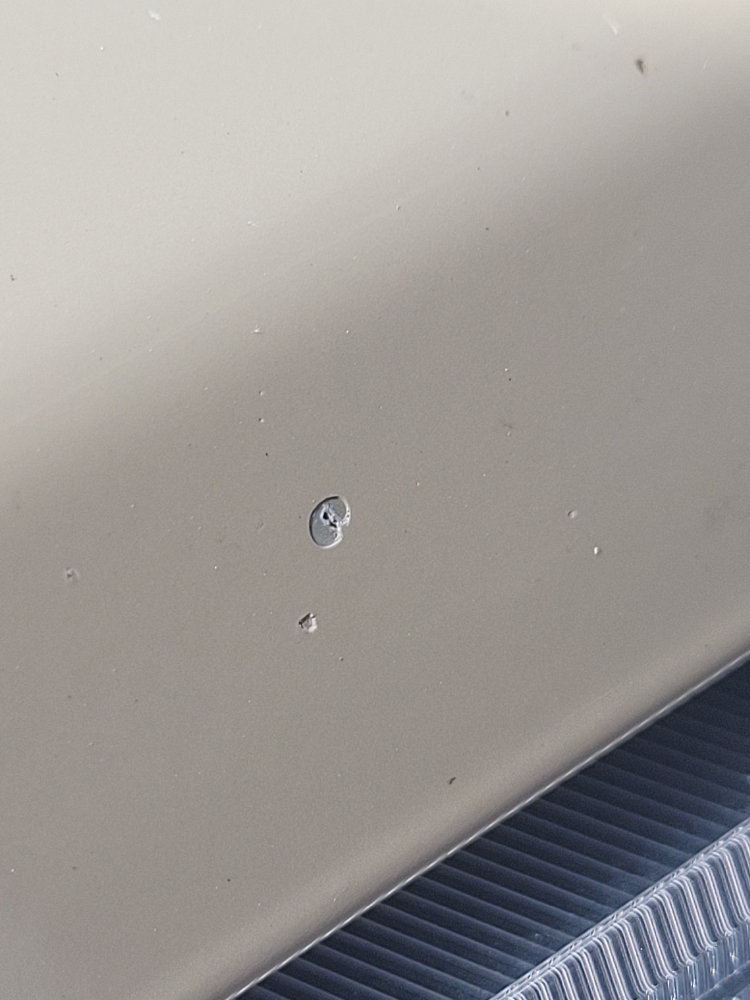

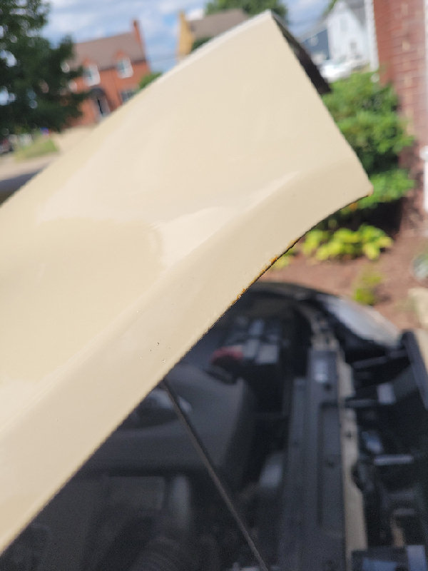

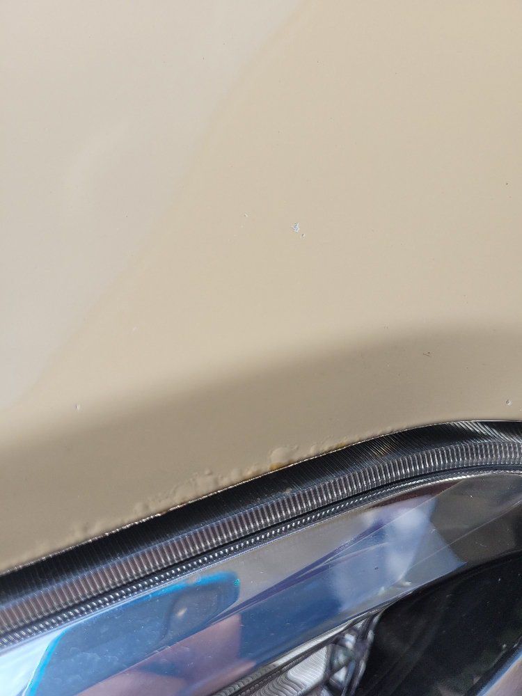

    I honestly see zero evidence to show that it has been touched at all. I just went out to get better pics on my lunch break. Each rock chip is clearly not painted over, as you can see a grey-ish in the middle and the edges all have almost a white around it. Hopefully these are a little better. Unfortunately both yesterday and today the pics are in direct sunlight, next to a white house, so that isn't helping lol.

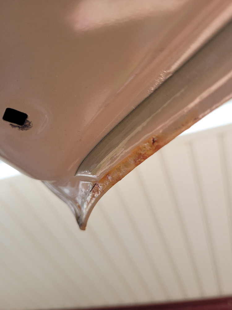

    Still waiting on dealer to call me back but I did log into my Toyota account and it noted that the trucks come with - Rust-Through Coverage
    60 months/unlimited miles (corrosion perforation of sheet metal). So hopefully they can act on that. Not sure the ins and outs of that but just something I saw.

    Proper repair of that (cutting out all rust, fresh metal, limited filler) would be expensive on an edge like that.
    If they are going to work your warranty (as they should), I see a new hood in your future.
    Once that's settled, if you long for a skewp, ask about paying the delta........ lemonade and all that.

    I can't imagine toyota NOT fixing that. HOWEVER, the coverage is "rust-through" and "perforation" which that is not and I was told by my salesman they specifically look for those 2 things.
    Looks like something corrosive got into the hood compartment and lingered there. In my opinion there's no way that's a defect, previous owner got some chemical on/inside the hood.

    I just posted about this in another post about rust prevention. Mine is on the driver's side. No, it's not repainted. No, it's not from chips. When I saw it I sprayed a lot PB Surface Shield through the holes close to the spot and when I lifted up the hood higher, about 1/2 a cup of water ran out which was displaced by the Surface Shield, so water is sitting up in that area and rusting from the inside. I'm fairly sure Toyota won't cover it as it's not "perforation" as stated above.

    Mine was most definitely a water issue. Borescoped and saw the rust in there after I saw the brown water drip out.

    is there a clogged drain hole? Should there be an additional drain hole? Gosh, seems like a dummy design issue
