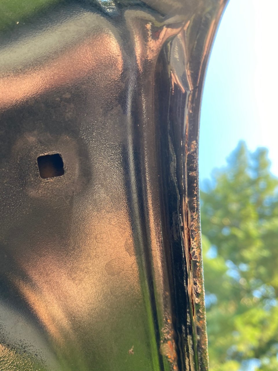

    I didn't notice mine rusting through until I took a close up picture of the underside of the hood, where the seem is. If yours is bubbling on the edge or the outside, I guarantee you it's rusting on that seem. My truck is black and was hard to see until the pictures.

    Toyota is well aware of this issue. I do most of my maintenance and I sprayed surface shield in the seams where I could reach when I got the truck right after my first reply to this message. Anyway I got a couple letters from the dealer to bring it in for the one year free maintenance so I did even though I didn't have a single issue. They changed my oil and filter with just 4500 miles on it.
    When I got home I opened the hood to make sure the oil cap was secure etc new globs of rust inhibitants ran out of the seams. Thank you Toyota!
    Paint bubbles in this area is rust starting from the inside and should be addressed by a Toyota dealer if still under warranty.

    Well after talking to Toyota, they sent me back to the first dealer. They took pictures and submitted it to Toyota and it was denied. They said it started rusting due to the paint chip. Which is not true at all. The paint chip happened after I touched it and the paint fell off.
    My next step is to call Toyota back and appeal it. I am going to request and appointment with a body shop of some sort and hopefully they can prove it is not anything I did.

    Bummer. But that is exactly how mine looked too. A close look you can tell that it started rusting from moisture that was inside the seam of the hood. Hopefully you can get some sort of help. Maybe even ask for a discount on a new hood. Better than nothing. Good luck.
