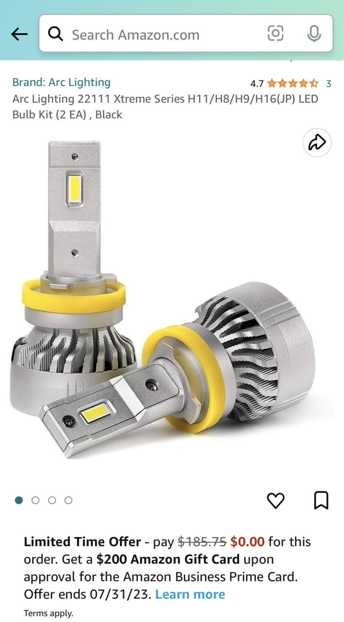

    Can anyone tell me if these led bulbs are with the money?

    Most led bulbs look cool from outside the truck but have reduced lighting compared to stock.

    Definitely pass on those, they will be garbage with no focus. They are very thick. Any LED focused on being the highest output will be trash. Higher output will require more mass for thermal management, resulting in thicker designs, which cause loss of focus which then reduces output intensity.
    You want the thinnest design possible, so that the output is more focused, which then increases output intensity. Morimoto 2 stroke 3.0 are the most focused on the market and the best PnP replacement LED on the market. However they are easily beat by performance halogen bulbs, or a $9 Philips H9 swap. Halogens in halogen assemblies easily outperform LEDs in assemblies designed for halogen bulbs. It is not currently possible for an LED to accurately mimic a halogen (regardless of what the marketing will try and tell you), meaning LEDs in halogen housings will always be a compromise and unable to perform to the levels of performance halogens that the assembly optics were designed for.
