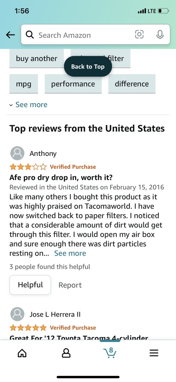

    I’m wanting to pull the trigger on an afe drop in dry filter for my truck (specifically, 31-10123). A negative Amazon review kind of turned me off.
    Anyone share a similar experience? Or should I stick with the stock paper filter? Thanks for the input
