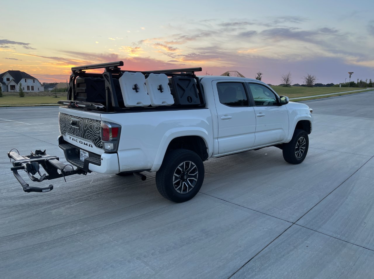

    I don't think it's dangerous to operation of the vehicle, but there will be a time when you forget and back it into a poll.
    The wise course to balance the vehicle would be to get cab height rack and send it forward over the cab by 12" or 18".
    Tacoma DCSB's force you to load items with CoG behind the rear axle, do your best to limit doing that.
    Also those bed bar uprights look weak especially for how far the tent overhangs the rear bed bar, like the rear bed bar is in the middle of the tent, no bueno

    Aside from the obvious issues with the tent sticking that far past the back of the truck, I'm also worried about properly supporting the tent.
    It looks like at least 3 feet of the tent towards the back are completely unsupported. Tents are very structural sound.
    You need a rack that covers the length of your bed, and it needs to be about 22" tall so you can get the tent over the cab. You need to center the tent on the rack.

    I would get a cab rack, or a full size bed rack, or canopy..... Definitely something different

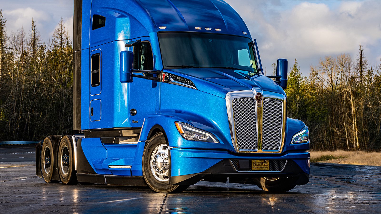

    ok, i've got to ask.
    how many vehicles have a passenger compartment that is within 2' of their front bumpers?
    i could rear end that in my gmc savana work van and still be fine...

    perfect example.
    the older semi's have close to 6-8' worth of front end
    the newer trucks are probably closer to 4-5'
    https://pbs.twimg.com/media/Et-74oQVkAI6h1H.jpg:large
    the only truck style that honestly has an issue is the old flat-fronts, which few are still running, and have a number of their own driver safety concerns
    my point is, a 2' additional overhang of a fabric/fiberglass/composite assembly is really not a problem with the majority of vehicles on the road.
    but to further drive the point, because i've got the time, crumple zones are also drastically different. semi's don't crumple much at all when hitting a passenger vehicle.
    this video is a perfect example. it knocks the steer axle out of the semi, but the frame rails are obviously still very much intact. the stopped pickup maybe intruded 3' of that 6-8' front end at a 0mph vs. 55+mph collision.
    https://www.youtube.com/watch?v=ifcmyjnZxpQ
    an overhanging tent setup just means the semi truck gets a punctured radiator. of which is still going to be the least of his problems once the state troopers come around for the investigation.
