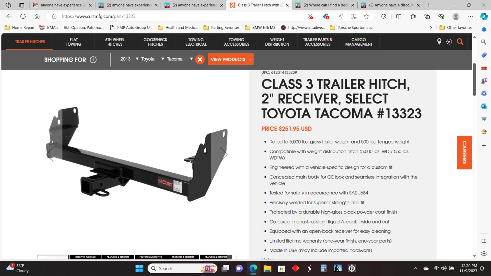

    why then do all the descriptions for Reese/Curt etc. say 5000 lbs/500 tongue?

    Change the vehicle to a Tundra and you will see a class 3 ratings go up in capacity. You will also see Curt does not show a class 4 for a Tacoma, but for a Tundra they show class 3 and 5 available. Curt is taking into consideration the vehicles capacity. Or at least their opinion of a safe capacity. If it was me I would chose a larger truck. But if I was to do it with a Tacoma I would make sure I could do it with a flat hitch/ball mount (no drop or rise) and a very high quality ball.
