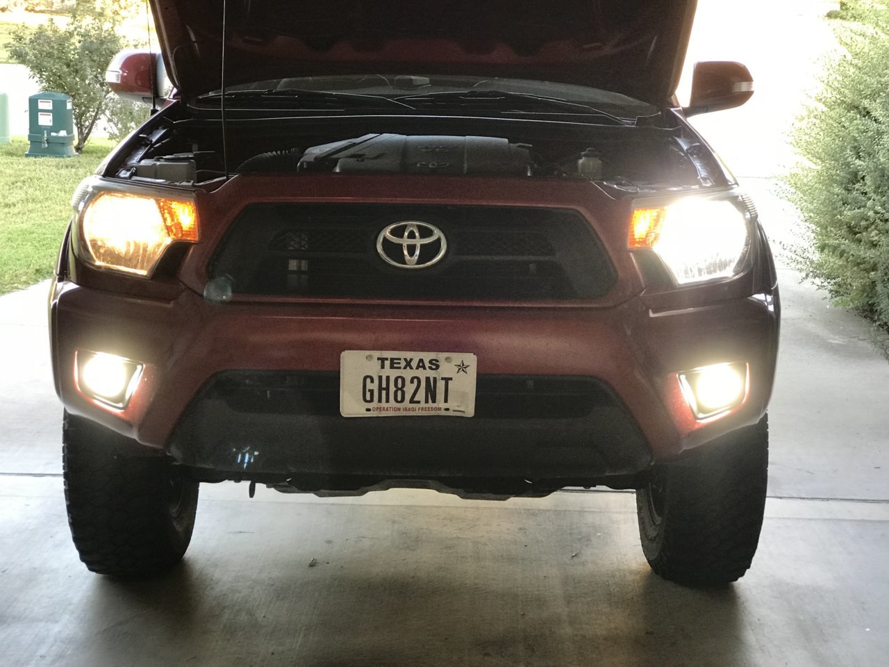

    Your truck is a 12 so it’s the on the factory light switch. Here’s a side stock psssenger side to harness w/ osram bulbs driver side

    No had Piaa bulbs 75w installed then w/factory harness didn’t last long they burned out.
