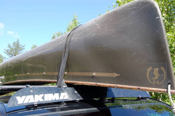

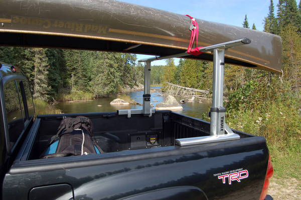

    I use a combo of a Yakima on the cab, and a Thule X-Sporter for the bed on my DCSB. I been carrying canoes and Kayaks on it pain-free for many years. If you have an access cab, the X-Sporter or a Trac-Rac will set you up nicely.

    none. They are made from aluminum. Just read your OP again. If you are planning to haul lumber of any volume, you should look at a Trac Rac. It has a significantly higher volume capacity than the Thule X-sporter. The Thule is really designed for Kayaks and Bikes.

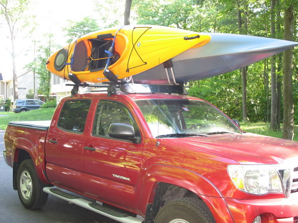

    I had a thule rack on my 2006 DC for over 4 yrs & only took it off to sell the truck.
    It was 400XT towers, 2160 fit kit, 58" LB, & a fairing.
    My only suggestion is to get the fairing, no noise but it probably effected my mpg.
    Used the J hulls for I could carry another kayak shoved between the attachments. This setup in the pic carried my 12' kayaks many miles around New England on the interstate, etc. Did not marred the finish, rub or hurt the door seals whatsoever. It was used for ladders, wood, lots of projects besides the boats.
    pic
