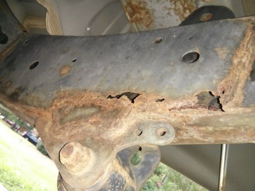

    Anyone have a copy of the letters? I remember when my wife got the letter for her '01 they told her it only applied to northern vehicles. She told them how the truck was purchased I NY but we are in NC now. If I recall, a few months later we got another letter or maybe it was during a dealer trip they looked at it and said it was OK ..... Just like few weeks ago with the spare tire holder.
    Anyhow, this past weekend after I fixed the clutch I was greasing all the joints and I noticed that the frame on the rear passenger side is in rough shape. There are a bunch of pencil size holes and the metal is very thin. I think I could easily remove 40-60% of the metal with my fingers from the inside and bottom of the frame near the welds for the front mount of pass. side leaf spring. I think it is safe to drive, but I doubt it could handle any off road pounding.

    So it didn't look like my truck? LOL

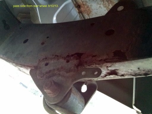

    Pretty close, rust holes are contained just to that area of the frame:
    Fortunately moving from NY to NC has reduced the speed of corrosion due to the rare freezing and rare use of salt on our roads.
    Still, I would like to sandblast the underneath of the truck, weld in some reinforcement and apply some Permatex Extend (brush on) Rust Treatment. That stuff works incredibly well. My concern is that if I do that and then they issue a recall for the truck based on the TSB I'll be out of luck.
