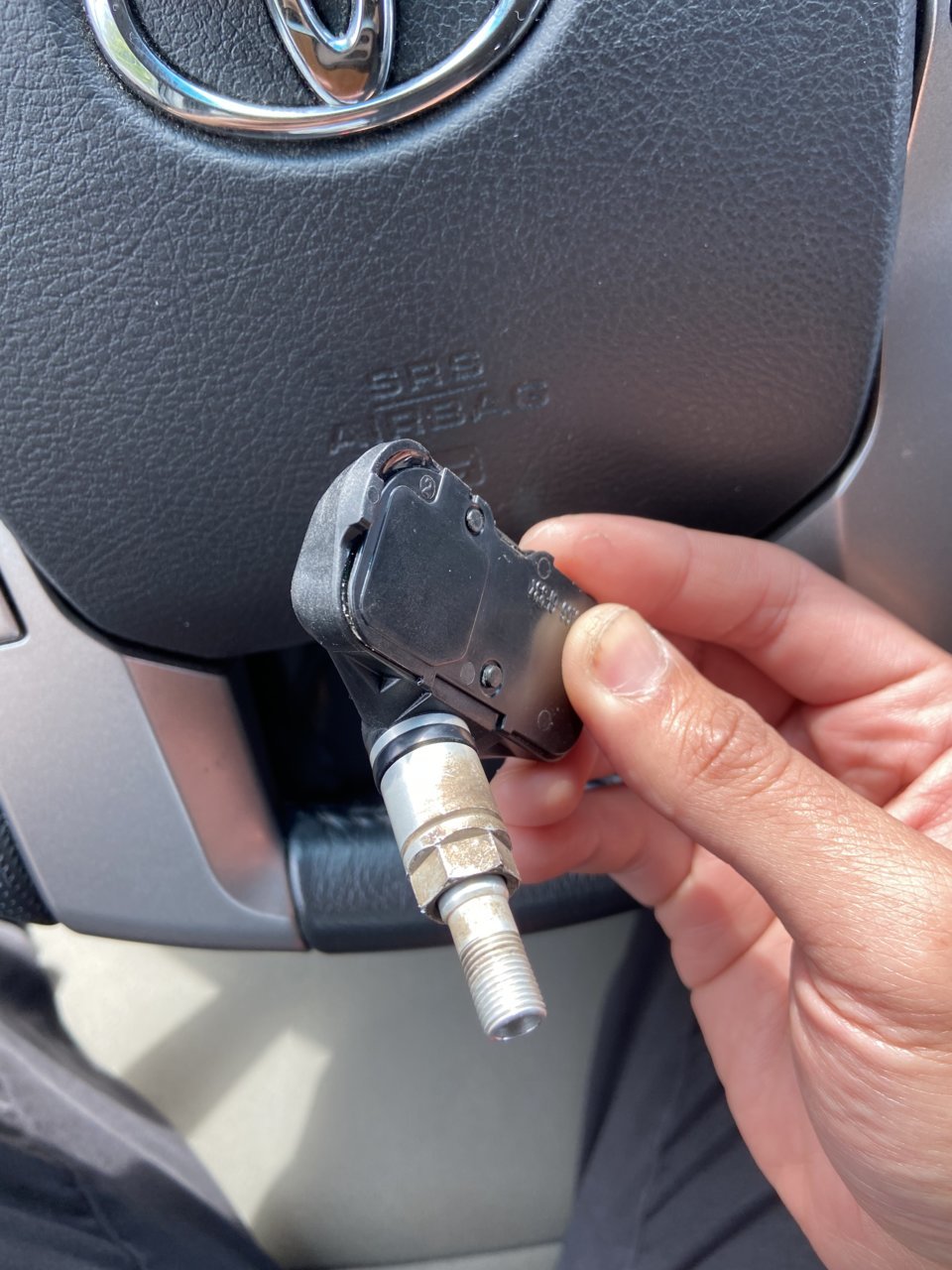

    So I asked the guy if he could do this on my F5 SCS wheels he said he couldn’t unscrew them before dismounting them because my oem sensors were all one piece. Is that BS?upload_2021-9-8_13-19-59.jpg
