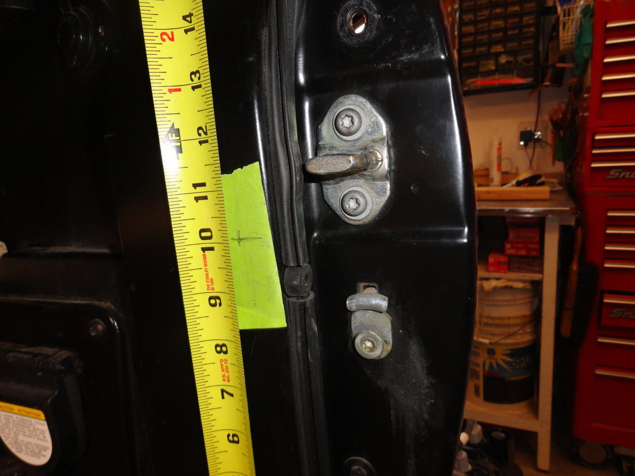

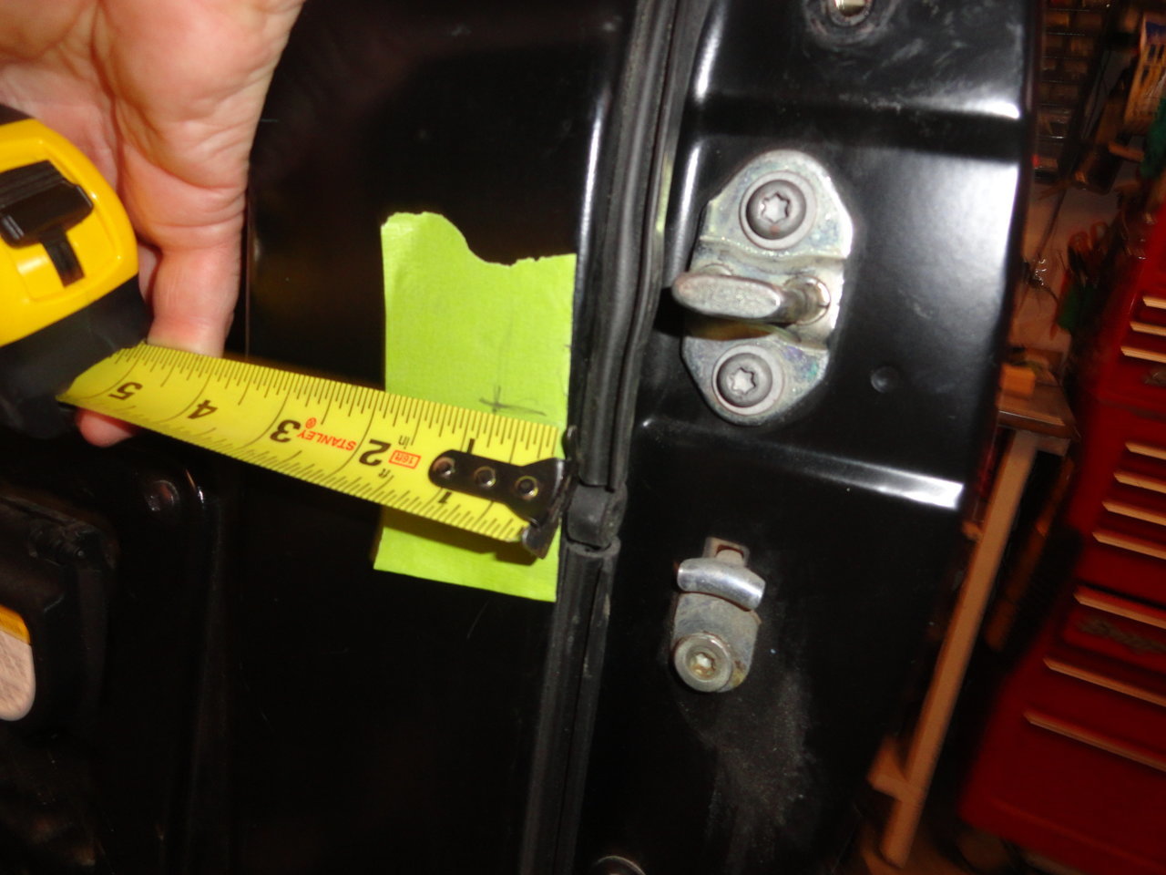

    You have to drill the holes. I put a fender washer on the outside (visible in the picture) and another washer and nut on the backside. The OEM mount is also only in sheet metal so no different.

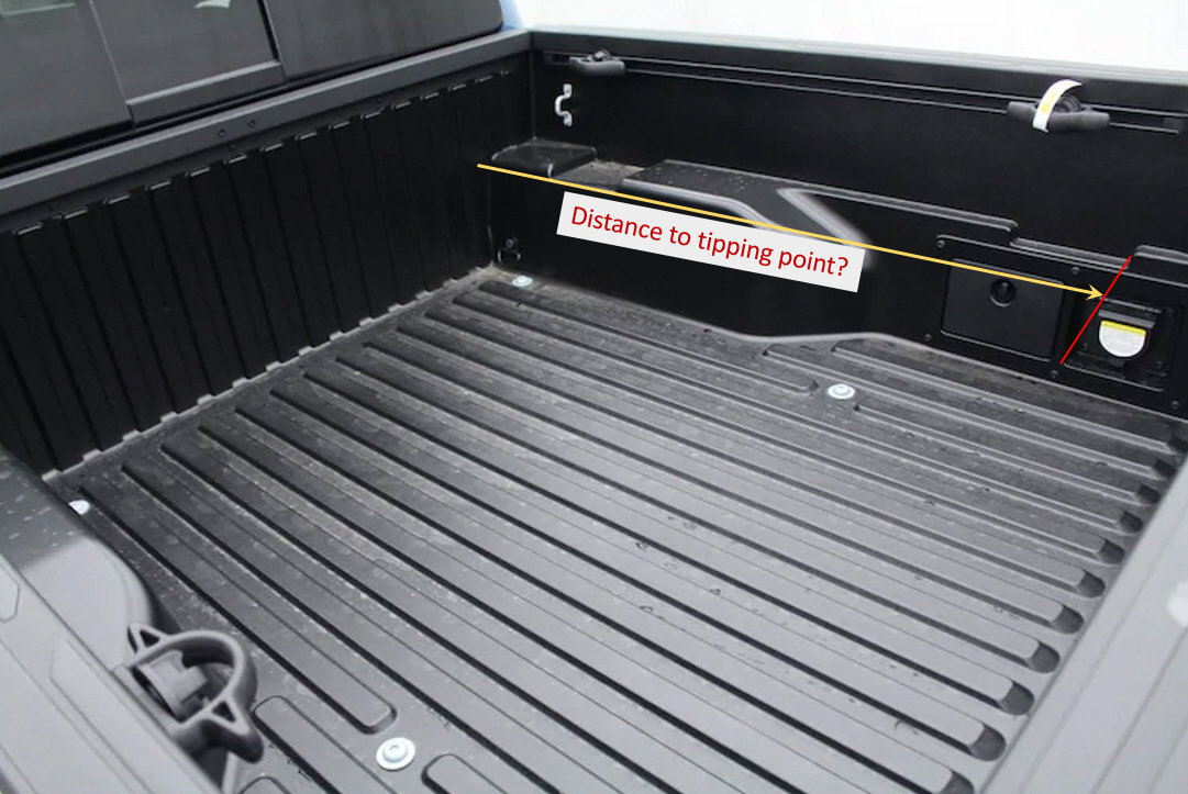

    I'm the OP. I appreciate the replies and pics. In the photo below, what's the distance from the bed wall to the edge of the far cross brace? It looks like it's close to 4' since the bed is 5' but it must be slightly longer that 4', otherwise 8" sheet goods would tip. But I suppose that means you want to limit to 8' unless you add another brace or the hitch gizmo that some have shown.
    BTW, on those hitch-mount braces, are those lockable (in other words, could someone easily steal it while you were in home depot buying 10' sheet goods)?

    You could get locking pins, but I just leave it in the bed (under the tonneau) until I come out of the store.
    Here is the extender I use, purchased with a 20 or 25% off coupon.

    Just wanted to note that the position on the holes will depend on the thickness of the boards that you use in the bed notches. I used 5/4 Pine (1" actual thickness).
    I supported the tailgate at the correct height, marked the holes and then moved the marks up slightly to allow for a little sag.
