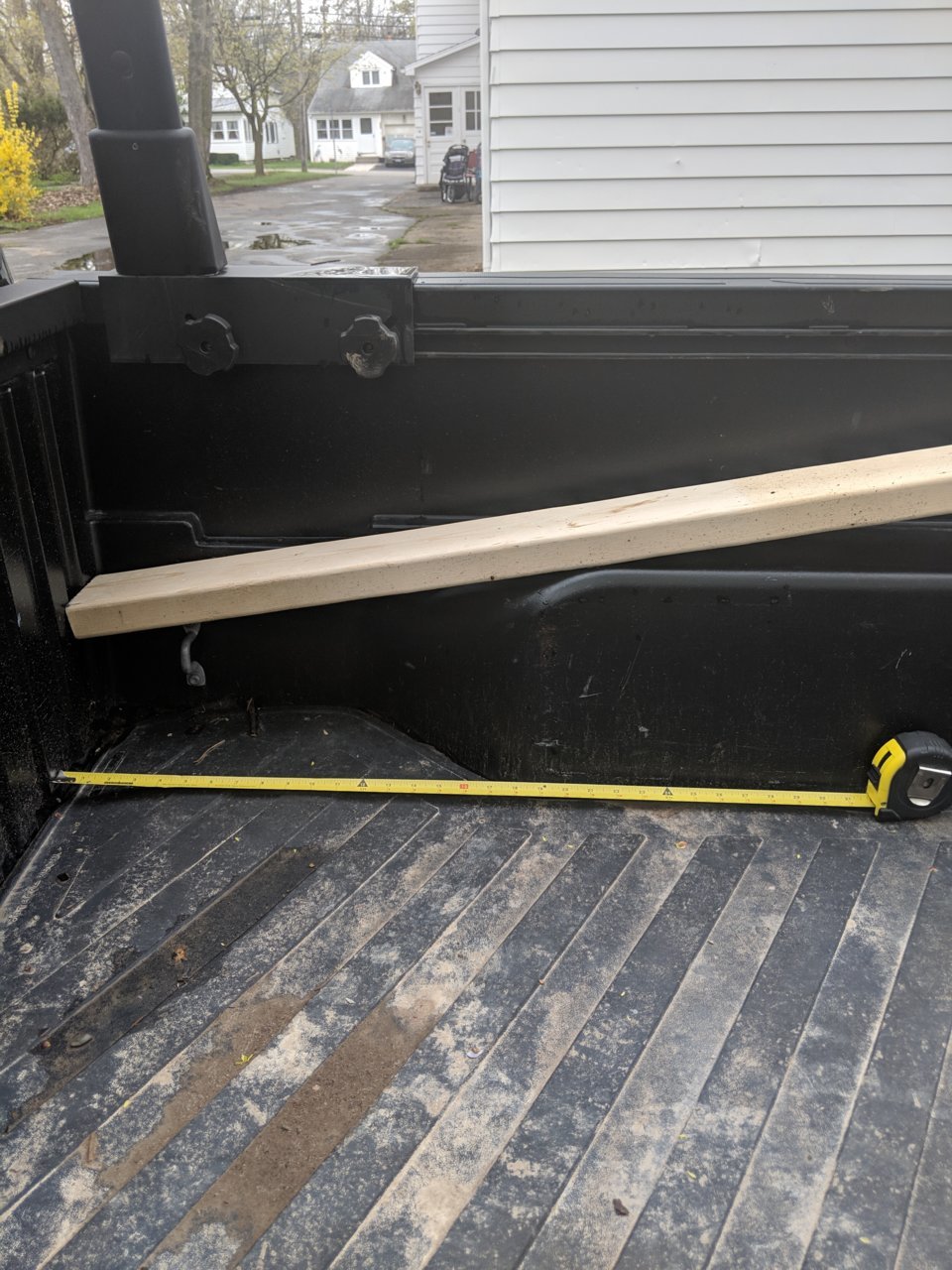

    Ok.
    See how it's not resting at the front of the bed? You have a fulcrum point about 20" in.
    wi_taco and royceferris like this.

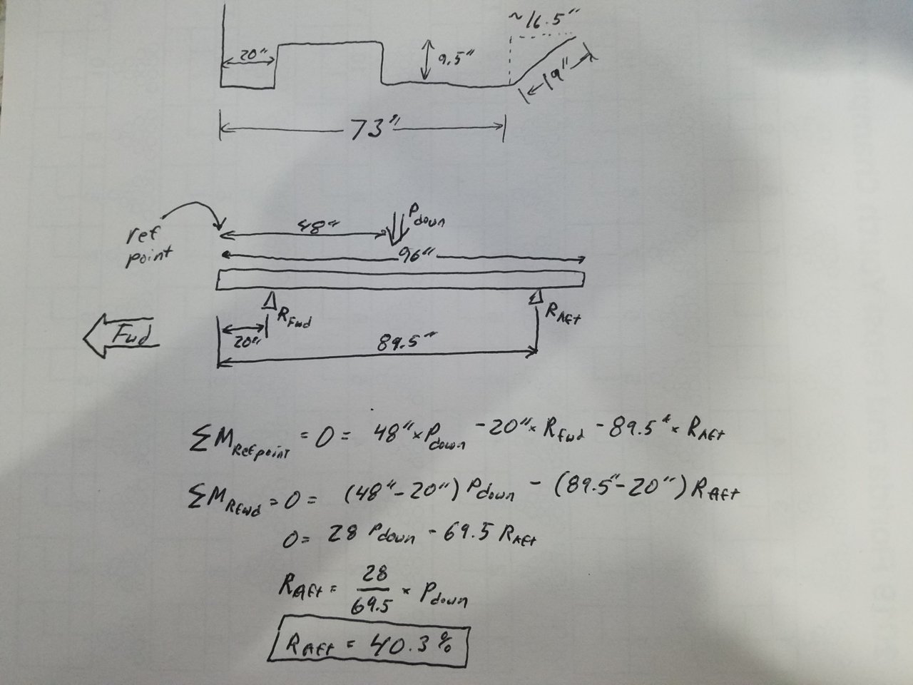

    I think you have summed your moments backward... (also, rear support is at about 89.5", not 96").
    Per my calcs, aft support has about 40% load max. (And even less if the wheel well carries more load over its surface.) Note, sketch and calcs for long bed only. Dimensions estimates only from tacomaworld dimensions.
    Alnmike likes this.

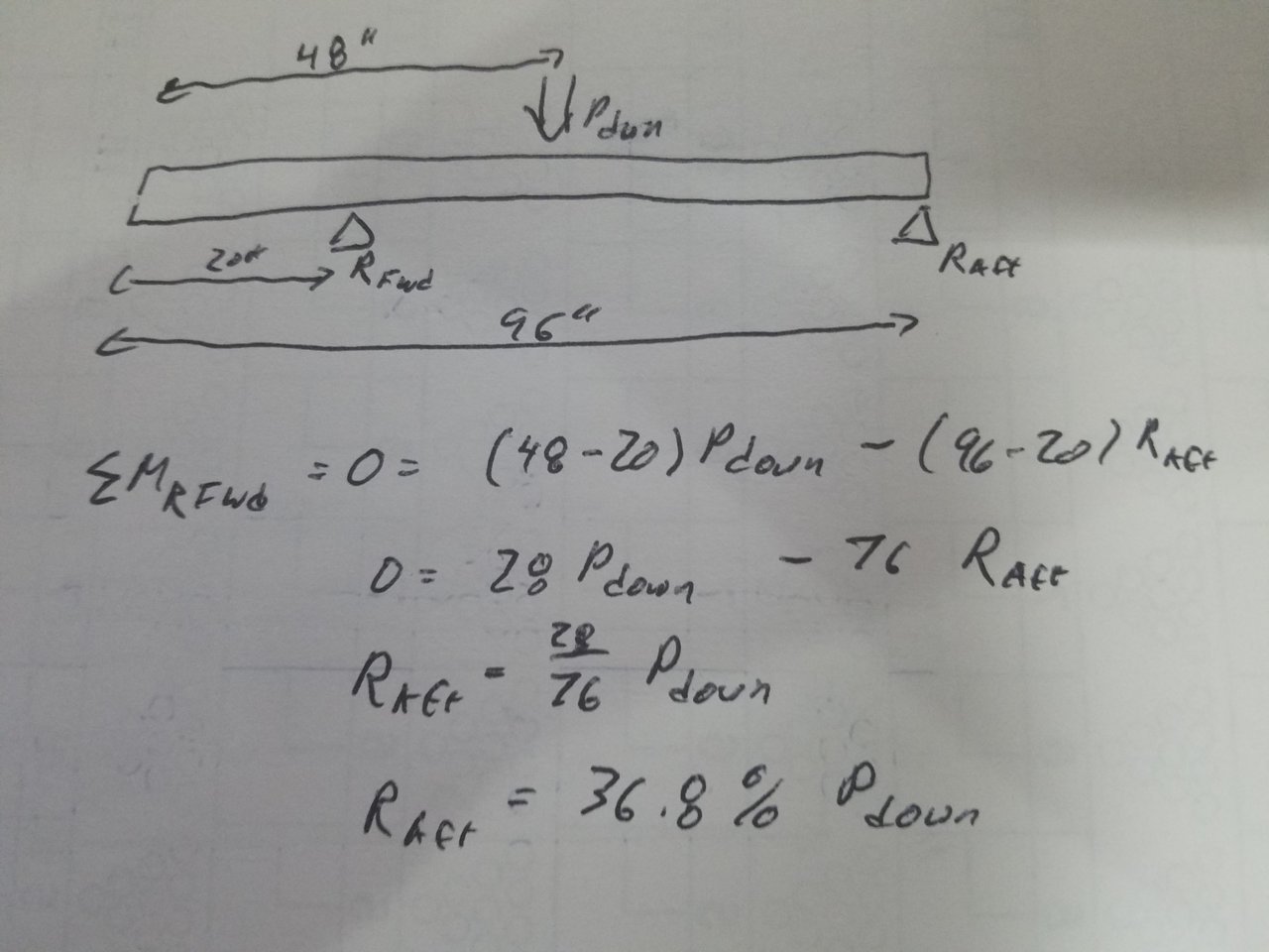

    Got it, makes sense for lifting
    You do know your 21% and 79% are totally wrong, short bed or long bed, right?
    So for picking it up, on a long bed its 37% of the weight.
