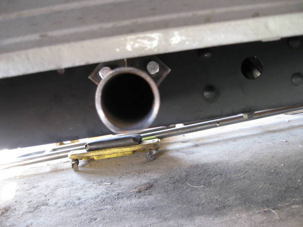

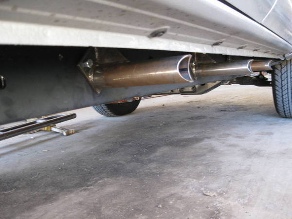

    Avid bolt-on ones bolt to the cab. I bought the weld on ones and bolted them to the frame. they are really secure, and you can use some of the holes already in the frame. you will have to drill the rest though. I know you said you didnt want to, but its worth it if you want to off road and use a hi-lift.
