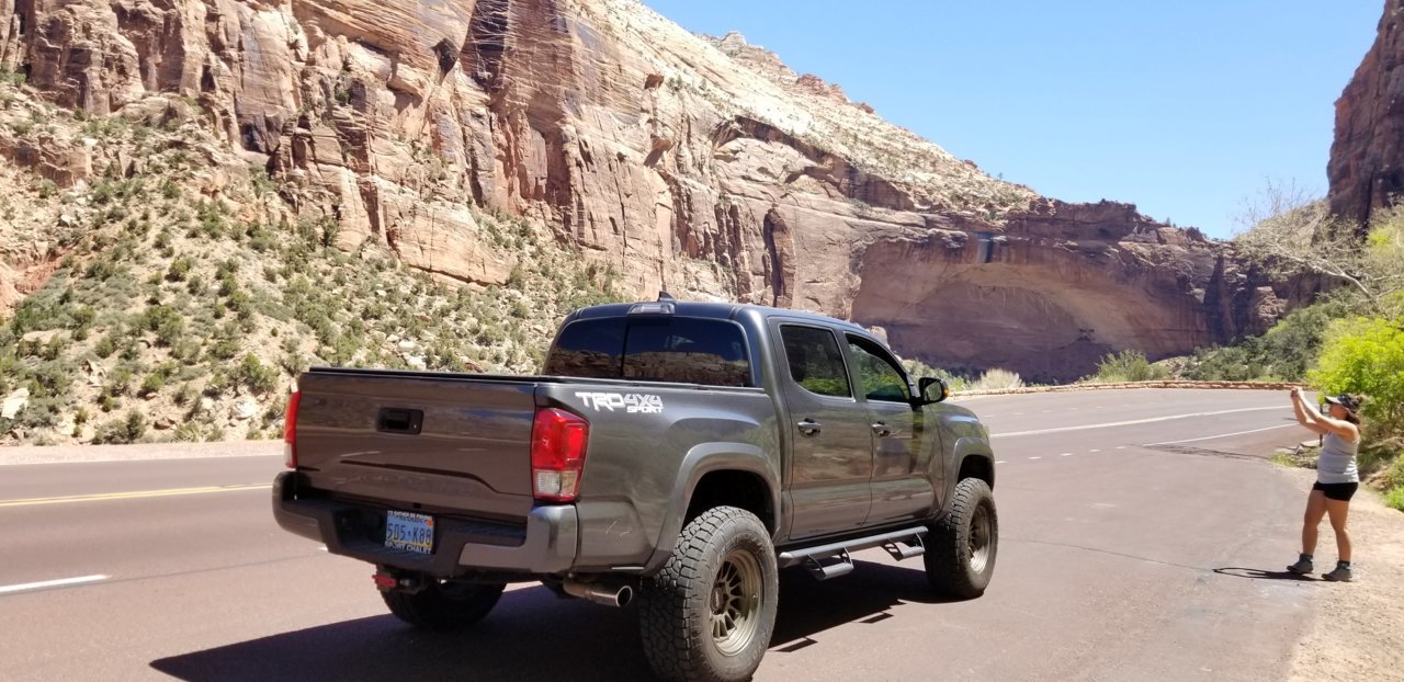

    I took this photo when I first installed wheels and tires to show how much they stuck out vs oem on the rear. This is a 285 75 16 tire on a -25 offset 8 inch wide wheel. You are looking at a slighter wider wheel but narrower tire so that's probably a wash and will look very similar to my truck. On the subject of added benefits I feel going lighter is a pretty good benefit especially when adding a heavier tire. Unsprung weight is the biggest factor when it comes to mpgs. These FN five star wheels weight less than 19 pounds.

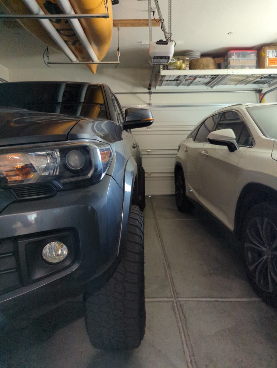

    Dakars -25 on 285/70/17
    Dfpftw likes this.

    Thank you for the pics! They look great and my taco is also magnetic gray. I'm confident I won't go all the way to 285's but this is helpful.
    not0ny[QUOTED] likes this.

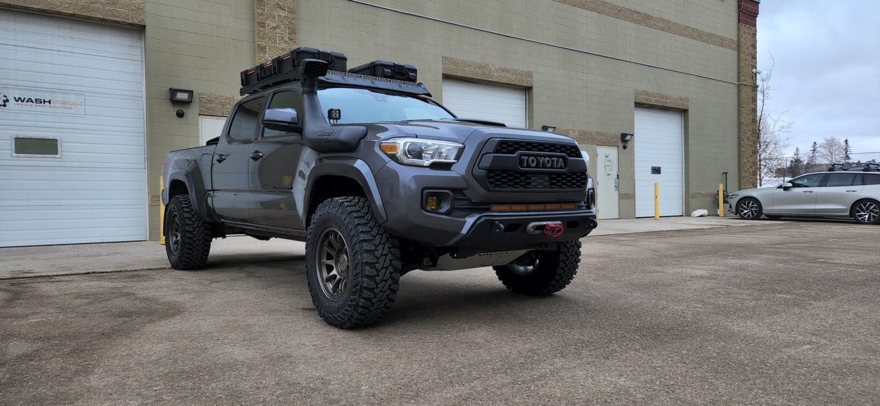

    Not dakars but summit apex in the 17x9 -25
    This is with 295's and it took some work to clear big cmc pinchweld fold dirtking uca's and caster pushed to +4.
    Running a 265 on a 9" wide wheel or even a 275 is pushing your luck if you like to air down much. I did it on my old set up but never pushed it past 20psi as the tires were super square to the wheel.
