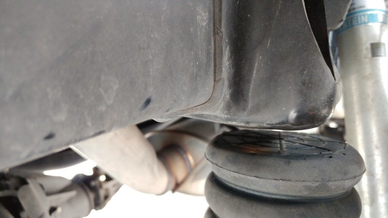

    Just put on my Headstrong Progressive AAL this past weekend... Have had the SumoSprings for about 6 months. Here's a pic of the gap... Probably close to 1/2".

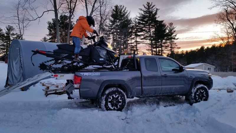

    Here she is under full load, to give you an idea of how the sumo springs sit loaded. This is a completely stock OR except the sumo springs and about 900 #s.20170316_185531.jpg
