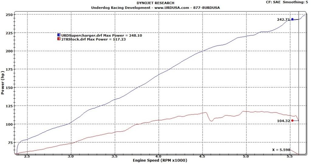

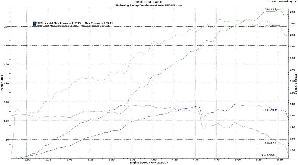

    My 2.7 felt like my buddies 3.4 that I was driving when I purchased my Tacoma. Here is a Dyno from Gadget (link to original post http://www.tacomaworld.com/forum/un...supercharger-05-4-bangers-16.html#post3297350 ) you will want to read the parameters that the runs were done under but as you can see the numbers are close to the 4.0 but mine feels more along the lines of the 3.4 but way punchier IMO.
    I've wheeled 4 times since the install and done some higher speed stuff as well. Seems like the boost really comes on at 2k or above which usually in low I'm around 2-2.5k so the boost is there but not in a uncontrollable or explosive sense it very manageable and makes the truck even more fun to drive off road. I'm trying to get a video that a friend shot of some snow covered rock ledges that I climbed in low but boosted to get over the top ledge. I think it shows what its like off road and surprised me as it was the first time I really tapped into it.
