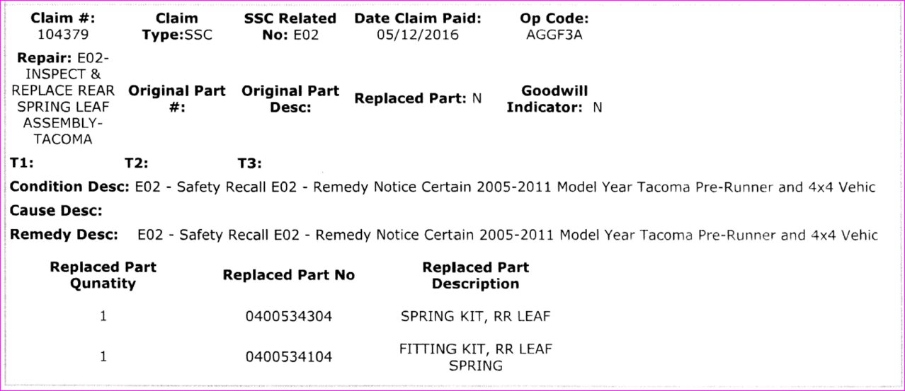

    Mine were replaced as a safety recall (rust?) at 81K miles. At 100K miles, the frame was replaced.
    Unfortunately, they do not list the replacement part number on the service line print-out.
    Worse, I ended up with a sticker on my door that said my load carrying capability was reduced.
    I'm not sure how much, but I recall 200 to 300 lbs with no visible sag
    Also - shame on Toyota corporate for not being able to spell "Quantity" in their corporate systems.
