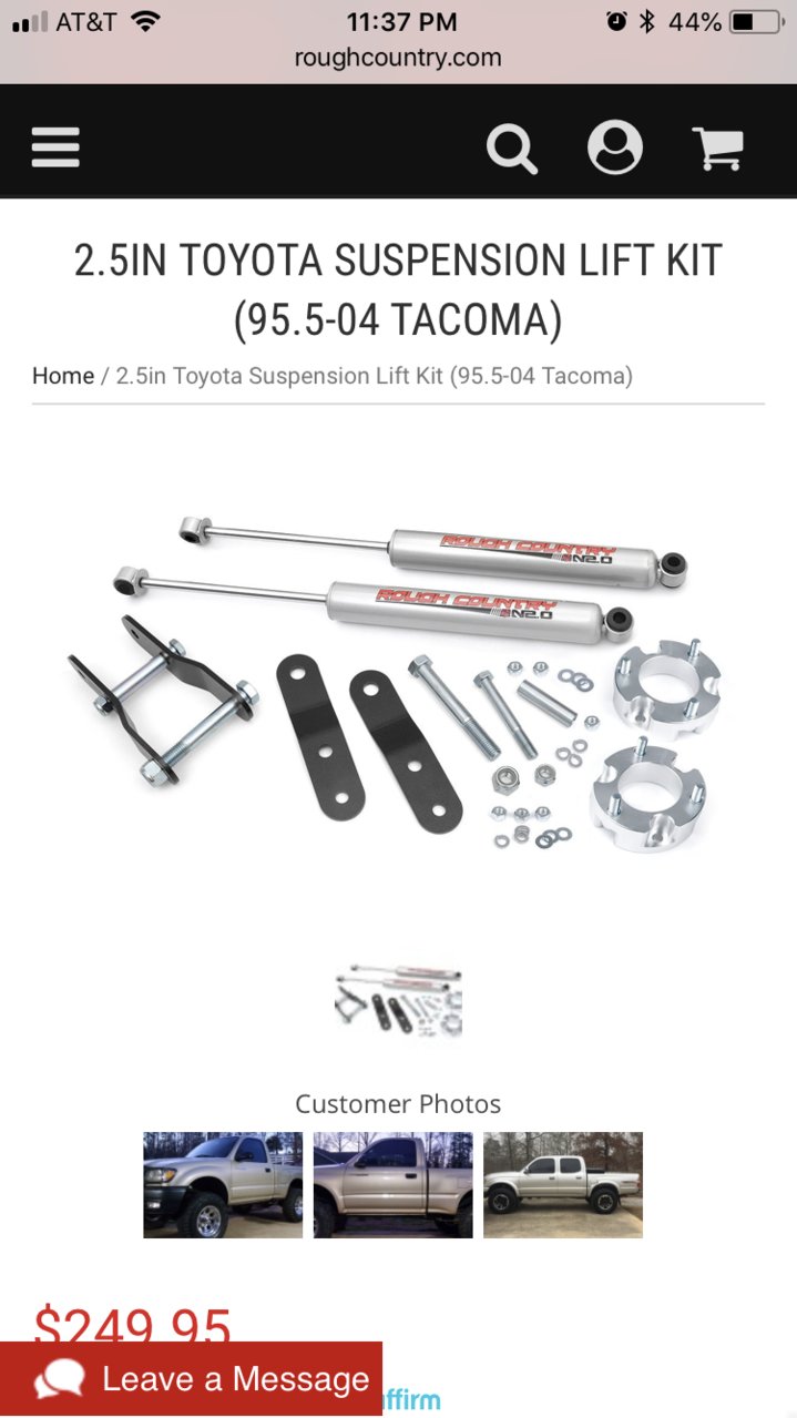

Anyone have the ROUGH COUNRTY suspension 2.5 lift kit with spacers? 1st gen

    Anyone have this lift kit? Wanting to get it and want to hear some reviews on it and maybe some pictures if y’all have some. Thanks!

    I haven't used rough country on my Tacoma.
    I DID however install a 4" Rough Country lift kit on my 2002 Grand Cherokee (WJ) and was severely discouraged.
    Before I even got the thing on the trail (it was my daily driver), I found bent or severely distressed parts, from regular daily driving (city streets and highway).
    I wound up replacing almost every part from that 4" lift kit with pieces from Iron Rock Offroad.
    Because of this, I chose to avoid them.
    Again... haven't used them with parts for my Tacoma (going with OME).

    The 2.5 lift kit with spacers?

    Isnt that a shackle lift in the rear? I put on a Maxtrac shackle lift and wouldn't recommend it. Makes the bed too spongy and can increase axle wrap. It sags down at the slightest bit of any weight. Gonna rip it out and throw in an add a leaf in the coming weeks.

    No only 2.5 in the front and a inch in the back.

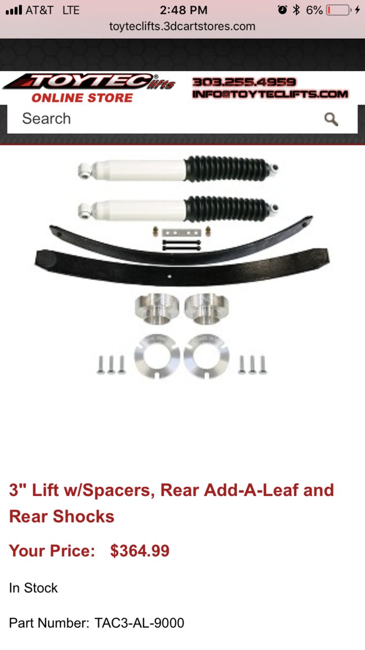

    Yeah I think I’m gonna end up going with the toytec.

    I would strongly argue against rough country though. I hadn't even taken mine offroad before parts were warped. No bueno.

    I'm gonna go against the common thought here but... If you don't off road and just want your truck to have the "look" whatever that may be, by all means get that toytec lift. It may ride a bit stiff but its nothing I would worry about. Me personally, I put in 5100 shocks all around but cheaped out with Moog Coil springs and a shackle in the rear. Needless to say I'm spending more money now because I have Ome 880's and an add a leaf waiting to go in to replace it. My point is, do it right the first time and make sure your happy with it. That Toytec kit is fine for someone who wants the look but if your going to hardcore off road your rig, grab an OME kit from Low Range for $1200 and be done.
