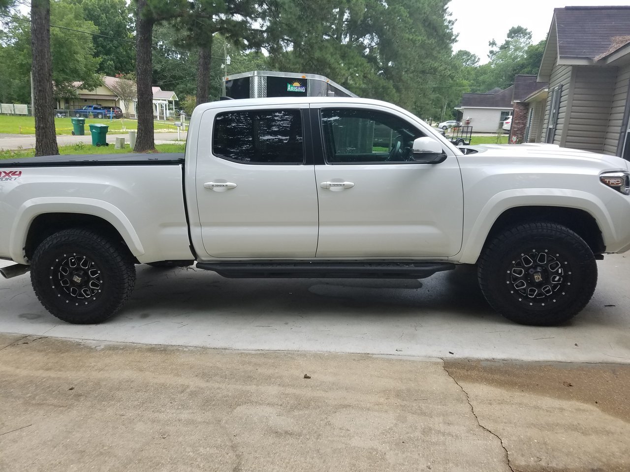

    Different wheel but same tire, mine are 8" wide 4.5 backspacing with 0 offset. Mine are about 1/4" from rubbing at full turn20170628_164136.jpg
