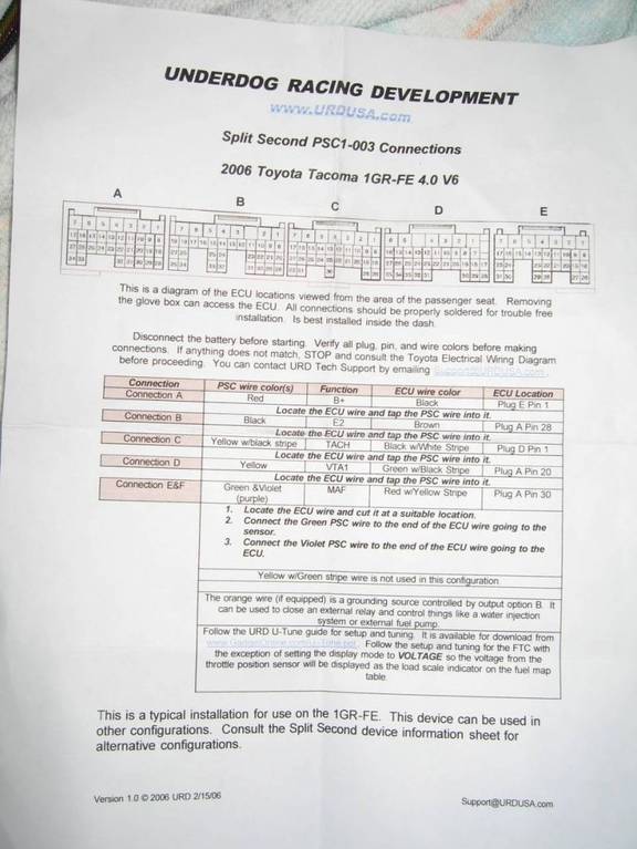

    I recently purchased a used MAF Calibrator, but don't have the instructions. Does anyone have a set of instructions lying around that they wouldn't mind scanning in?
    Thanks!

    It looks like the owner exceeded bandwidth on the first one, but the 2nd link should be readable.
    Thanks!
