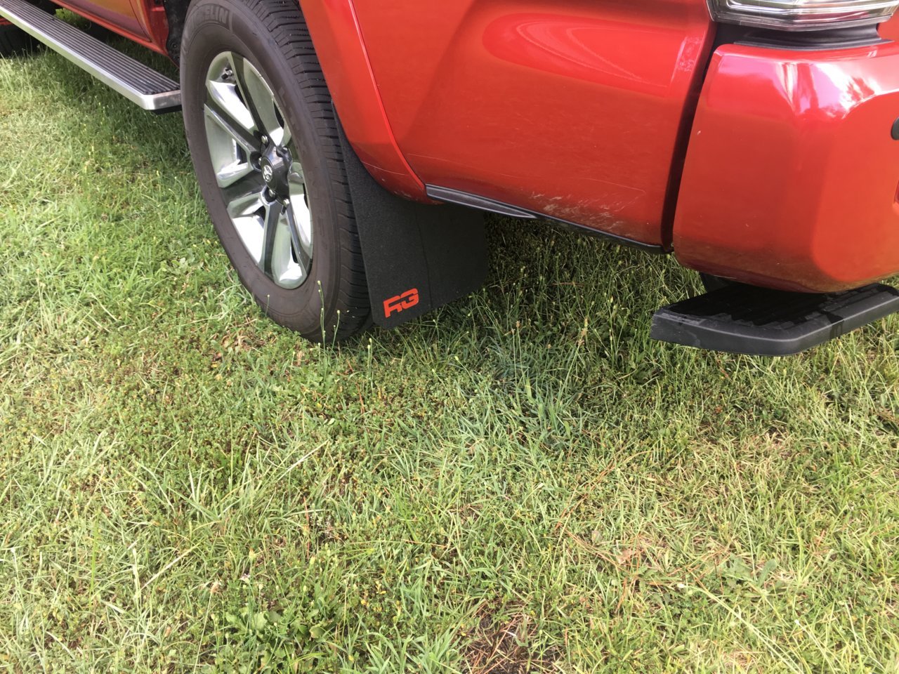

    9BD49CCA-5DC5-42DF-B2A6-F86712000C92.jpg BBA94983-9C70-4A84-9708-66E757A3F04D.jpg 5D127F0C-DFB4-4EC3-9E4D-18E85F42571D.jpg
    Here are mine. I think they look great.

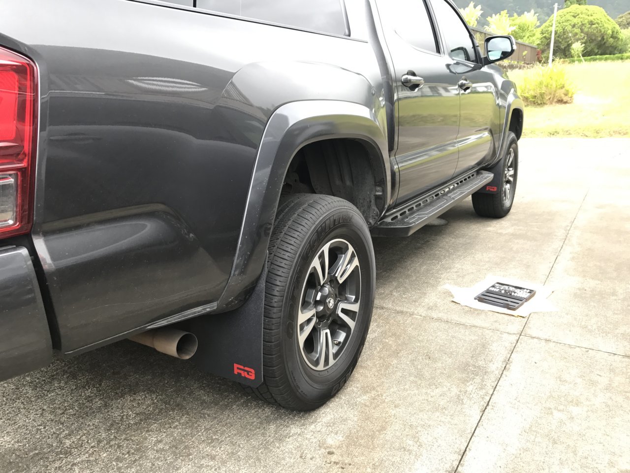

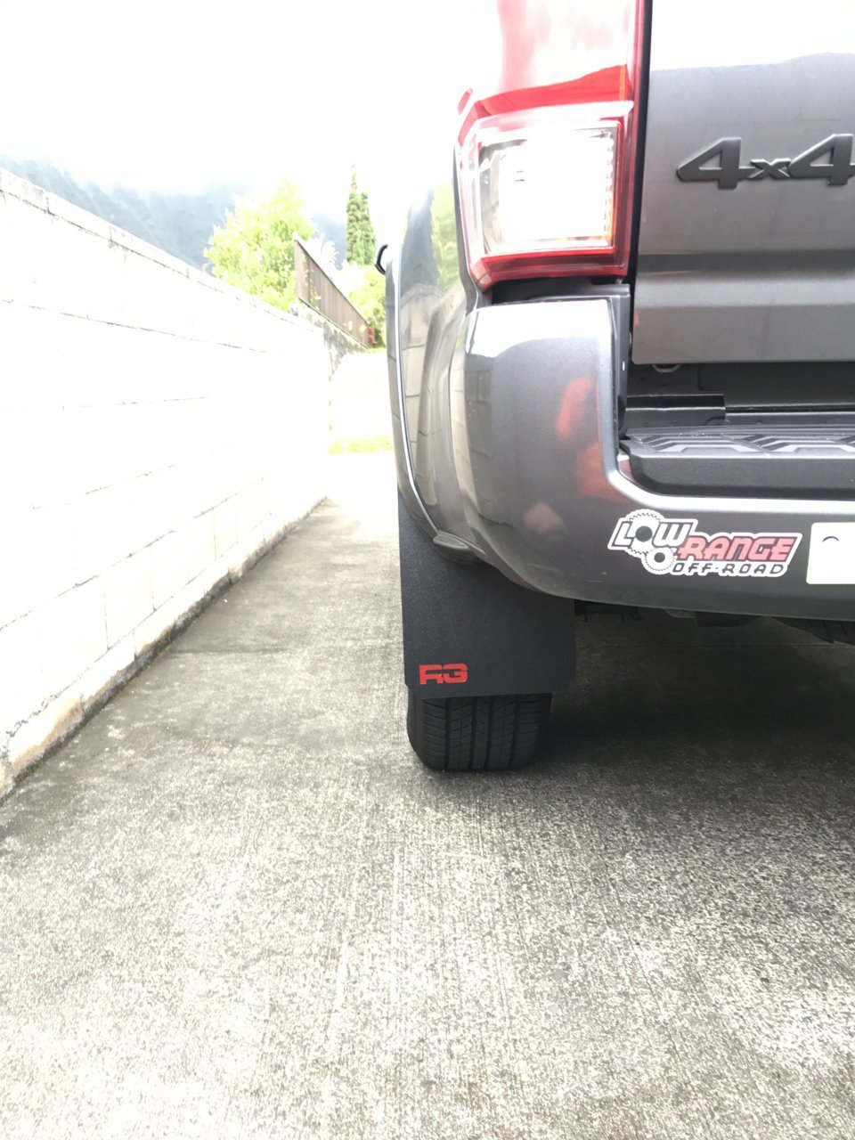

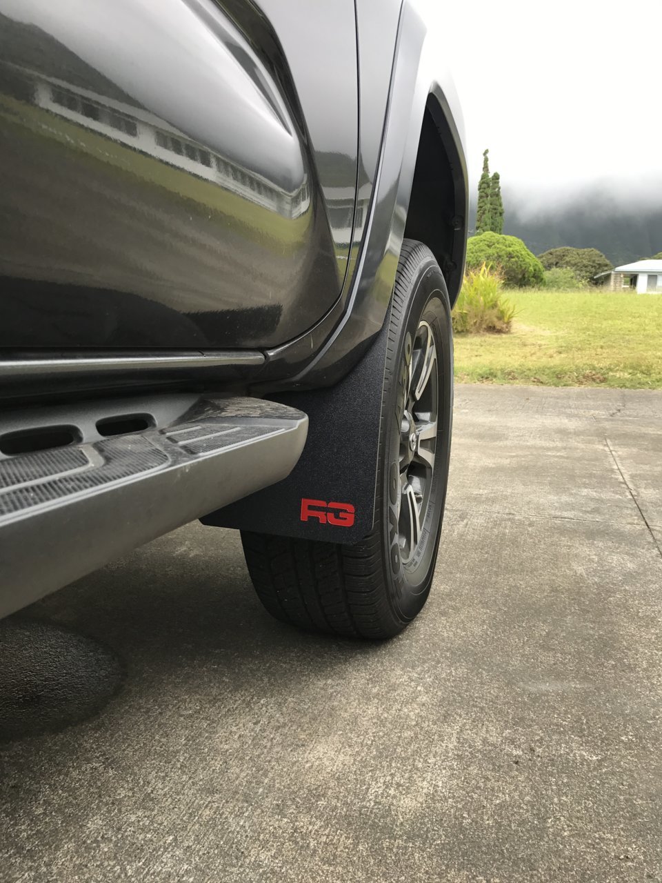

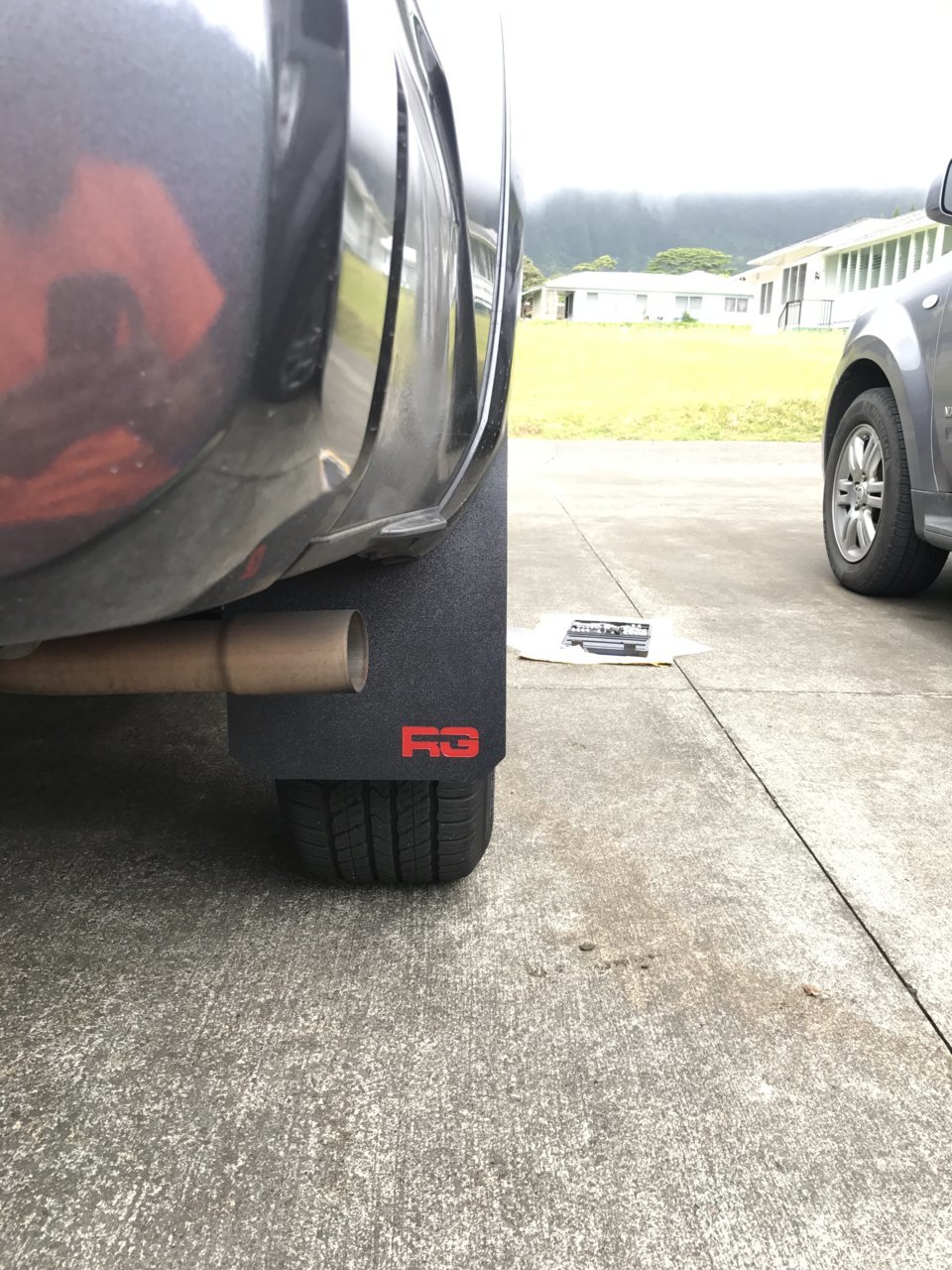

    As promised. Rek Gen normal size installed. Install was easy. Used existing screw holes. Only problem I found was that they either packaged the screws incorrectly, or I just found a better way to mount the flaps. My "front screw package" came with long screws for the inner most hole (the one you put a spacer on) that were shorter than the long screws for the rear. My advice is to swap those long screws around. Use the longest two screws for the front flaps and the second longest screws for the rear inner most hole that requires a spacer as well.
    Quality feels legit. They are heavy for only being 3/16".
    Good luck everyone :cheers:

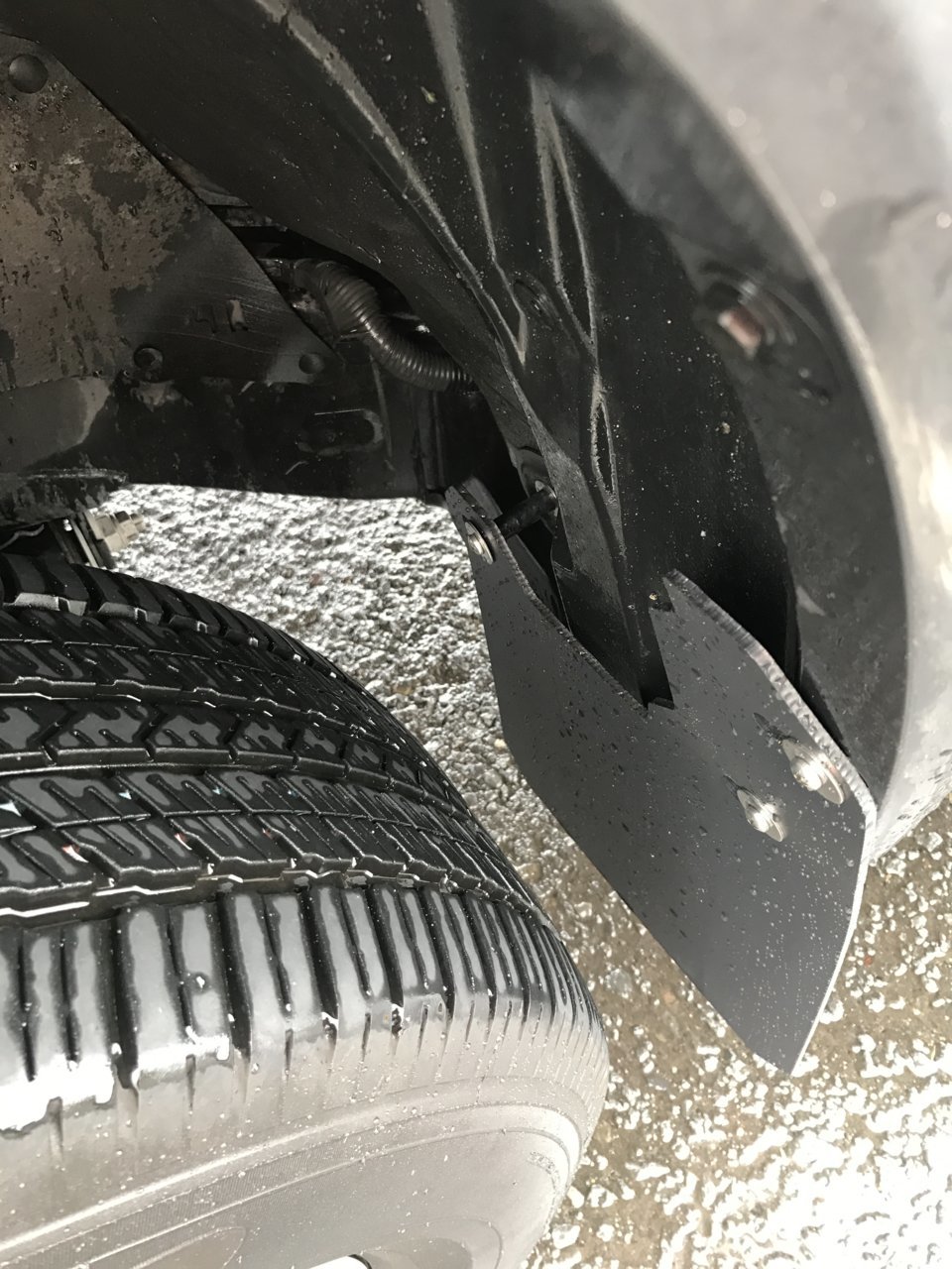

    Can someone take a picture of the front flaps from inside the wheel well? I want to see how they sit in the wheel well, for clearance reasons.
