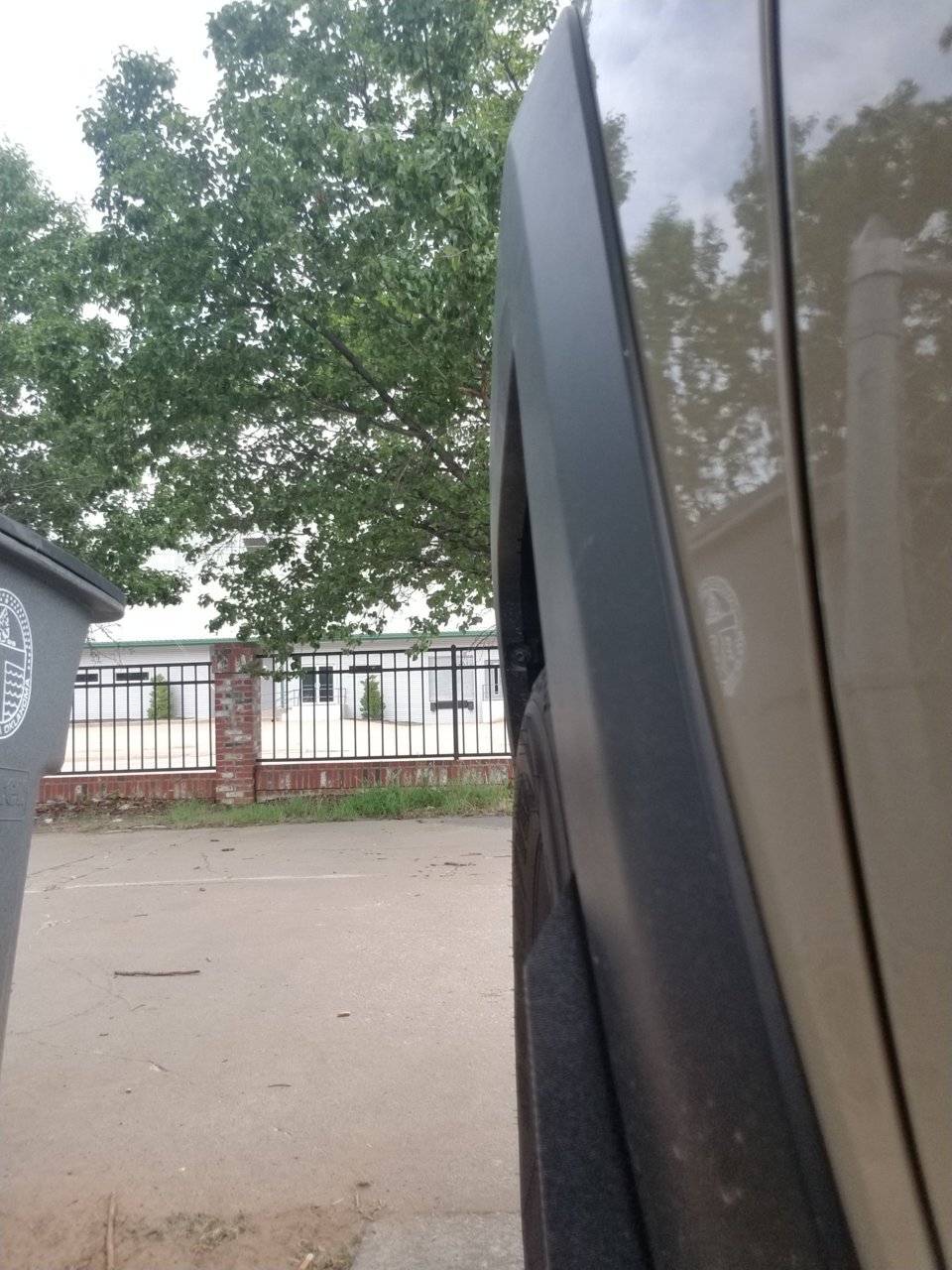

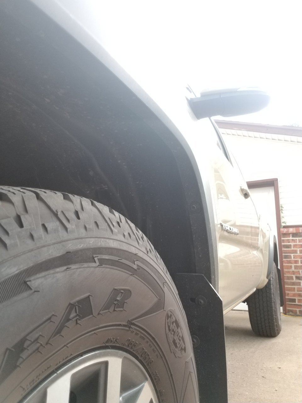

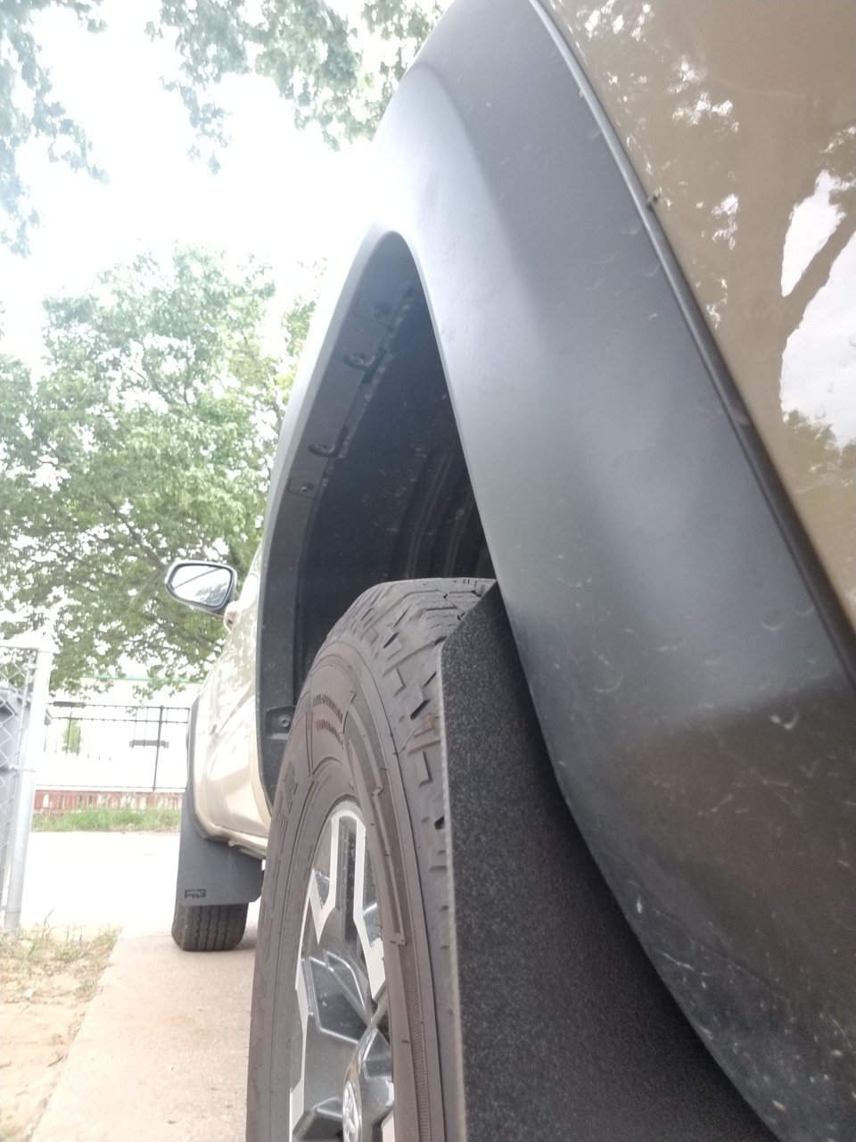

    Used the front facing camera....
    Painted the hardware before install.

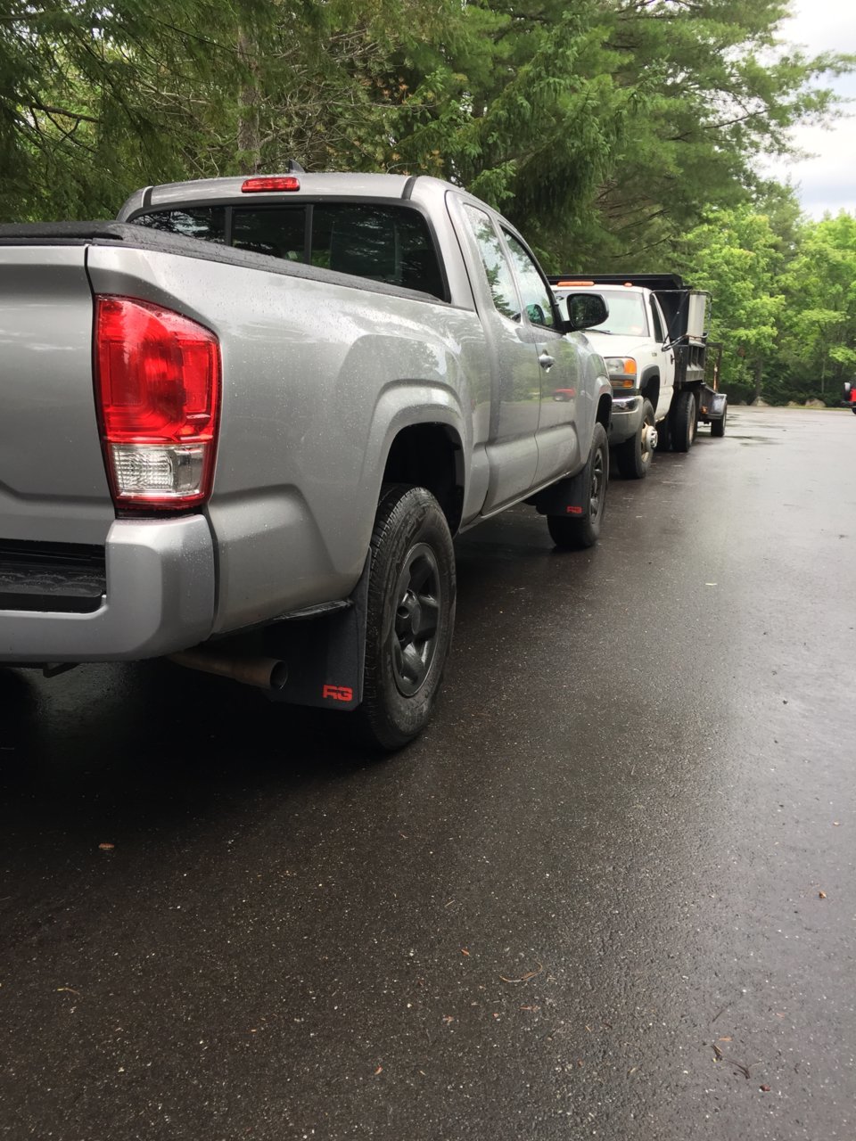

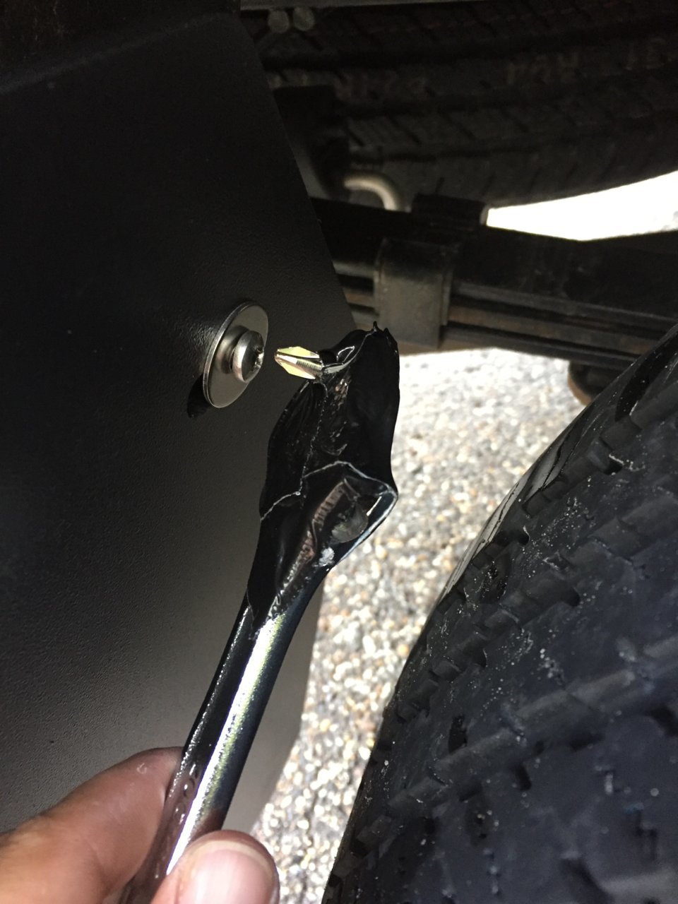

    Love these flaps. Little tricky putting them on without removing wheels but I made a custom tool for it.

    Harborfreight has a 90 degree angle screwdriver for 3 bucks ... worked perfectly.

    Good idea! I believe that you can do the same thing with a 1/4" ratcheting wrench to make installation a little faster.

    I was looking everywhere hoping I had one. But I have limited tools at my apartment and couldn’t wait until work the next day.

    Those look absolutely perfect on your SR.
    Good idea on the wrench in a pinch. I used a 1/4 ratchet and socket to fit your allen bit into.
