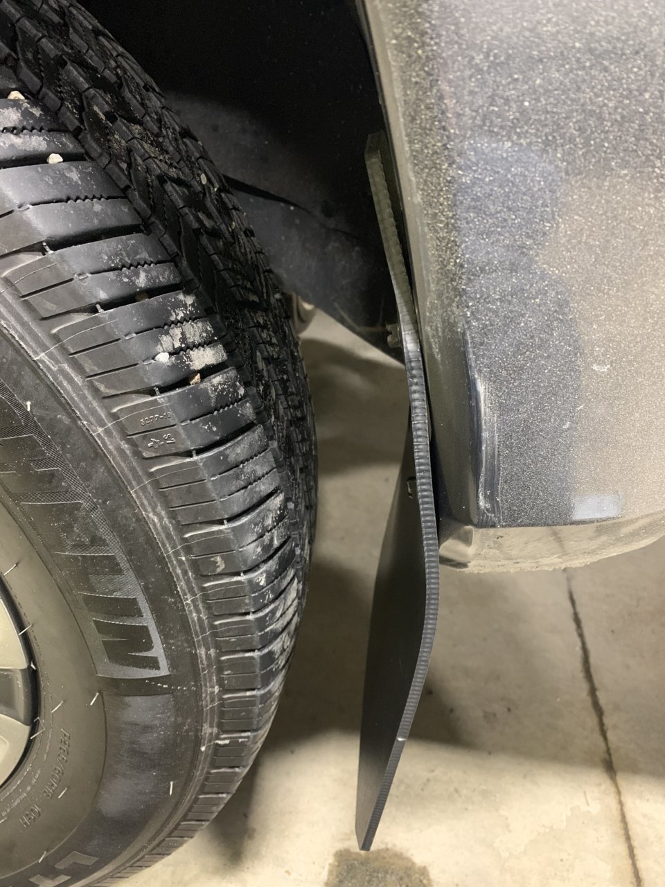

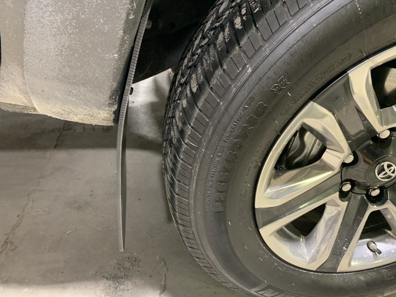

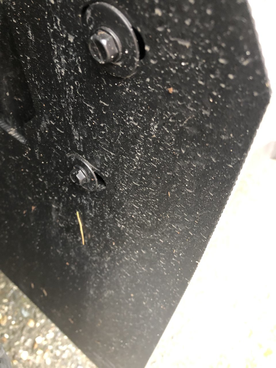

    Boats07,
    I placed one washer on each side of the rear mud flap so the spacer did not go through the mounting hole and the washer set's flush. Looks like you have them both on the front side of the flap. Also both my front and back flaps are pulled/bent back on the inner mounting location, I don't think it is an issue and I like that it fits better to the inner fender.

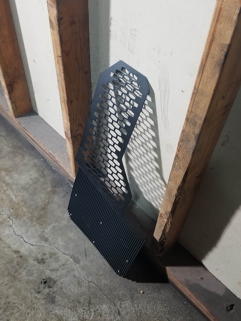

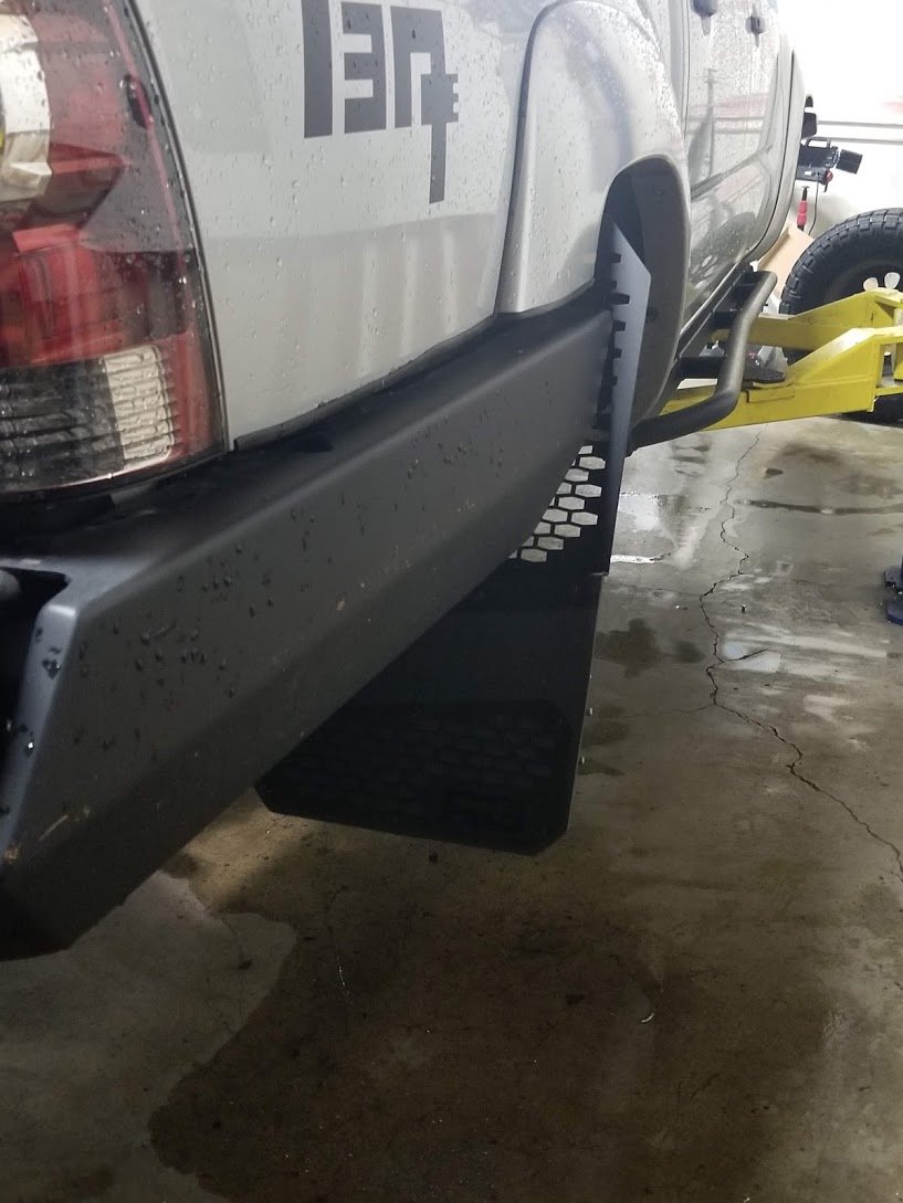

    if you want adjustable flaps that can stick out as far as you want, i would look into these
    they are just over a 100 a pop but are made from a mix of plastics and aluminum

    Yeah. I realized that after looking at instructions picture. But when reading instructions it didn’t seem that way. “
    2. Start by attaching Long Self Tapping Screw, 2 washers and spacer to flap (figure 3).” so I read it and installed then decided to look at pictures. It didn’t say screw washer flap washer spacer.

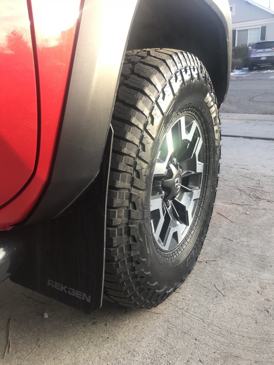

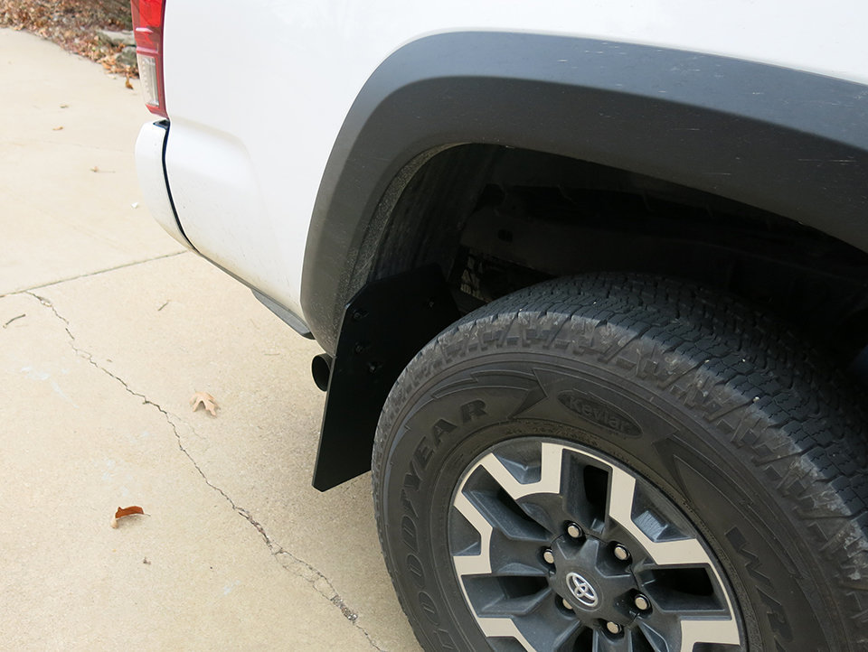

    Easy install of the stock 11" RekGens on my TRD Off Road. I did paint the hardware a matte black. You have the space to let them stick out a bit or be flush with the side of the truck. Mine are flush with the flares.

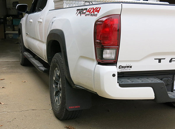

    I love mine, bought the plain, XL size. Easy install, quality material and stainless hardware was included. Think I paid about $90 from RekGen directly a few months ago.DEF3F550-383D-47F7-BA1E-62FF7EF97CA3.jpg

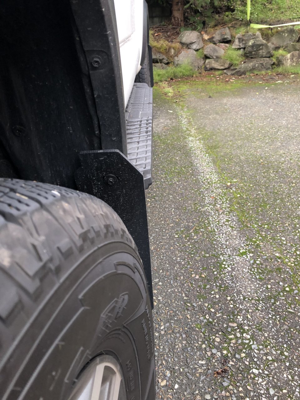

    Happy with mine, I got the regular size. I have 265/75/r16 General Grabber ATX and found that I rubbed the inside bolt when turning into the driveway, hitting the curb and flexing on it. So, I pulled off the inside bolt, cut down the tubing to about 1.25 inches or a bit less, cranked it in tight so it is pulled back/bent in a little, and I no longer have the rub. I like the look after having had the 4x4 mud flaps on my Gen1, and they really do help keep rocks from tumbling around the undercarriage from the Generals, and keep the spray of leaf debris and mud/dirt off the truck. I screwed up on the bolt and doubled up on the washers as well. I'll fix it when I see there's an issue with the tubing popping through.

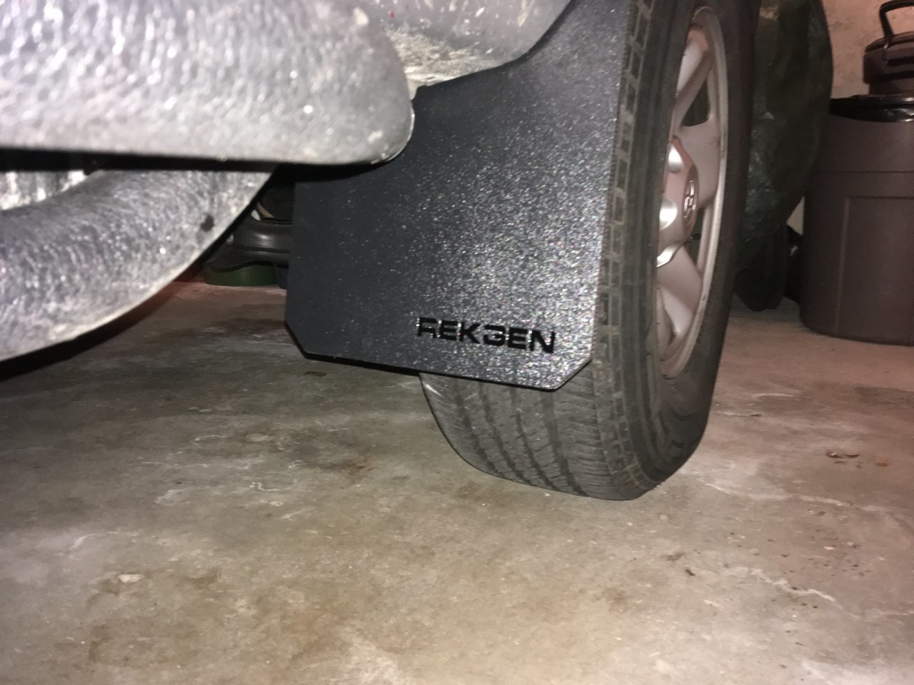

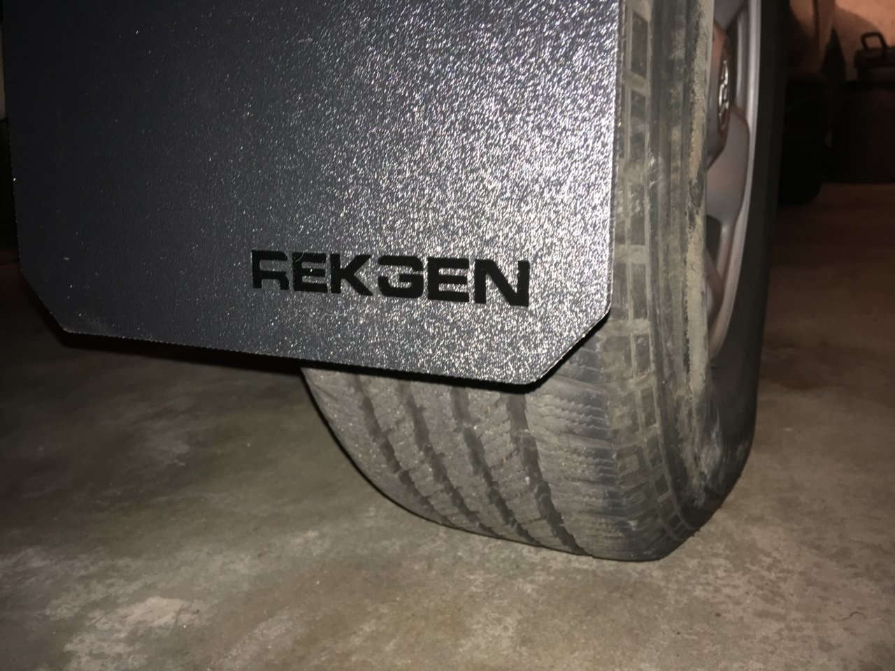

    Installed them last night. Went on pretty easy. Seem to be good quality. I drive gravel roads and want the protection a mud flap offers. 4A5226DC-8656-4B7C-8F55-47E2A386475E.jpg 14F2F525-B1D9-49FF-A2E6-F692EF0ECB8A.jpg
