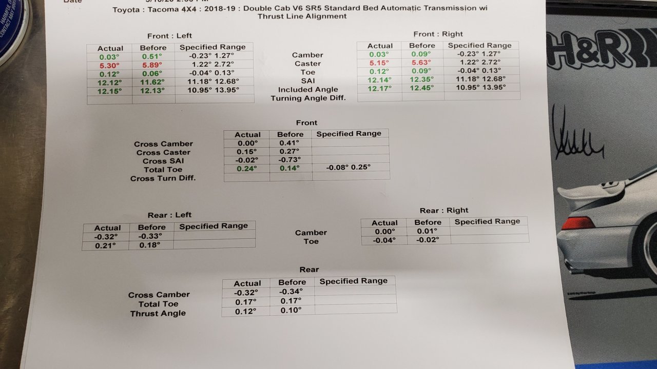

    20200316_063806.jpg I ended up bringing toe to .10 after this.

    Ya that looks like a great alignment. Iv been under my truck about 4 times looking at my suspension and I’m positive nothing is loose or bent so I think the SAI numbers in mine are just a bad reading or something from the machine.
    I drove my buddy’s lifted Tacoma and it drives the same as mine so I think the difference I noticed was because of the lift and the tires and that’s just how a lifted Tacoma should drive. This is my first lifted truck ever.
    I’ll know more on Tuesday once I get it checked out by a more confidant shop but I’m guess my truck is fine and I got a bad measurement for SAI.

    YIKES that is a lot of caster! I hear your rack screaming! Don't be surprised if you are replacing your rack and power steering pump on a regular basis. Ball joints and tie rods probably won't be far behind. Why so high? Also why did they go so high with toe? You don't want to be the high end. Glad you go it back to .10. Your tires will thank you.

    It drives the best (from the few setups ive tried) with it set up this way. The truck wandered so bad when new. Each of my alignment revisions have helped mitigate that more than the prior.

    Did you ever get your SAI thing checked out? Although I never got a final reading on each side for my SAI, while I was watching the tech do my alignment today I noticed my SAI was in the red (12.8 I think?). I saw this on the Hunter computer screen while he was finishing up toe and tightening things up. The final printout doesn't show SAI, so not sure what the actual final reading is or if it would have changed. Would my JBA UCAs affect the SAI measurement? I feel like its divided in this thread. Some say its a concern, others it isn't.

    I ended up taking it to an old school well known specialty alignment shop in my area to let a true professional do it. He did it without a computer and has experience with my particular control arms (SPC). I never got a print out but he told me he has been doing alignments the same way for 20+ years. He explained that aftermarket control arms could effect SAI and its not something to worry about because there is no way to adjust it. My trucks drives perfect and track strait as an arrow so I'm happy with it.

    I agree with your tech. SAI is really nothing to worry about because you can't adjust it. I have seen tech use it as an excuse for their inability to do quality work. They like to blame SAI as their out because it can't be adjusted.

    I just had mine redone. I have Bilstein lift with non-factory control arms. Experienced tech told me most trucks with aftermarket replacement control arms might show off compared to specs in the books. SAI a bit off, but Caster right on. I wouldn’t worry about SAI or angle differences. Tech showed me everything. No off-roading, nothing bent, all good!
