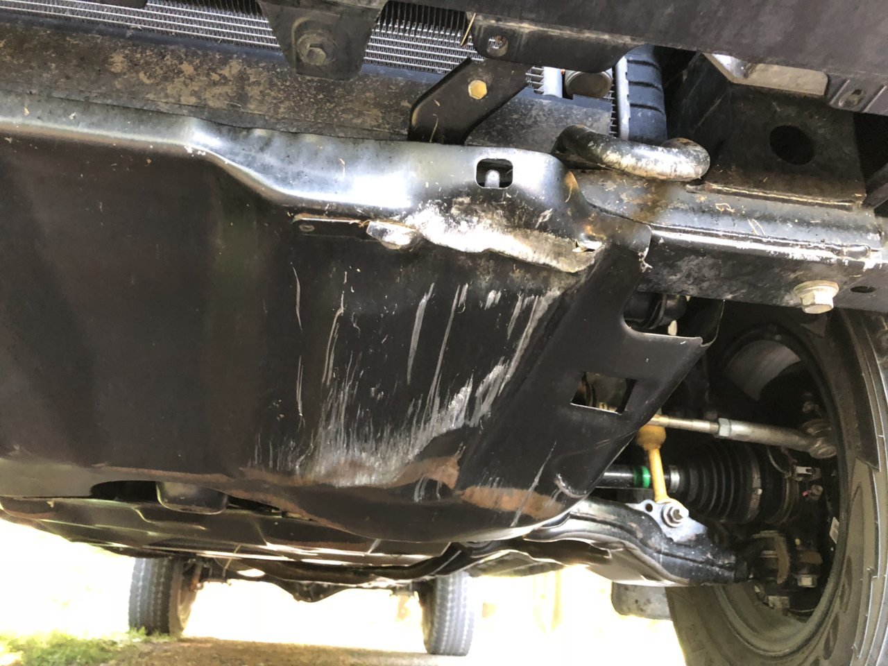

    I don't do any 'serious' off-roading or rock crawling, but I do encounter the occasional obstacle on some of the trails I run. The photo below is from this weekend when I was surprised by a drainage culvert.
    Clearly I need some better protection than the stock TRDOR plate, and if I'm going to do it I only want to do it once. I was thinking ARB because I see their bumper in my future, but after hearing how flimsy they are, I'm leaning toward BAMF. I could be convinced of another solution if there is one as hearty for my use. I know they're heavy, but I'd rather protect the truck than worry about weight.
    Thoughts?

    Not a bad hit! Ive taken similar and i run 3/16 rci skidplates. 1/4 isnt just heavy and badass, its also the cost of getting it from bamf all the way to wherever you are unless you live near to them. I will tell you that armortech offroad sells 1/4 steel ifs skids and lca skids at reasonable prices, then to keep it lighter the rest of the armor comes in 3/16 as you get below the transmission because there is more sliding done there than smashing stuff. I have found the RCI stuff to be quite stout so far with no let downs from their designs.
    I know they did armor for 2nd gens, you may have to check what they make for the 3rd gens at armortech now

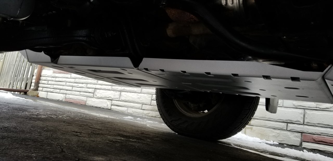

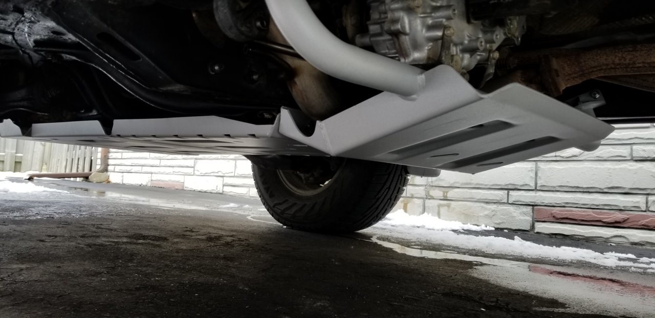

    I have a set ,think they are pretty strong but haven't seen any trails yet

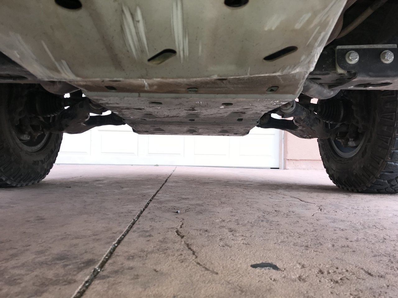

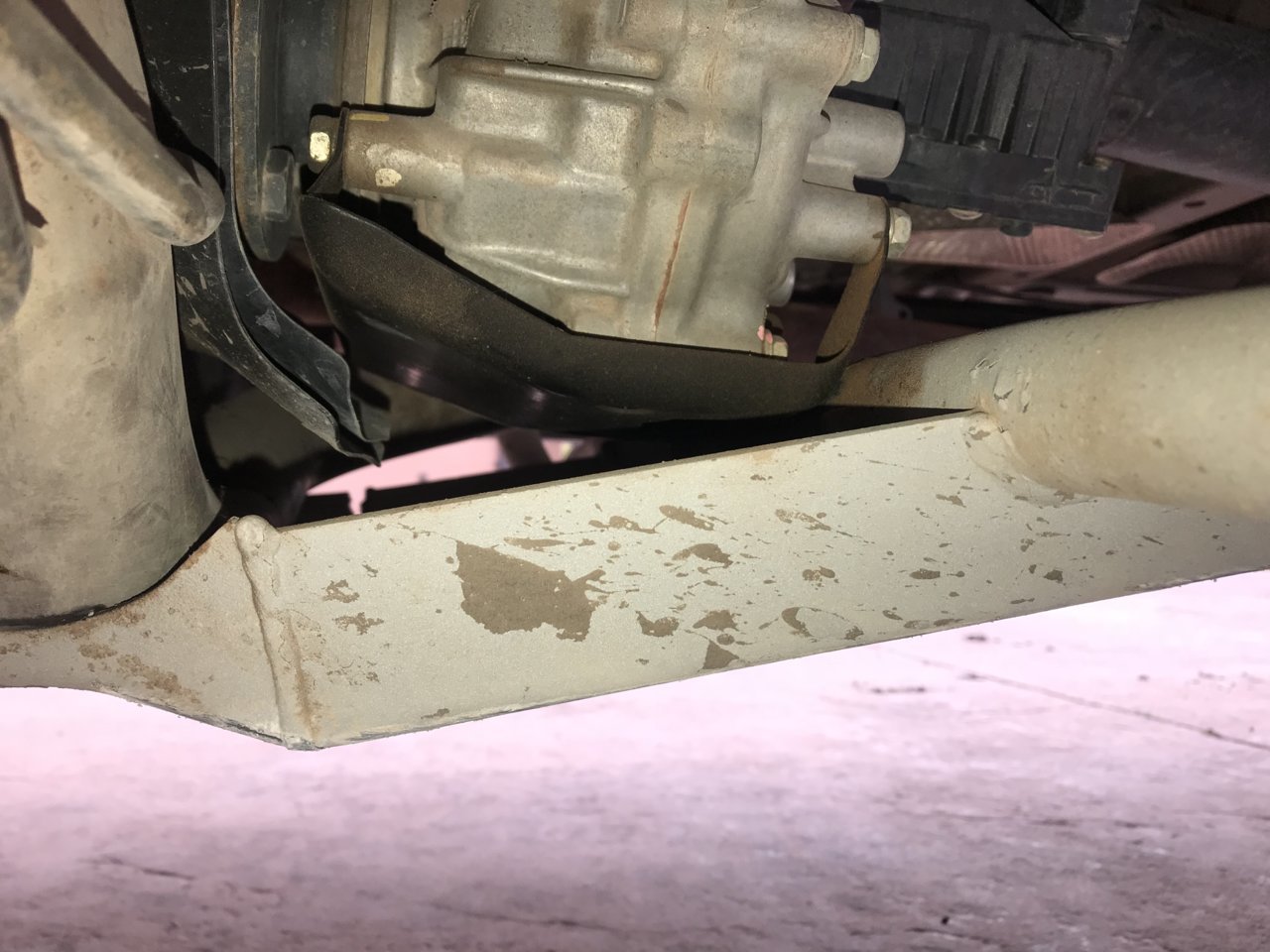

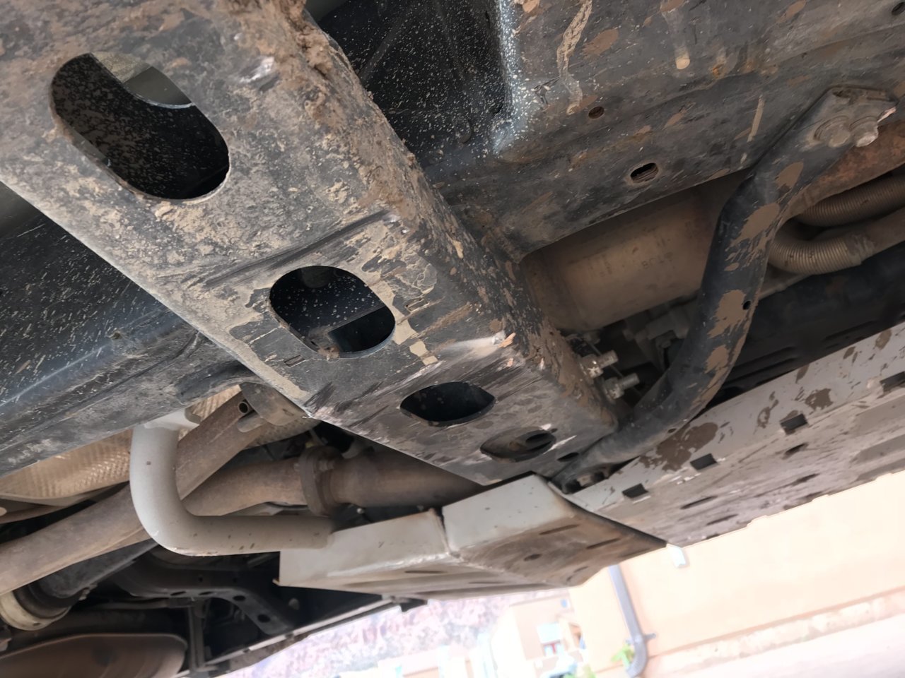

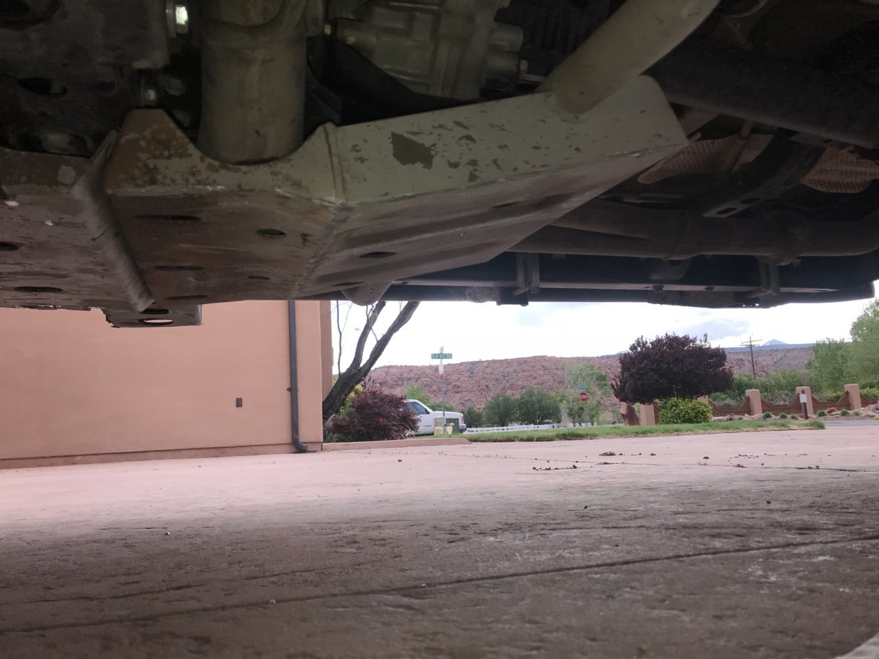

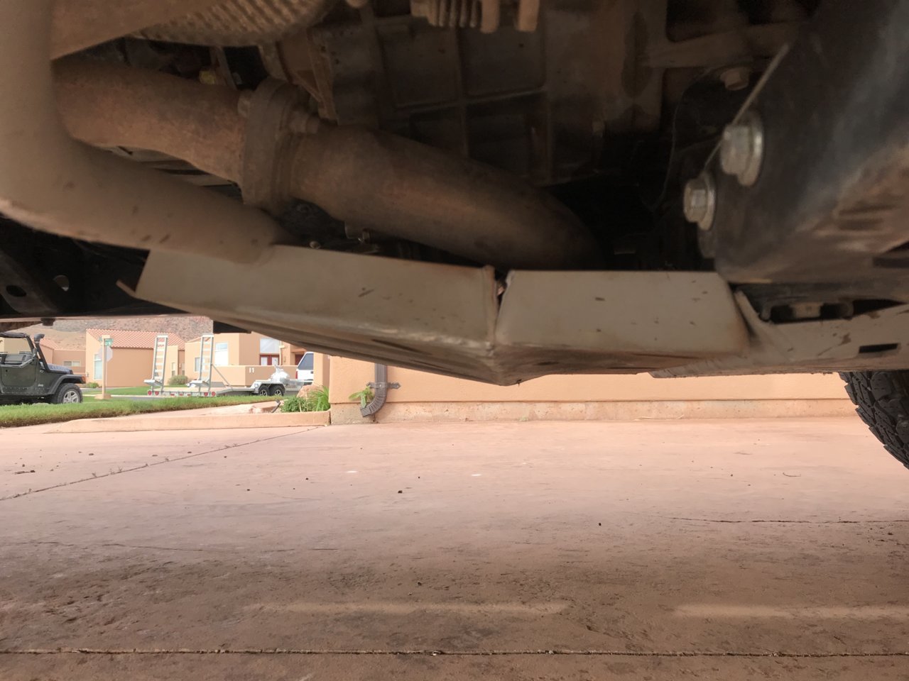

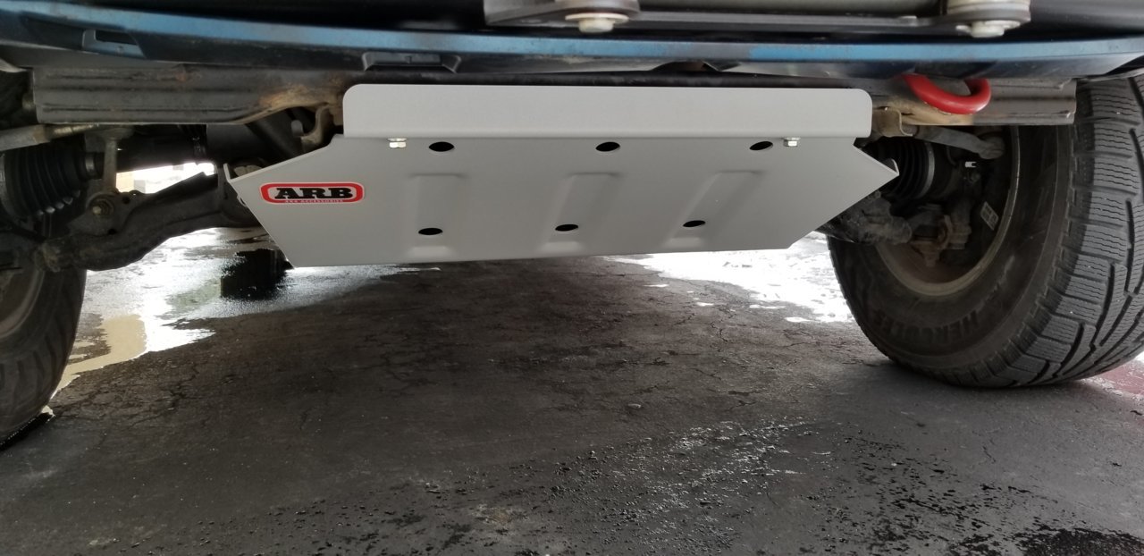

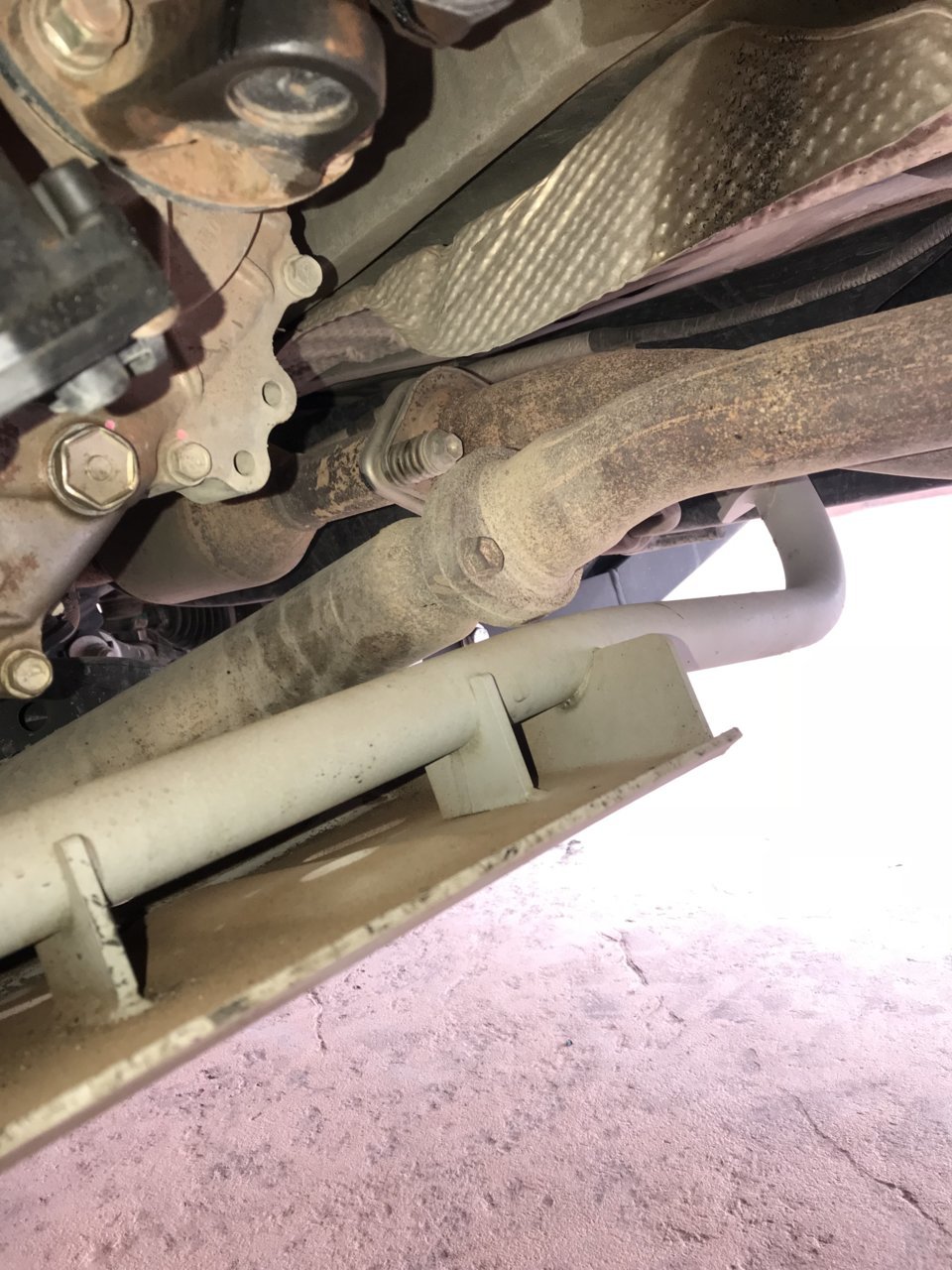

    I was originally excited about the ARB skids due to the stamped construction which added bends instead of thickness for strength. After using them one time on Top of the World in Moab, they were trashed. The rear skid sits extra low compared to the exhaust and is only supported by a small diameter tube. This skid catches and bends very easy. what I did was not abuse. My truck was brand new. ARB did replace the rear skid due to the torn weld.
    On a later trip I bottomed under the ifs twice in low range on a water bar and this bent the front skid up and broke one of the welded nuts loose.

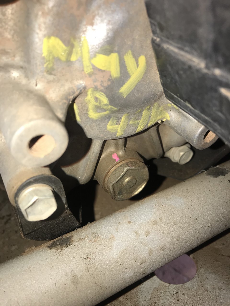

    In addition, the most annoying feature on these skids and the biggest reason not to buy them is that there is no access for oil changes!!!!!!! If you need to go somewhere to get an oil change and don’t want to pay an hour for removing the front two skids, you have to completely remove the front three skids in order to drive as they fit together and are supporting each other. The figment of the 13mm head bolts is also at a terrible angle, so this is not a simple operation. Not convenient in the least. Skids need access for basic service.

    Would cutting an access hole for oil changes be worth it? Seems like an easy way to remedy the oil change part.
