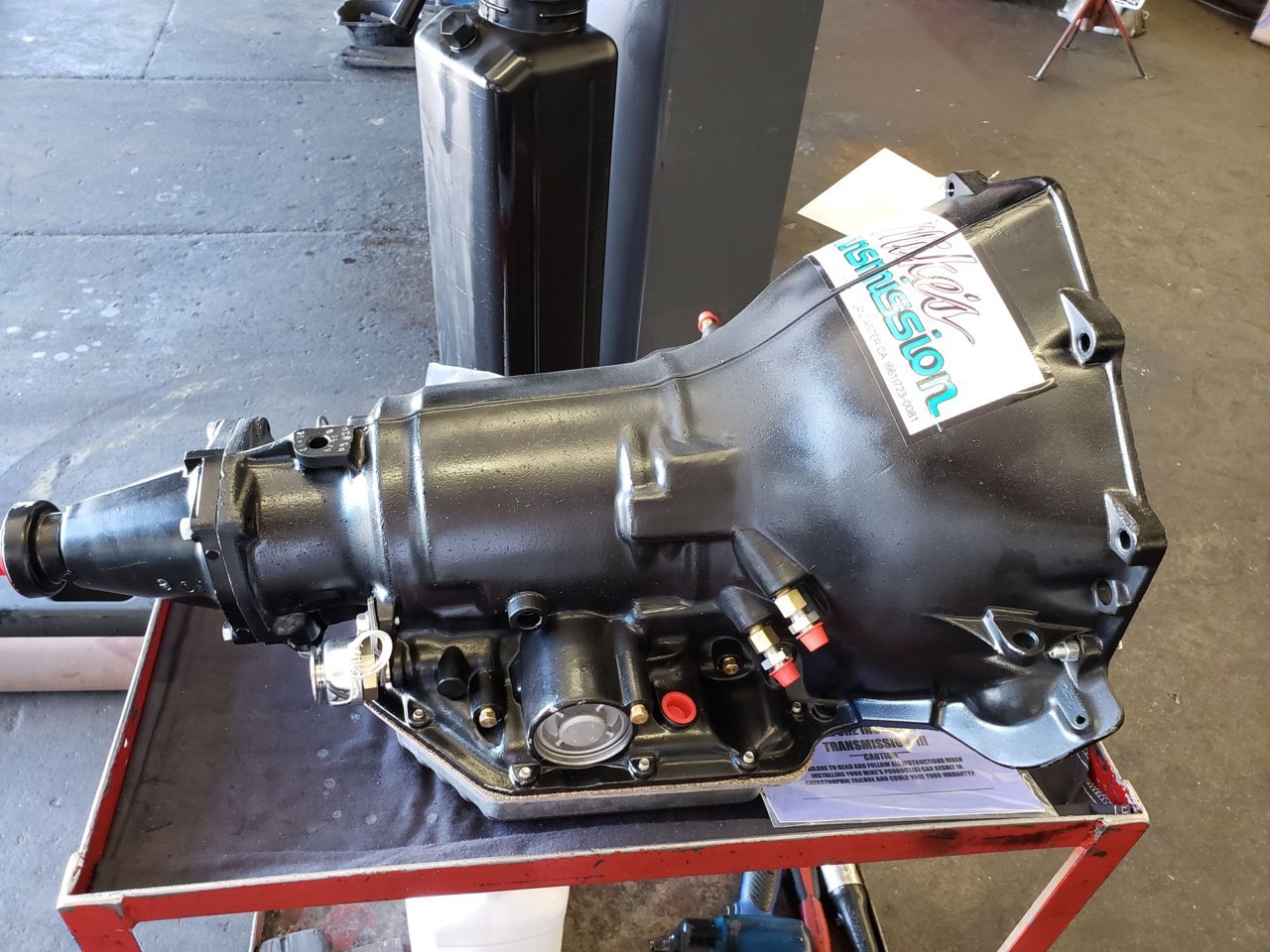

    What kind of car do you race ???? , what Et /mph 60 ft and current set up
    This is my 72 Camaro SS and currently going thru alot of updates , hopefully running low 10's
    Scott Shafiroff 427 sbc 565hp
    Competition built T350 trans full manual reverse valve body with transbrake
    Custom built 9" dia 4500 stall converter with anti balloon plates
    Rear suspension .... full Calvert racing rear suspension with Caltracs , split mono leafs , Calvert racing adj shocks
    Front suspension .... Moroso trick springs , Calvert racing 90/10 shocks
    GM 10 bolt 3.73 gears and soon to be in it's place a 9" Ford
    NHRA 9.90ET Cert 8 point cage , Jazz racing seats , RCI 5 point harnesses

    I love chevy, ive had a few79's . I dont have the cash to build one ...hows a 700R4 trans? Just wondered why you used a t350 vs t400?

    700R4 have reliability issues , I went with the T350 as it was built to hold 1k hp and all the parts are hvy duty billet aluminum . The T400 you'll lose 75hp

    Who built your trans?
