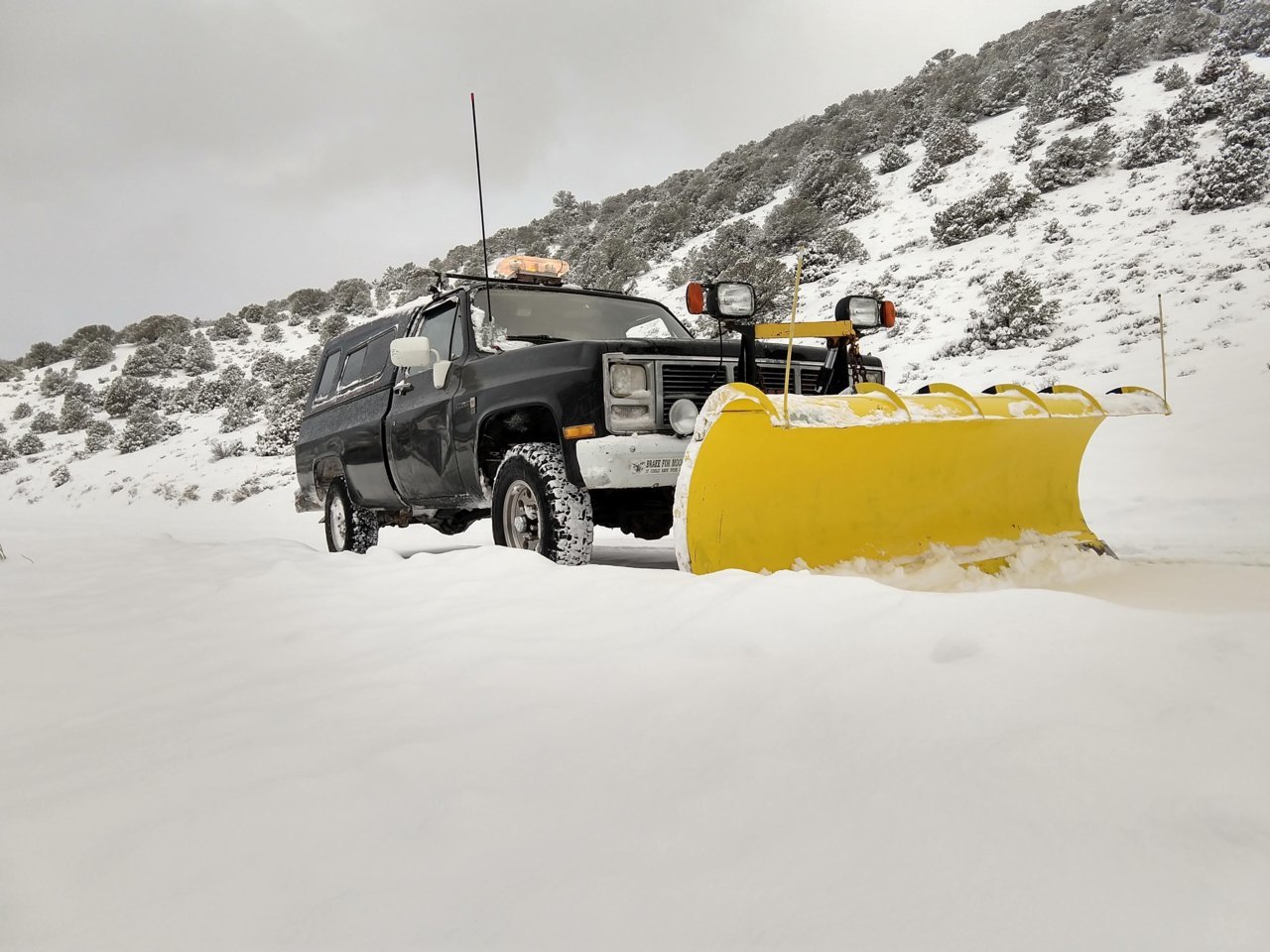

    If you still have the HD, keep using it. I use my 1985 K3500SRW 6.2 Diesel for plowing, dump runs, firewood.

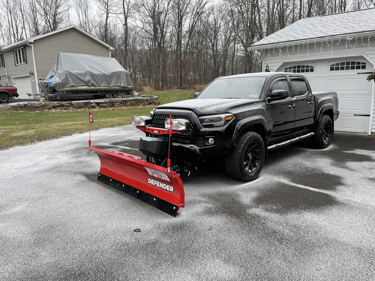

    I put one on my Taco. Only plow my driveway and sometimes my neighbors.

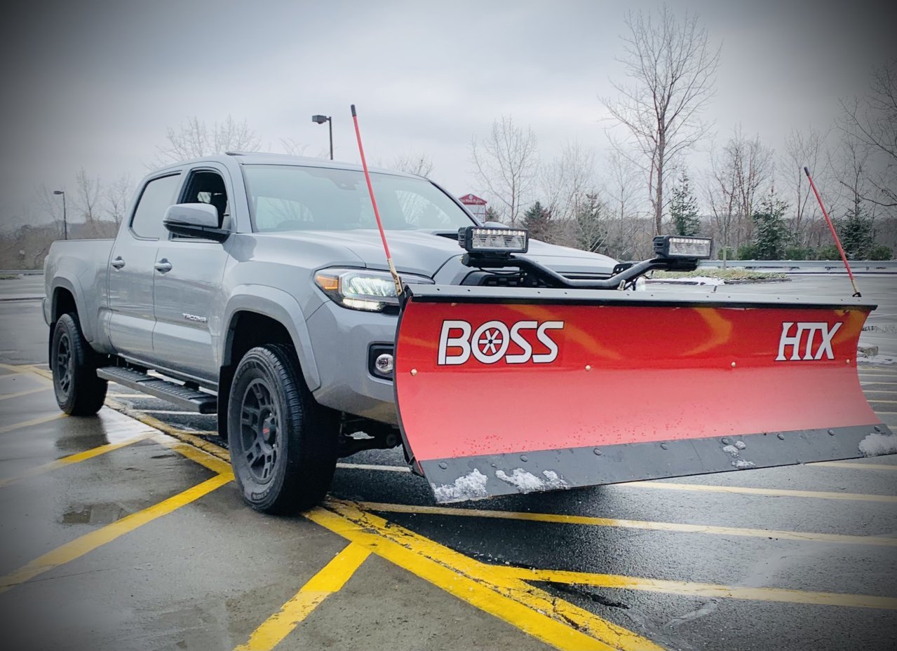

    I just put a BOSS on my new Sport. I’ve plowed with Tacomas for 25 years so Im familiar with the limitations vs a one ton.
    As far as mods, because I generally have 15-20 driveways, I use Timbrens on all 4 corners to help with sag/squat , and Bilstein 5100’s at all wheels. Fronts are set under 2” which levels the truck. The only issue is BOSS hadnt made an adapter for my stock leds , meaning the plow headlights are on a separate switch vs automatically utilizing the factory stalk as I had done with my Fisher plows in the past. I believe a fix is in the works if not already out by now. I keep a few hundred lbs of ballast in the bed and have zero traction issues.
    Ive used Off Roads for plowing in the past, but I wanted a Sport this time around. I’ve had no issues plowing in its first winter. I use the stock wheels with Cooper A/T’s , not the Pro wheels in the picture.8011893A-FE76-47E3-85FC-BB8E3468A7F7.jpg
    If you are only planning on doing your driveway, the Limited will do fine as is.
    Id recommend a “lighter duty” plow setup such as the Western Defender, or the Western Suburbanite, their poly blade plow. Fisher also sells identical versions to these , just in yellow. Those would be the Fisher HS, and Homesteader , respectively. Both versions are available in two different blade widths. 6’8” or 7’3” for the poly blade , and 6’8” or 7’2” for the steel versions. The BOSS HTX plow I have is probably overkill for just your driveway.

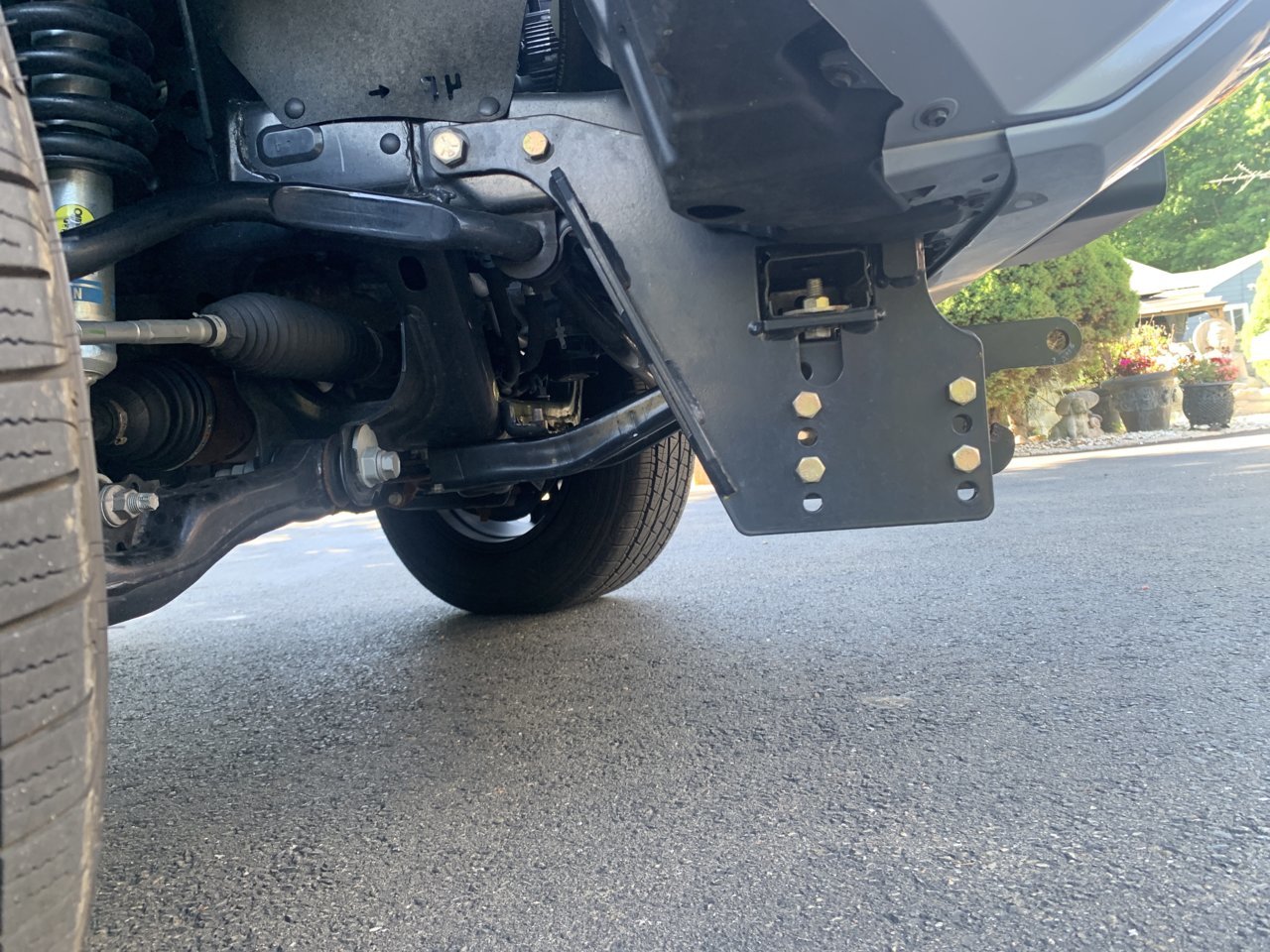

    Lol gotcha. That makes more sense. I know that my plow frame bolts up to the truck frame a lot lower down , so that area you mention doesn’t incur any stress. Its purely connected to the frame.

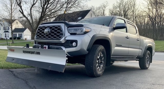

    I installed a front mount receiver and use a Snowsport for my driveway.
