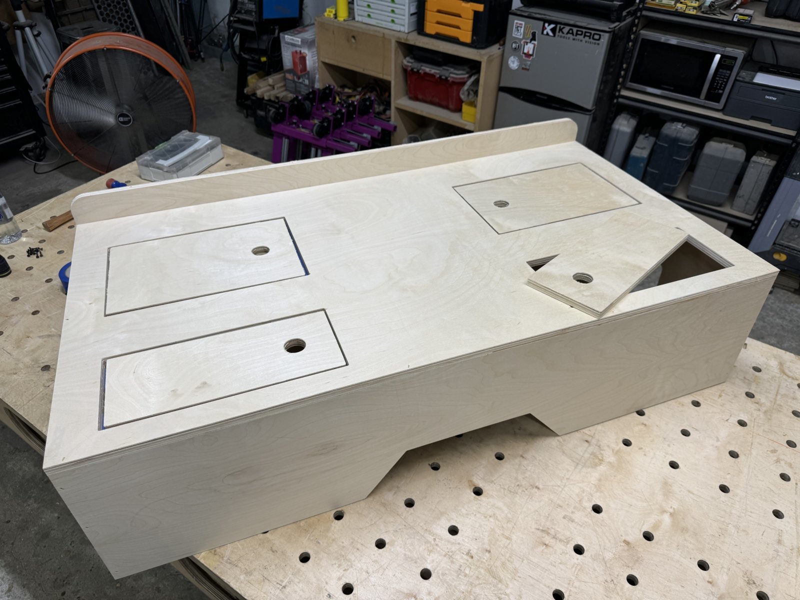

    Looks like I’ll be getting access to a 4th gen double cab in mid July to build a prototype of a rear seat delete. I’m hoping to go to market by the end of July.

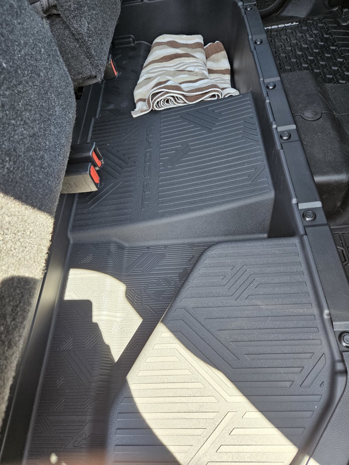

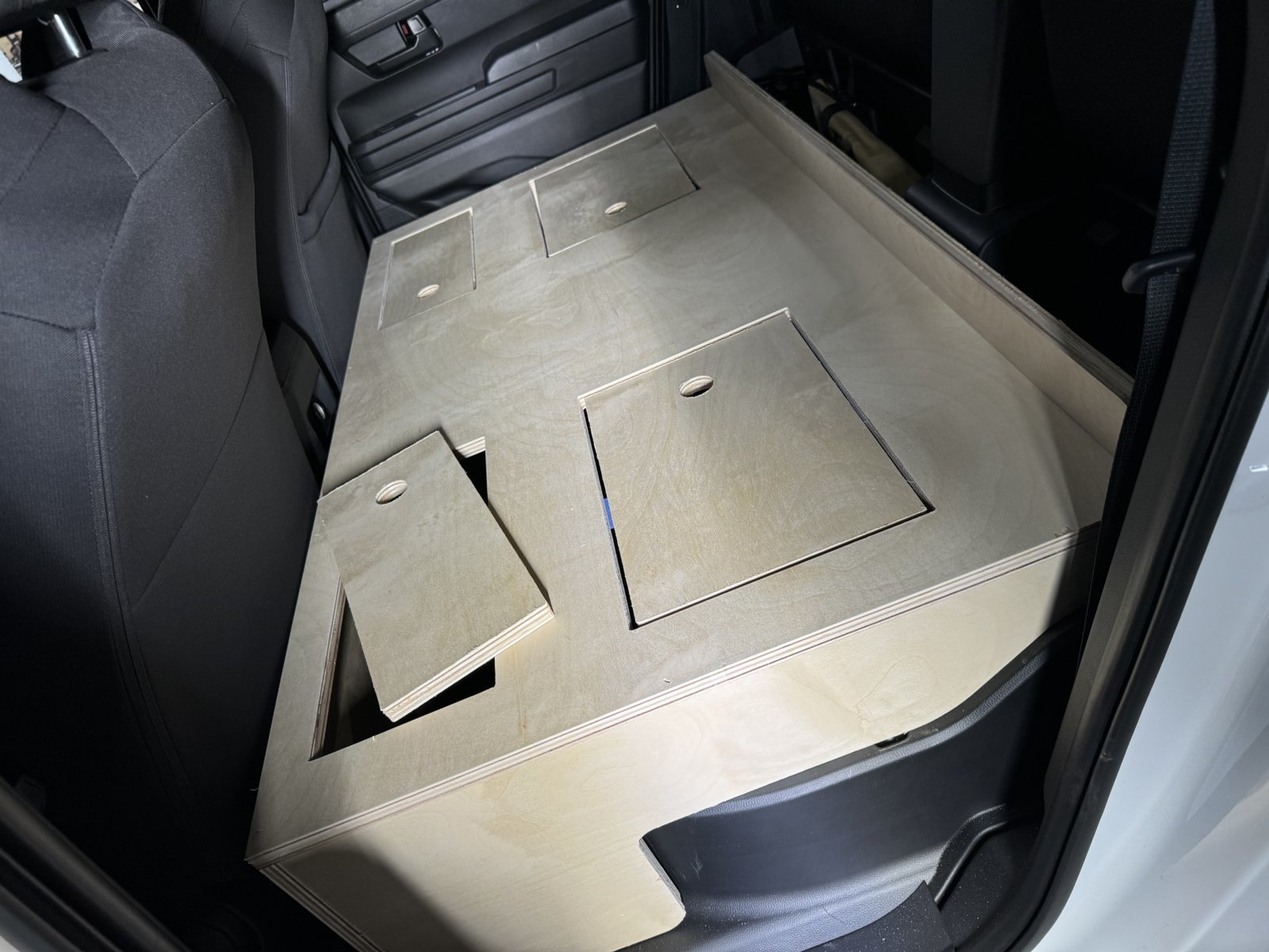

    I got my hands on a 4x2 Gen 4 Tacoma. I didn’t want to like it but I do. The interior is pretty intense. Most noticeably, the rear seat offers a number of complications to contend with when designing a rear seat delete compared to a Gen 3. Thankfully we got it sorted and were able to finalize a design in a few hours.
    NOTE: It appears the under seat storage has different details from model to model but the overall footprint is the same.

    looks really good.
    do you know if it’s the same for a hybrid? I would like to delete my rear seat.

    it most likely fits a hybrid. Can you send me a pic of the area under your rear seats so that I can confirm?
    rough dimensions: 53-ish inches wide x 28ish inches deep x 12ish inches tall

    Strange under the back seats look different then mine

    send me a photo of yours please. is your truck a 4x4? the one i rented was a 4x2

    it's prob the same size but it has a plastic liner if you look close in the bottom left there a little truck as an Easter egg. Also Canadian models sometimes are slightly diffrent. No 2wd available in Canada since 18.20240719_141339.jpg

    yeah im wondering if this difference is due to 4x2 vs 4x4 or us vs canada models. im gonna swing by a dealership today and do some investigation but i am assuming the footprints are the same. that little easter egg is fun.

    I went to a dealership this afternoon and compared the rear seat storage compartments of a 4th gen 4x2 double cab and a 4th gen 4x4 double cab. As the photos above show, they do have different plastic inserts but the foot prints are the same. It’s good news for me as this means the rear seat delete I designed will fit both.
