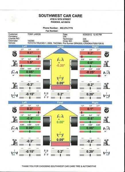

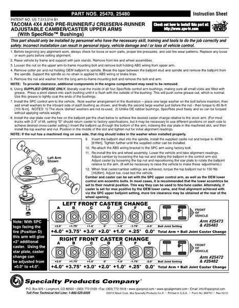

    When I install the LR UCA's should I leave the caster at "0" or should I adjust it myself before going to the shop?
    Here are my current alignment numbers;
    Here are the instructions for LR arms;

    I went to Shumans, had to go to Mesa from central phoenix, so it was on my way. Below are the final numbers. I am running Bilstein 5100's set to 0.85 with OME 8885x and Light Racing UCA.
    What do you guys think about these numbers?

    Front Left
    0.6 Camber
    2.0 Caster
    0.09 Toe
    Front Right
    0.3 Camber
    2.3 Caster
    0.06 Toe

    I have LR's.. and went to Shumans.. and wouldn't recommend them. They aligned them. But I have rubbing at the back of the fender. Went back to explain that they can adjust them more accurately.. and they wanted none of it. So I left. They wouldn't even attempt. So next place I'm going is Network. Just haven't had time lately. Plus, it only rubs when wheeling and the occasional flex through driveways turning.

    I had the same rubbing problem with 255-85-16s after I installed Total Chaos UCAs, I think it is a problem from moving the ball joint with the aftermarket UCAs backward to achieve the needed caster.
    Perhaps they can take a couple tenths of degrees back out to help clear but then you lose the caster needed.
    Kind of a problem and I will be doing cab mount chop soon to solve the rub cause I want the caster, big tires, and a little lift, so this is what I need to do to have all three.

    That's exactly what they do. You lose a little caster to gain clearance at the back fender.
    I also have the cab mount chop done.. it helps with clearance at full lock, but it still rubs the fender, due to the caster. Shumans won't even attempt to look into it. Shame because they did a good job and were friendly.
