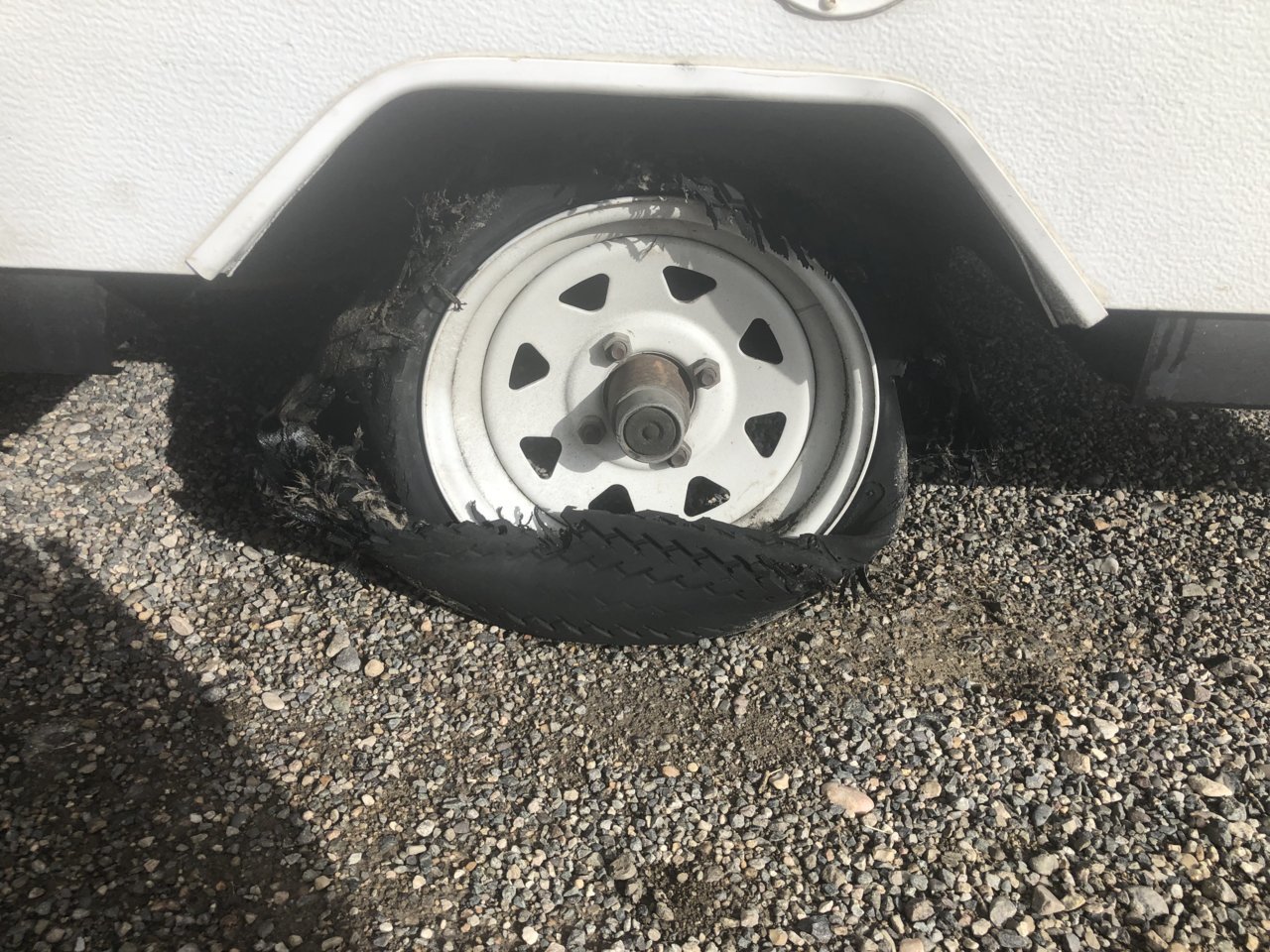

    wondering if anyone was from the Brewster WA area. I had to have a pop up towed and a wheel fixed.
    For about a 45 mile tow, and an hours worth of Labor, I was charged $450.
    Does this seem fair?

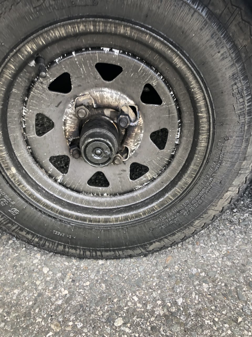

    It's difficult to say with just the one picture, but it looks like the lug holes on the wheel are blown out, which means you need a wheel and a new hub/bearngs.

    Yup, those holes are bigger than some of the aholes floating around here.

    That hub has a bearing-buddy on it. You typically don't repack the bearings. You remove the rubber cover and lube the zerk fitting.

    You repack if you're replacing burn out bearings. But yeah, if they were just replacing/adding grease... you just hook your grease gun up to the zerk and pump until fresh grease comes through. Be sure to spin the wheel while pumping to avoid blowing out the seal.

    Does the picture look like the wheel is junk? It does to me, but the picture isn't the best. I suppose it's irrelevant now anyways...

    Yep, that wheel is scrap metal now. OP said the trailer is now using the spare. However I'm guessing the studs are worse for wear too.

    That's what bugs me. If the guys just repacked the bearings and overlooked the lug stud condition, that blows. Difficult to tell without being on-site.

    He used some grade A bolts as stud replacements
    After some texts today, showing him today’s blowout. He has stayed he will be sending me a check for 150, thus making the tow and work 300, which I am in agreement as fair.
    The wheel was toast, I used the spare. Today I picked up 2 new wheels with tires already on at tractor supply.
