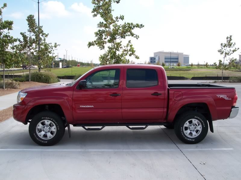

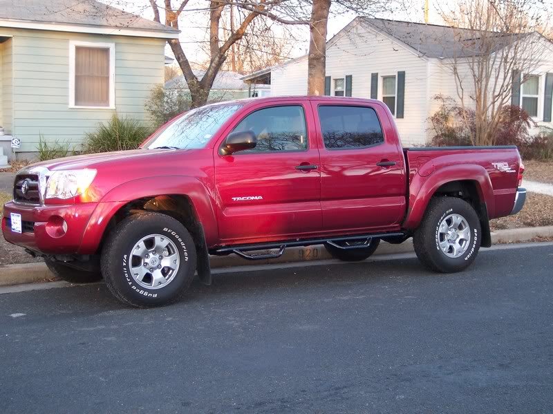

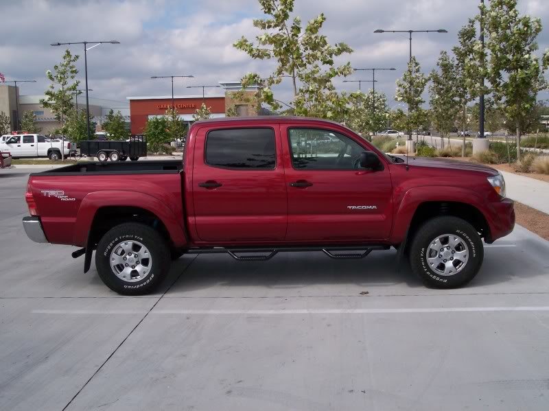

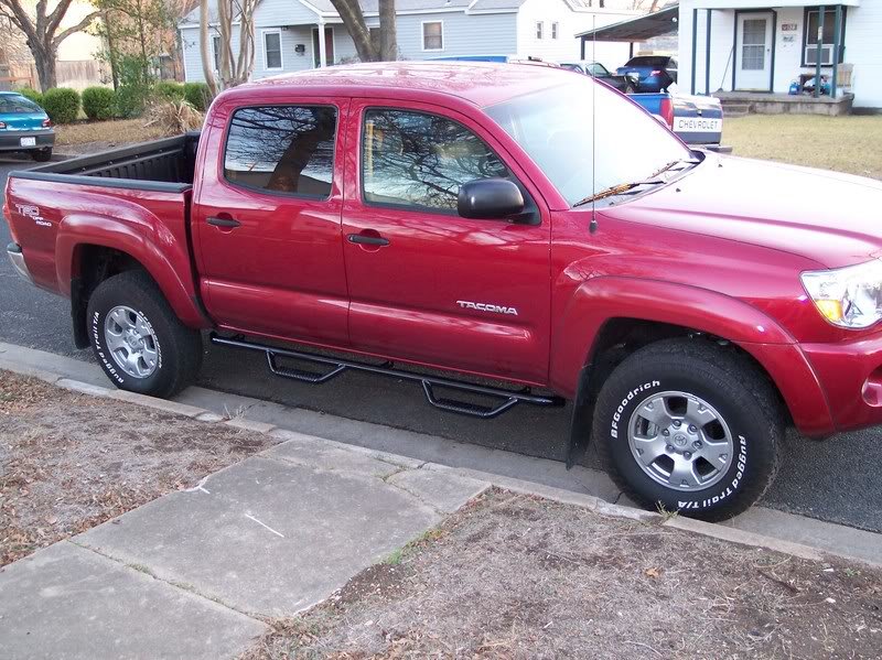

    Here are some comparison pics of my Eibach/Bilstein lift completed today:
    Before rear leaf TSB and front lift:
    After:
    After:
    Set the Bilsteins at "0" and put in a 1/4" spacer on the driver side to combat Taco lean. Seems to have worked out well- leveled out the truck with just a slight rake. The ride is fabulous, firm but not harsh. Can't wait to get my rear Bilsteins installed!
