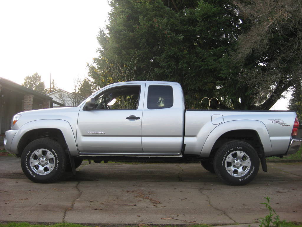

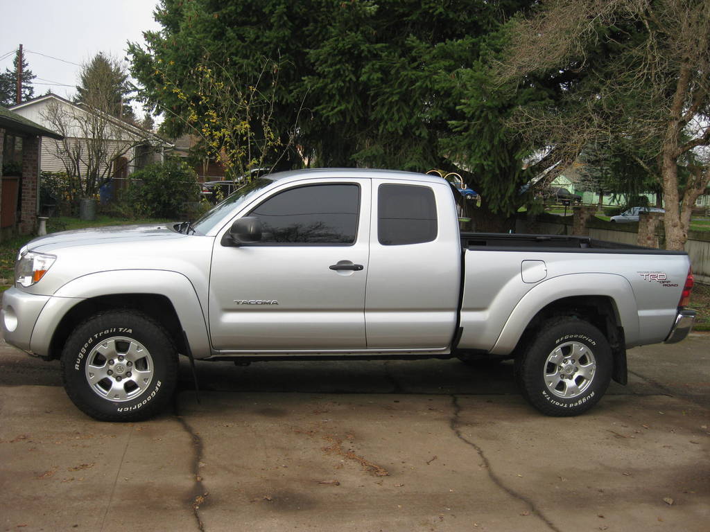

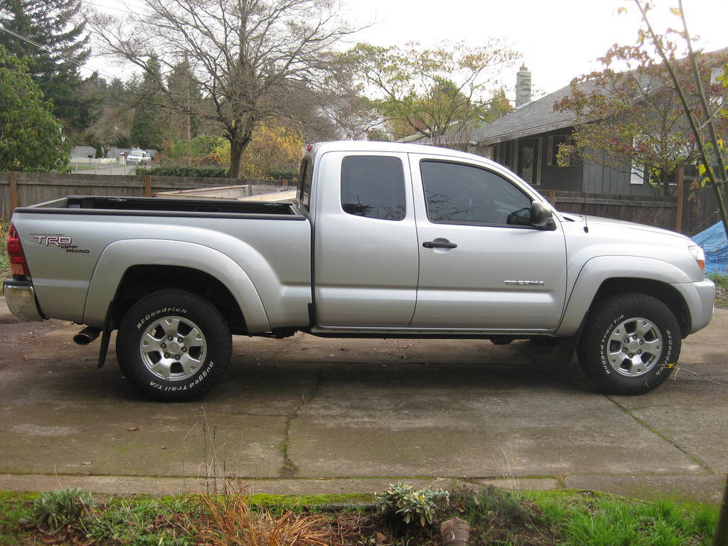

    just finished my install,
    Eibach 1.6 springs with 5100's set @ .85 in the front, rear is stock with 3leaf pack. My TSB new leafs will be installed by Toyota Friday morning :D
    Before-
    After-
    Before -
    After -
  8. Nov 24, 2009 at 6:37 PM
    #48
    oldtacomaguy
    oldtacomaguy four forty four
    Dec 11, 2006
    #444
    10,032
    Dave
    SE Conn.
    08 SR-5 4WD Impulse Red Pearl
    Alpine deck and amp, Polk speakers front and rear, Kenwood subwoofer, windows tinted to 20%, Sockmonkey decals, TSB, Eibach springs and Bilstein 5100's
    Looks great, I'm really bummed I didn't have the cash for the group buy. This is the settup I'm going with, but I'll end up paying more for it...:mad:
