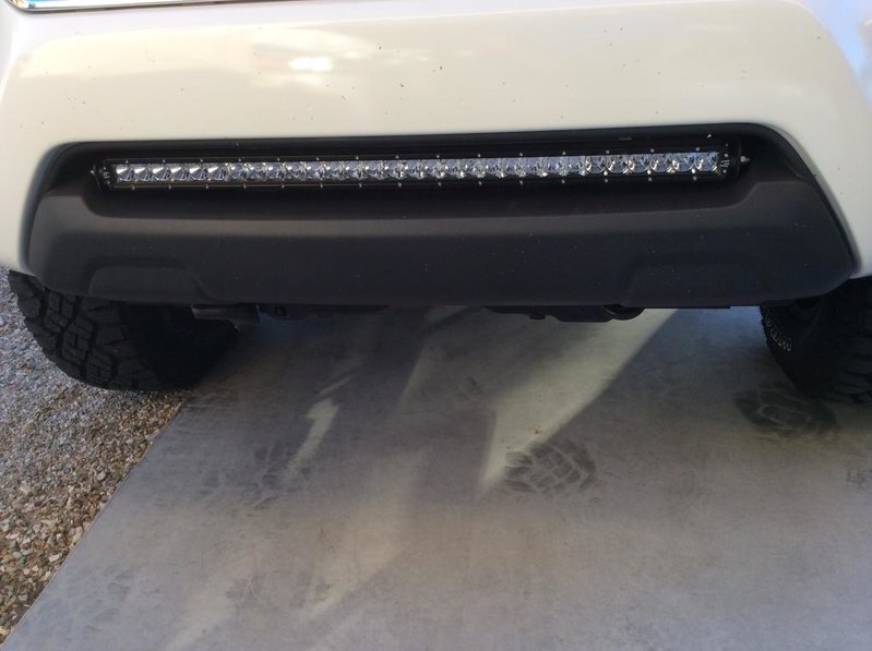

    where do these actually mount to? i just ordered and looking at bumper i cant see where they will bolt on.
  4. Feb 27, 2014 at 11:07 PM
    #24
    JustinL
    JustinL Well-Known Member
    Jan 31, 2011
    #50299
    3,756
    Justin
    Berlin, CT
    2009 TRD OffRoad DCSB Pyrite Mica
    2012 Conversion
    If you look inside the lower bumper grill to the sides you will see the aluminum crash beam. Each one has 4 bolts total - each bracket mounts to 2 of those bolts.

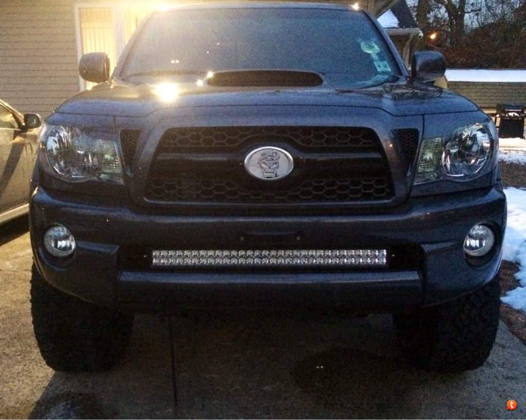

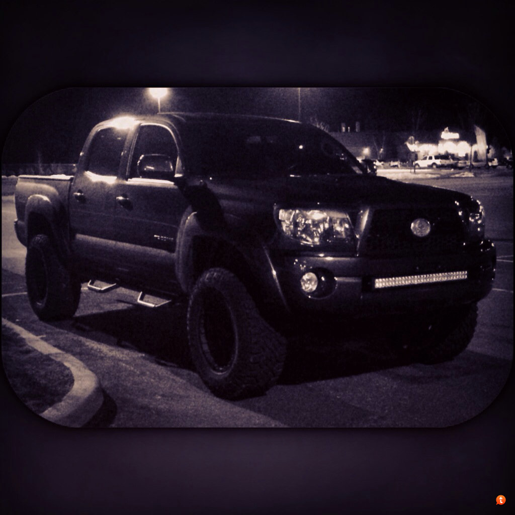

    Nice worked out well Ty.

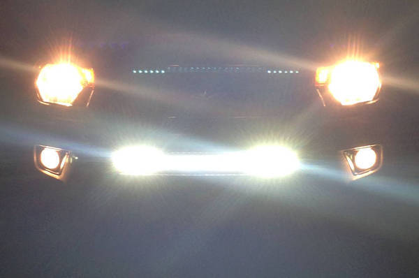

    Installed the Rigid Mounts and 30" SR light bar. Kinda a pain in the ass as one of the mounts had to have the holes elongated. It was drilled off just about 2mm. The wiring took some extra time too. I ordered the switch that matches the rest of the switches in the truck. Since it's an Offroad truck the only switch location I had available was above the center console. Co to access that I had to remove the entire center console. Then I use the Bright lights to enable the circuit through the relay. Took a little time and some Forum help to get it right.
    Front view
    Lights on Bright no LED or fog lights.
    Lights on bright with LED bar.
    Lights on Bright w/LED bar and Fog lights.
