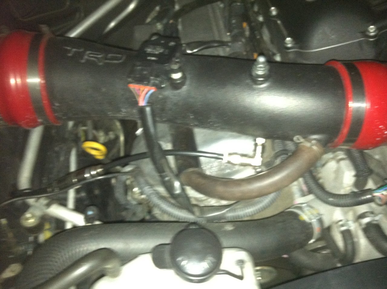

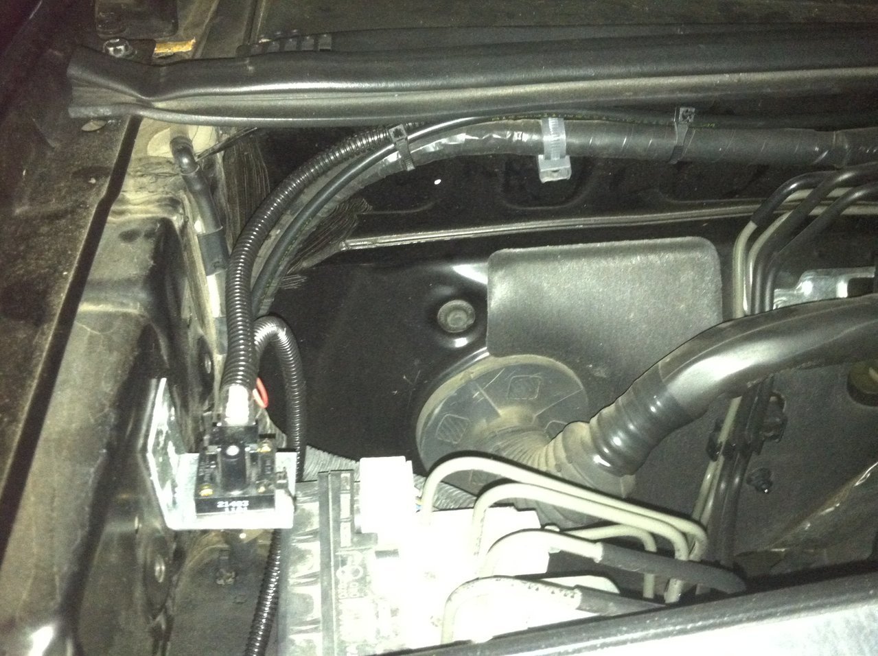

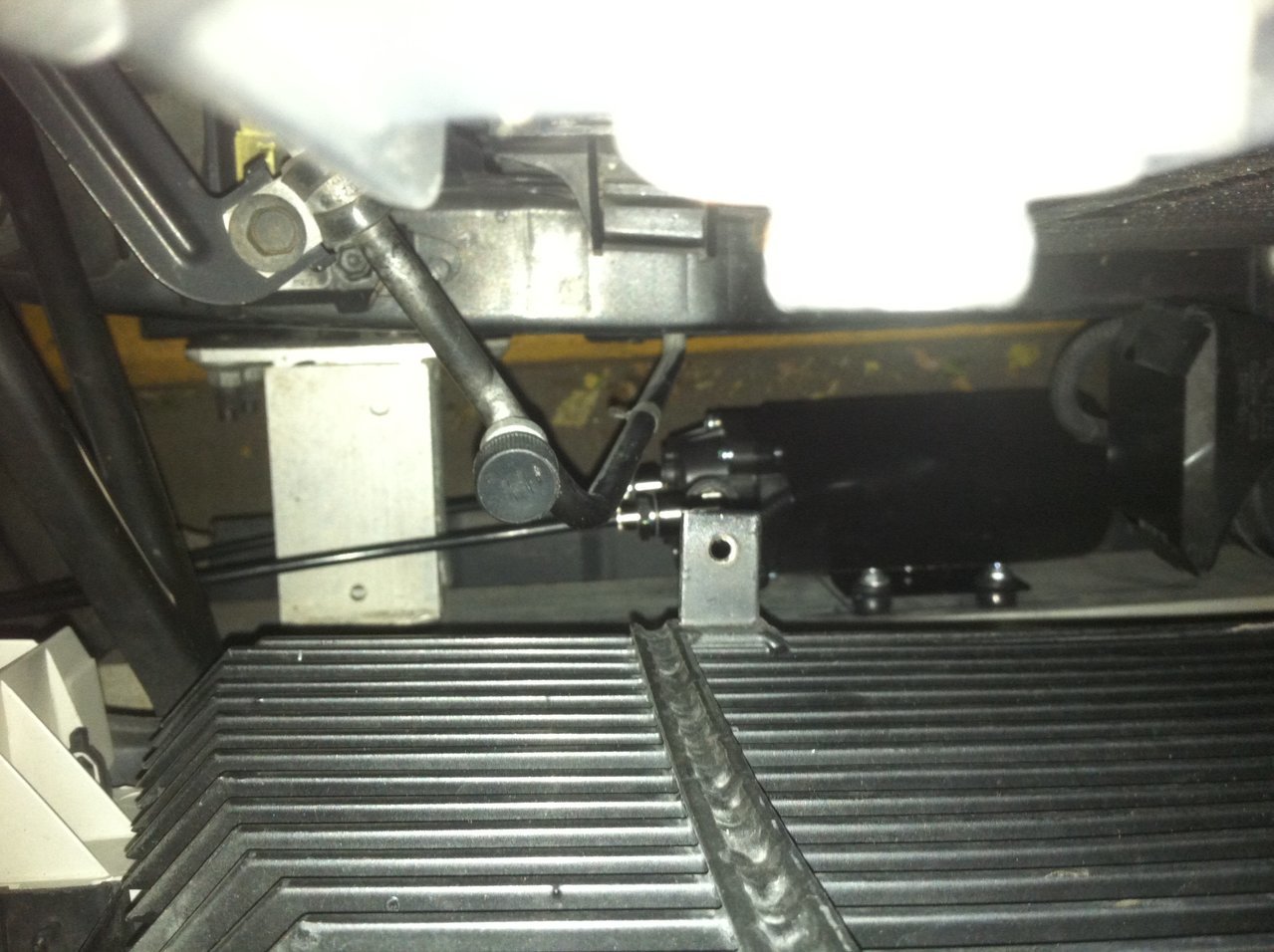

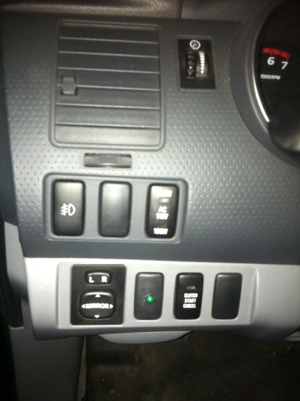

  16. Feb 16, 2018 at 10:04 AM
    #16
    TRON
    TRON Well-Known Member
    Mar 4, 2009
    #14317
    1,491
    All Wheel Drive X-runner
    TRD Blower, 2.3 Pulley, NST OverDrive Pulley Kit, B&M Shifter, TR Lowering Kit, Spec Clutch, Xrunner Body Kit
    I used the washer fluid reservoir as the tank being extra stealth. Here some pics... So the second picture is a boost controller. You can adjust it to turn on and spray at what boost you desire. The green LED light would turn on when spraying. So little trial and error to get it to spray right before peak boost. I bet the ovtune could eliminate some of this but thought to share for people having a stock ecu
