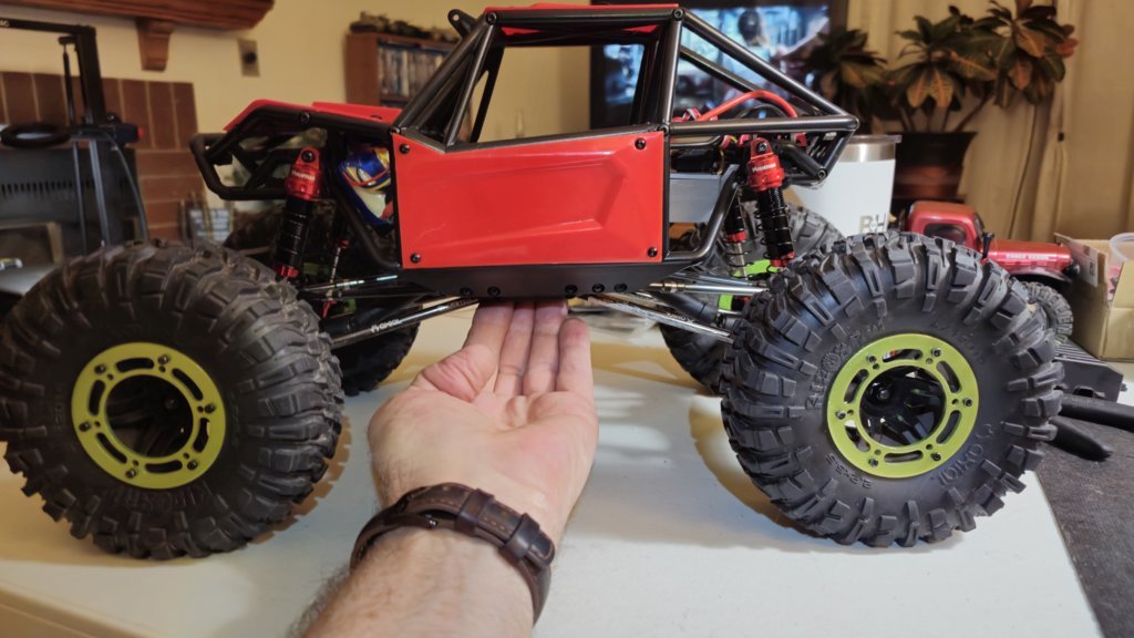

    Progress on the UTB. Apologies in advance for the long post.

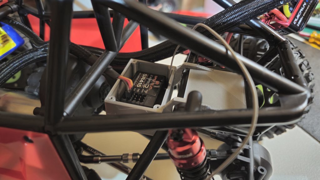

    Printed a box with a perch for the RX and ESC.
    new wheels with red, silver and black on the way.
    For now the 5.5's off the AX10. I have some 5.0's that might be a better fit.

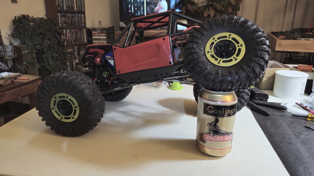

    Although, These may become the tire. They just seem to fit so well and still have full turn. Plus the extra weight keeps it upright. There's a full wrap of tire weights on each one.
    drooped. Had to cut one coil out of the springs to get this and heat up the end to restore the circle.
    3s, 2200mah up front and kind of high. Seems ok for now, hasn't really exhibited any tippy signs. I think I may put a pair of 1300mah 3s down inside on either side of the motor/trans and run parallel to lower cog.
    Remove the strap and the ESC/RX come off as one and give access to the spur cover.
    12oz of flex.

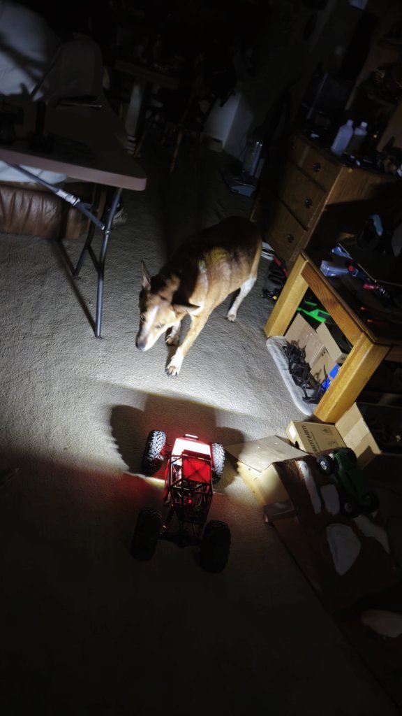

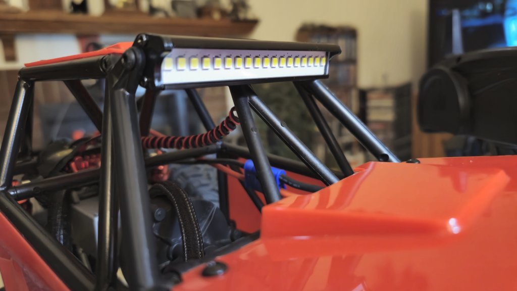

    Light bar. Fucker gets hot. Running it off the program port on the ESC at 6v so I can unplug it.
    lights out in the room.

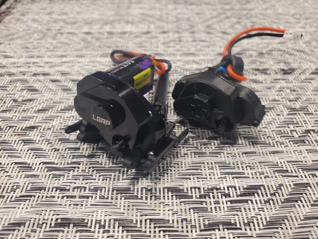

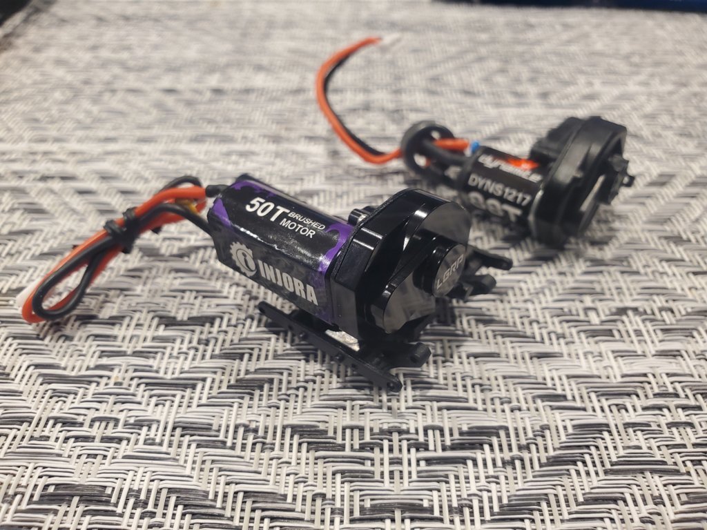

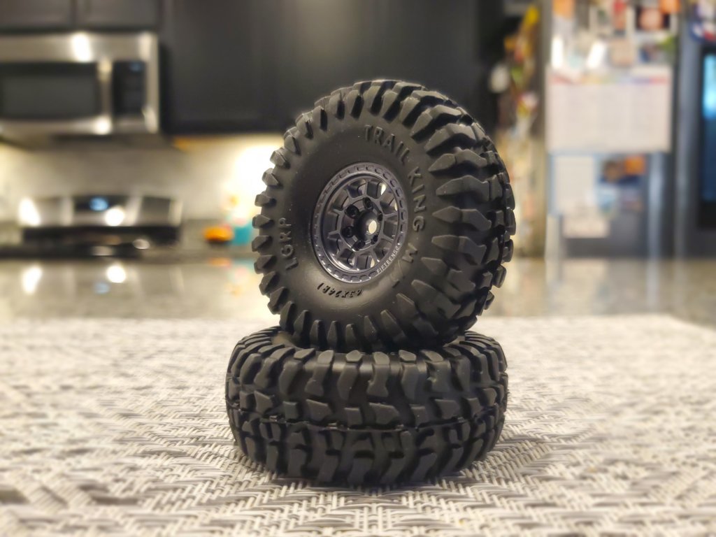

    Injora brushed motor arrived!
    Quite the upgrade from stock.
    It's louder, but has noticeable torque when climbing stuff. I didn't have to bump it going over the "crossbar" on my kid's highchair.
    So far she's got Injora Prosteer axles, Injora 50T brushed motor, and LGRP HD transmission.
    Definitely don't need to do any more upgrades, it was just fine in stock form :rofl:

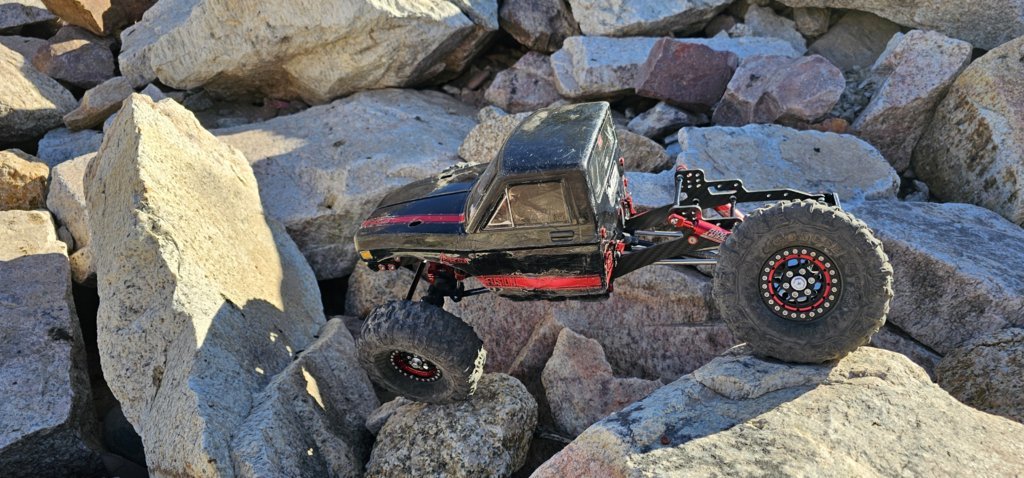

    Ran the Mojave grom for a bit outside. Cant get more than 50%throttle on the ice. The servo got jammed with snow and I didn't last long with 5 degree temps. Worried that if it did hook up and hit something it would shatter with the cold brittle plastics. I wish arrma had a blx grom monster truck with a bit better clearance and taller tires

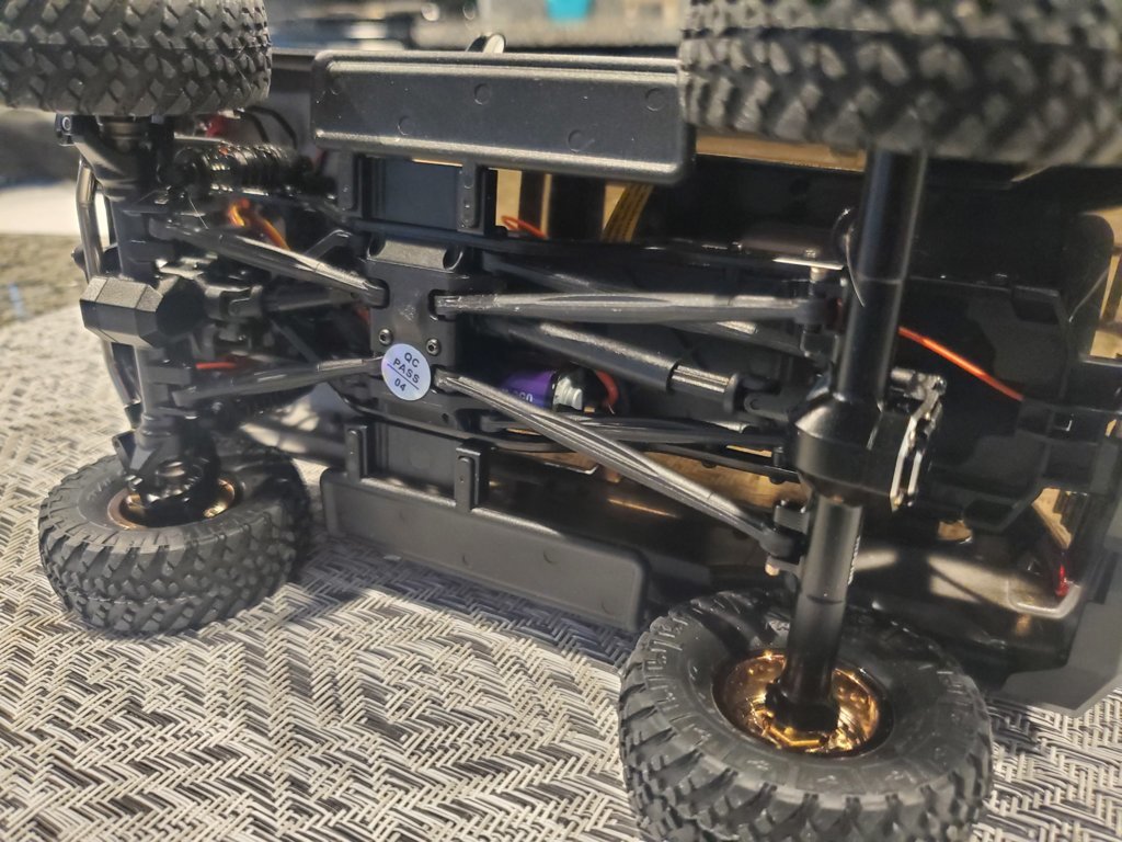

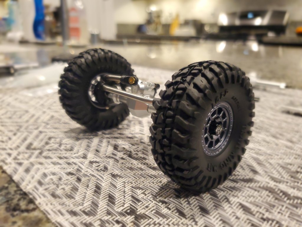

    I semi-put together the axles.
    Mainly just installing the upper rear link mount, and swapping the hexes.
    Wheels look even better on the axles.
    I'll finish up a few more things come tomorrow.
