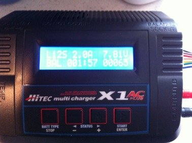

  6. Feb 7, 2012 at 11:03 AM
    #2006
    SACTOWN
    SACTOWN Well-Known Member
    Jun 7, 2009
    #18143
    29,843
    Greg
    So does that look right?!?
    I followed the direction. First time charging/balancing a lipo
    Should it be at 7.8? when it is a 7.4?
  7. Feb 7, 2012 at 11:14 AM
    #2007
    t4daddy
    t4daddy Well-Known Member
    Jun 16, 2010
    #39041
    7,455
    North Alabama
    2008 PreRunner Double Cab
    I'm not familiar with that charger, does it balance, or balance charge? The cells can be balanced (equal) at any voltage. What looks strange to me is the time showing, or, is it still running?
  8. Feb 7, 2012 at 11:15 AM
    #2008
    SACTOWN
    Jun 7, 2009
    #18143
    29,843
    Greg
    Balance charge
  9. Feb 7, 2012 at 11:25 AM
    #2009
    t4daddy
    Jun 16, 2010
    #39041
    7,455
    North Alabama
    So, was the battery already charged when you selected to balance it. The minute fifty-seven seconds is what I'm wondering about.
  10. Feb 7, 2012 at 11:26 AM
    #2010
    SACTOWN
    Jun 7, 2009
    #18143
    29,843
    Greg
    It shouldn't have been. I used it yesterday
  11. Feb 7, 2012 at 11:28 AM
    #2011
    SACTOWN
    Jun 7, 2009
    #18143
    29,843
    Greg
    Oh I think it balances and then it chargers. Maybe thats it
  12. Feb 7, 2012 at 11:33 AM
    #2012
    t4daddy
    Jun 16, 2010
    #39041
    7,455
    North Alabama
    It may very well, I'm not sure. In your pic is the charger still running, or has it completed it's cycle?
  13. Feb 7, 2012 at 11:35 AM
    #2013
    SACTOWN
    Jun 7, 2009
    #18143
    29,843
    Greg
    It is balancing. I thought it was Supposed to balance and charge at the same time. At least that is what the book says
  14. Feb 7, 2012 at 11:35 AM
    #2014
    Tacomanator
    Tacomanator Well-Known Member
    Jul 25, 2010
    #40746
    4,613
    Clam Slammer
    Southern Cali
    King 2.5" extended travel coilovers with compression adjusters, Camburg UCA's, King 2.5" rear shocks, TRD 1st gen CAI.
    A fully charged 7.4v is actually 8.4v. How many mah is the batt?
  15. Feb 7, 2012 at 11:45 AM
    #2015
    Tacomanator
    Jul 25, 2010
    #40746
    4,613
    Clam Slammer
    Southern Cali
    Balancing and charging are essentially the same thing. When you "balance" a lipo, you are charging each individual cell to 4.2v. You can't balance without charging is pretty much what i'm getting at. However, you can charge without balancing.
  16. Feb 7, 2012 at 12:06 PM
    #2016
    SACTOWN
    Jun 7, 2009
    #18143
    29,843
    Greg
    5000mah
  17. Feb 7, 2012 at 12:06 PM
    #2017
    t4daddy
    Jun 16, 2010
    #39041
    7,455
    North Alabama
    Acually you can balance with out charging, by using a blinky, it discharges the highest voltage cell/cells to the lowest ones' level in the pack. Doesn't even need to be connected to a charger. These were the first balancing tools, before the chargers had the built in feature. But yeah, for the most part, all newer chargers are charging up the lower voltage cell/cells, instead of discharging the highest ones.
  18. Feb 7, 2012 at 12:11 PM
    #2018
    SACTOWN
    Jun 7, 2009
    #18143
    29,843
    Greg
    It is at 8.4v on the number at the left is at 1.3a and raising.
  19. Feb 7, 2012 at 12:12 PM
    #2019
    SACTOWN
    Jun 7, 2009
    #18143
    29,843
    Greg
    Sorry guys but thanks. Those directions are kind of difficult and miss leading for a noob with lipo
  20. Feb 7, 2012 at 12:19 PM
    #2020
    t4daddy
    Jun 16, 2010
    #39041
    7,455
    North Alabama
    You only have to balance ever 5-10 times you cycle the battery. I balance every five cycles (as I've stated, I'm sure this is way overkill).
