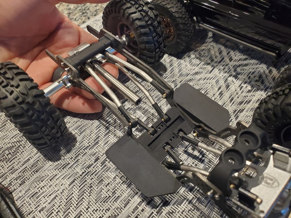

    Thanks! The front brace definitely can't be installed if going motor foward. As it sits I have no binding but we'll see how it is after I have the servo in. Already checked with motor/trans in with driveshafts. So far so good

    Forgot I had that winch servo I bought by mistake so I threw that in for clearance purposes since it's essentially the same dimensions as it's steering counterpart. Clearance is good. Shocks bottom out before the servo hits the magnet mount. Only issue is the front magnet mount contacts where the wires come out of the servo preventing full compression on the driver side. Easiest/quickest fix would be to move the mount back and have the front shocks and magnet mount share a hole. I'll have to wait for my body and see where the mount will actually need to sit

    Does your servo tray have much adjust ability?
    Mine does, so I'm not too worried there.
    It was when I tucked the rear upward that the bend in the rear links would collide with the tray you've got installed. Granted I didn't install my shocks so maybe those will limit my uptravel?

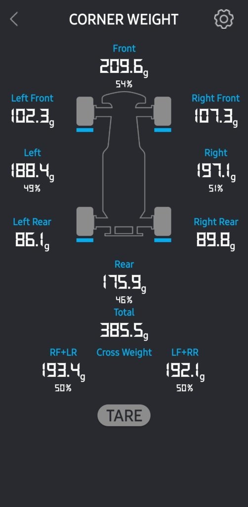

    Motivation to get creative with my ir60 body lol.
    On another note I thought this was a pretty good base line. Once I have the all the electronics on it'll add more front bias. Thought about getting wheel weights for the front to get that "magic" 60/40 everyone talks about but looks like I might not need em.

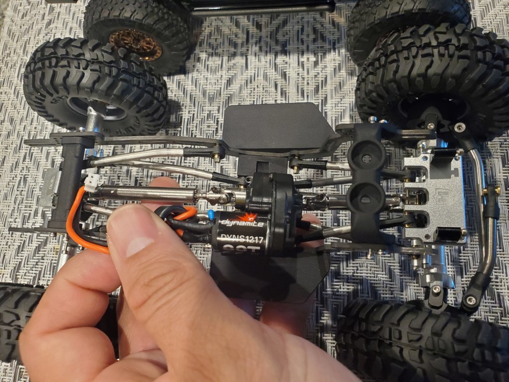

    One thing I'm not super stoked about is the rear driveshaft angles due to the angled skid. I can post some photos when I'm home from work. Unsure if it will be an issue or not

    So my picture didn't show it well but I did have the slip yoke hanging off the axles.
    I think we should be good?

    Wait till you see what it looks like with the trans in. You can already see how angled up the output from the trans is gonna be. Angle only gets worse the further the rear droops out.
