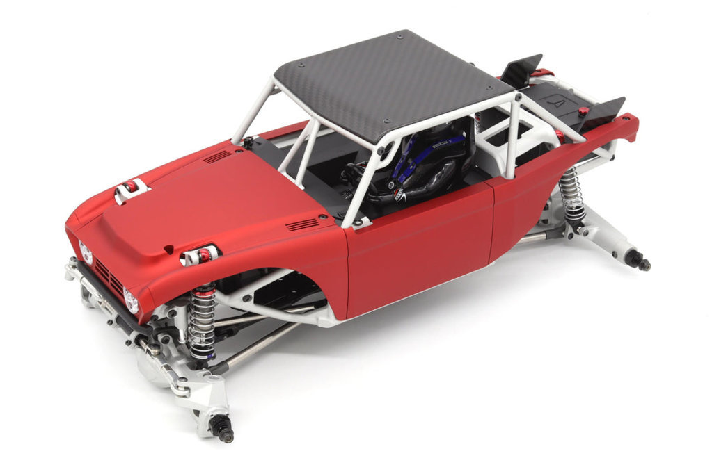

    See, there's another reason I wish I could still do small 1/24 size! I pay 20 to 30 percent more for parts, and they don't look that good. I did see some Dlux axles that burned an image in my mind that looks similar but they're priced about as high as some Vanquish RTR.
    Did anyone buy one of first rounds of these?
    https://vanquishproducts.com/products/h10-origin-kit
    VP_Origin_RED_3Qtr_Overhead_Shot_3500x2333_9d2fea9d-d200-4b57-bf4b-cb9f8a0907e7_1066x.jpg
  5. Jan 24, 2025 at 6:20 AM
    Deathbysnusnu
    Deathbysnusnu Work is just a daily detour to happy hour.
    Oct 4, 2013
    #113825
    17,370
    Brett
    Fort Crawlins, CO
    Vintage Tundra
    Dog, camper.
    It's interesting the guy on the island is getting his stuff before the guys on the mainland...
    That thing looks sick af. :drool:

    At $3500 I'm buying dual cases for my 1/1 :rofl:

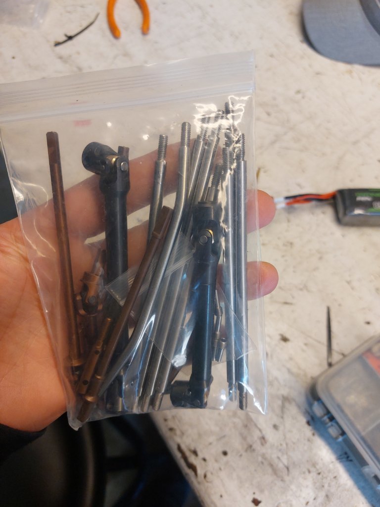

    Naw I have 200$ into my ascent 18 and its plenty of fun on that level and no need to spend more on that scale IMO, the 1/10th is so much more bang for the buck.
    Speaking of the 1/10th, Got my set of backup links/driveshafts/half shafts and stub axles yesterday. This will go in the RC box that comes with me on bigger trips, I have a little fishing flip lid container (2x4x6in ish out of focus bottom right) that goes in the backpack for various hardware for trail repairs.
    Gotta love aliexpress everything pictured was like 40$
