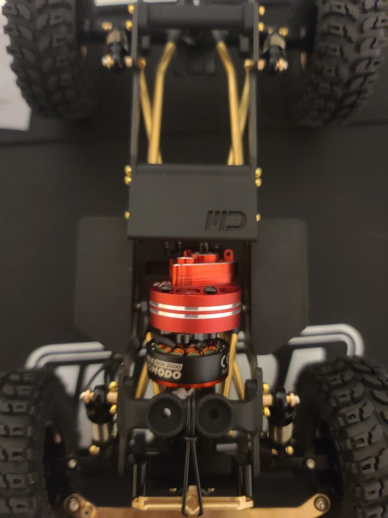

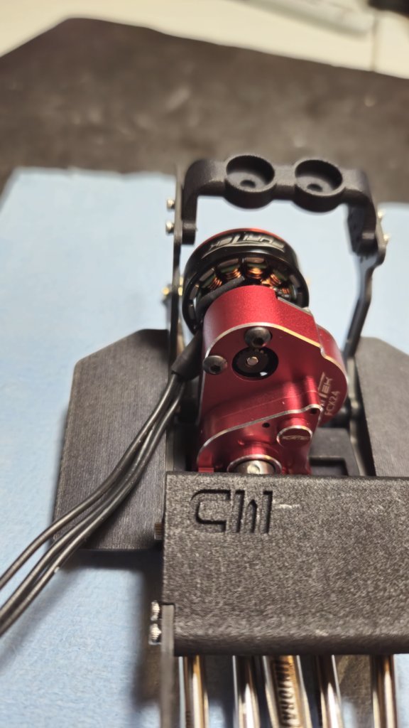

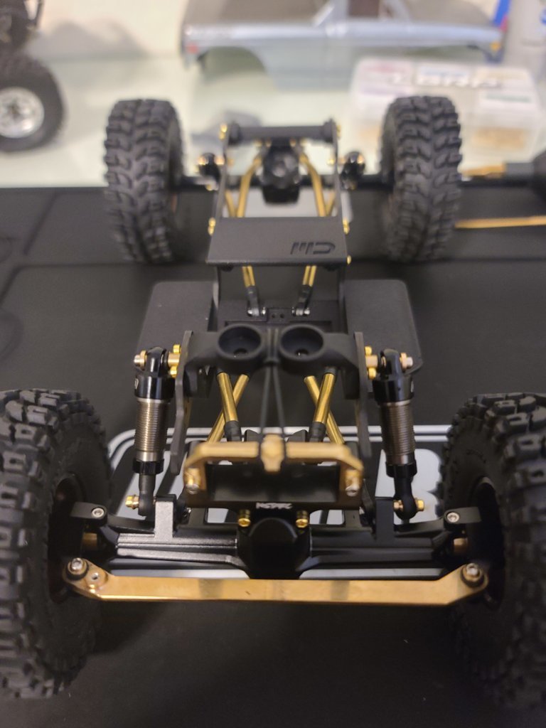

    So, my hardware got here.
    Was stoked to finally get it together...
    Only to have issues mounting my motor? It rubs the frame ever so slightly :annoyed:

    Are you moved over all the way? There's 2 different positions

    There's only two positions, and yes I'm on the left set as you're looking at it.
    I had just the transmission mounted up earlier today using the same holes.

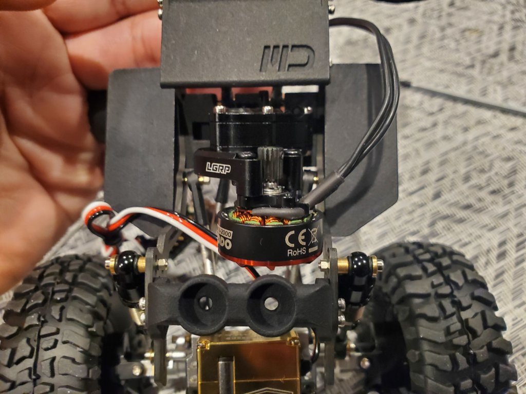

    Dam dude. I got clearance around my komodo. Probably the trans to motor mount is slighter further over on the lgrp trans. I can go in either sets of holes and still be fine.

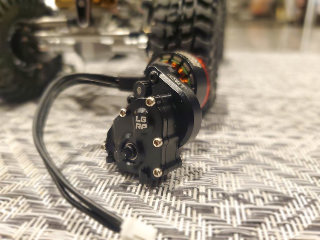

    This is in the left set of holes with the front of the truck up

    It's my transmission.
    Fucking shit, spent $90 on two different LRPs and now this.

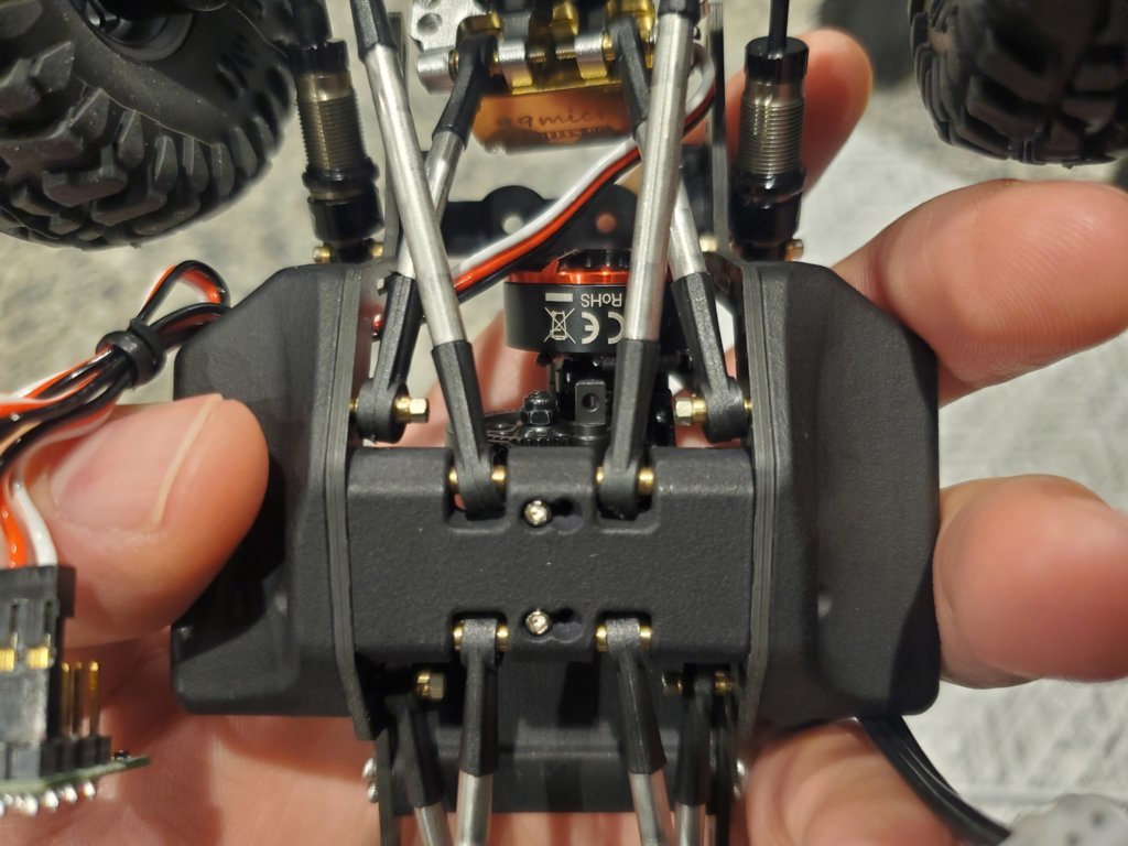

    Mine is also tight to the frame. Don't know what it's gonna do until it's on a suspension and flexes.

    After a second look it looks like @Deathbysnusnu has a fcx trans while I have an scx trans

    Good catch, I just saw that with the laser etching.

    Well, I just placed an order for the Furitek Micro Kumodo.
    It's half the width practically, and it's what Joey suggested as I posted asking on the Mazz page.

    I was gonna go micro but I saw complaints of it hitting the front links which is why I went mini. I'd look into that

    The way Tyler made these links, it's supposed to add extra clearance.
    I flex my setup as much as I could and even with the larger Mini, the links don't come close.
