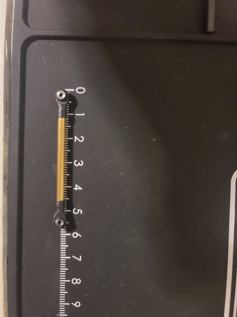

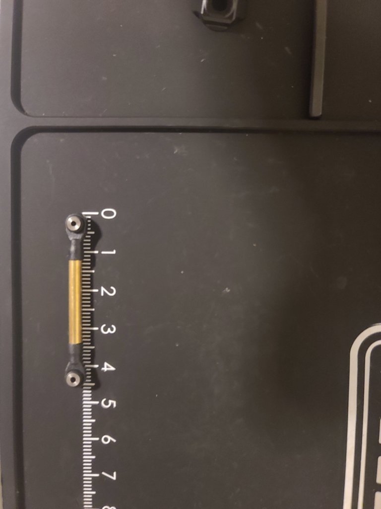

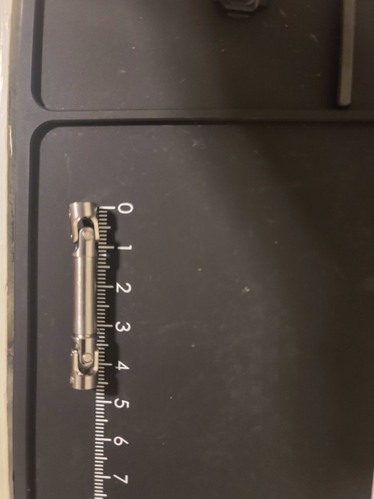

    Removed my front lower and upper links to get some measurements. Hit up seller for some guidance and to verify I was sent the correct links. Will post back when I hear anything
    Lengths
    Front lower: 57mm
    Front upper: 45mm
    Front driveshaft: 45mm

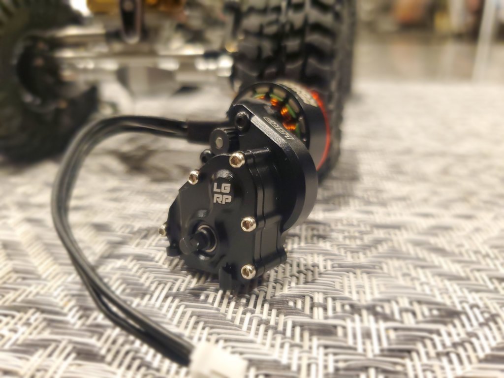

    Are these motors out runners?

    We have out runners. The outside shell spins rather than internally

    Looks like I can use at most a 40mm length front shaft. Found out if I back mount the motor and trans the driveshaft works. I believe that's how they are on a factory scx24 platform? If so that explains the discrepancy. I'll need a shorter front shaft. Should be here Monday

    Soooo, I busted out these "gladiator length" o hoke driveshafts I forgot I had. The black ones. And sure enough the front measures out at 40.5mm. It fits!!! Just hooked up power to motor. No binding through entire travel! We're back in action!!!!
