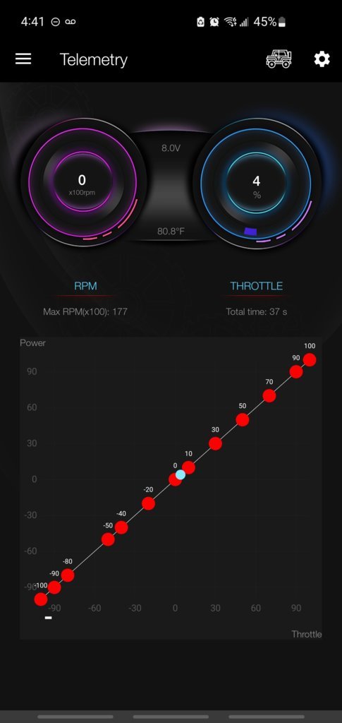

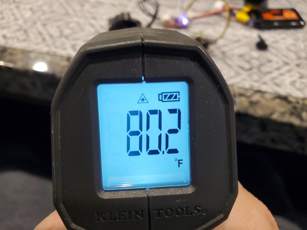

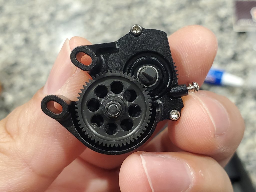

    I ran the LGRP and Mini Kumodo for 30 seconds at full throttle, then let it cool down a bit. This was just to "get things going".
    After which, I put my throttle limiter to 75% and ran it at 1,770rpm for 30 seconds straight.
    Furitek app stated 80.8 F
    My infrared thermometer was damn close to that; I blame any small deviations to the surface coatings on the motor
    And yeah, it felt cool to the touch.

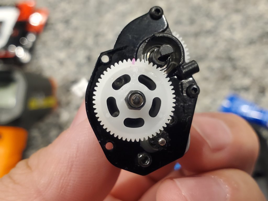

    The Mini Kumodo in front of me has a 16T pinion, so I wonder what spur gear guys like @Deathbysnusnu and @Strictlytoyz are running.
    I have a stock SCX24 transmission I don't mind taking apart to check.

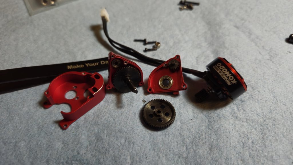

    I have no idea what I have, or if what I ordered to fix it is right. It's a Stellar transmission with the Furitec FCX24 motor mount and Mini Komodo.
    What I have coming is the Furitec SCX24 motor mount for the Mini Komodo, and it's supposed to fit the Stellar transmission.
    It also requires a different pinion and spur, SCX24 specific.
    The mount and gear set come as a complete set, but it's sold out.
    The mount by itself is available. There is more than one to choose from, crossing fingers I got it right.
    The gear set is available separately. Same situation as above.
    I had 14 windows open this morning from different vendors and Google searches comparing part numbers and pics trying to get it right, at this point I'm just waiting on stuff to show up and see what happens. :notsure:

    So, per Furitek's website the FCX24 variant of the Mini comes with the same 16T pinion gear.
    I'm betting the spur gear is the same; open her up and get a tooth count!
    Edit: The Stellar transmission with the Micro comes with a 55T spur gear. I can't confirm the pinion gear size though as it doesn't advertise it.
    However, when the Micro is sold by itself, it comes with an 11T pinion. Which makes sense if that's the pinion used in the transmission/motor combo.
    My thoughts are, the reason for the higher tooth count on the Mini is because the motor spins a lot slower in general compared to the Micro.

    Pinion size is not my issue. I have one on the motor and one on the way, both are prolly different tooth count.
    The spur is a different size from SCX24 and FCX24.
    You can see where the difference in the mount right where the etched lettering is.
    Both pics show what appears to be the same pinion.
    The 12T I have coming just happens to come with the spur.

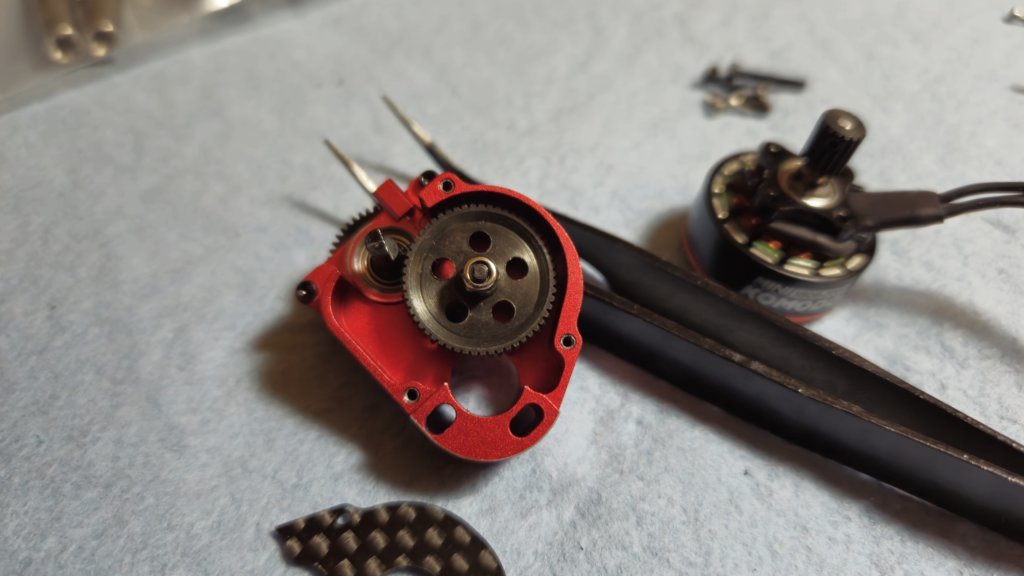

    you got me curious. Opening it now and will report back.
    Kwikvette[QUOTED] likes this.

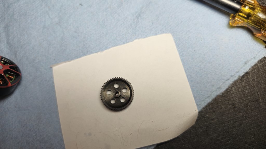

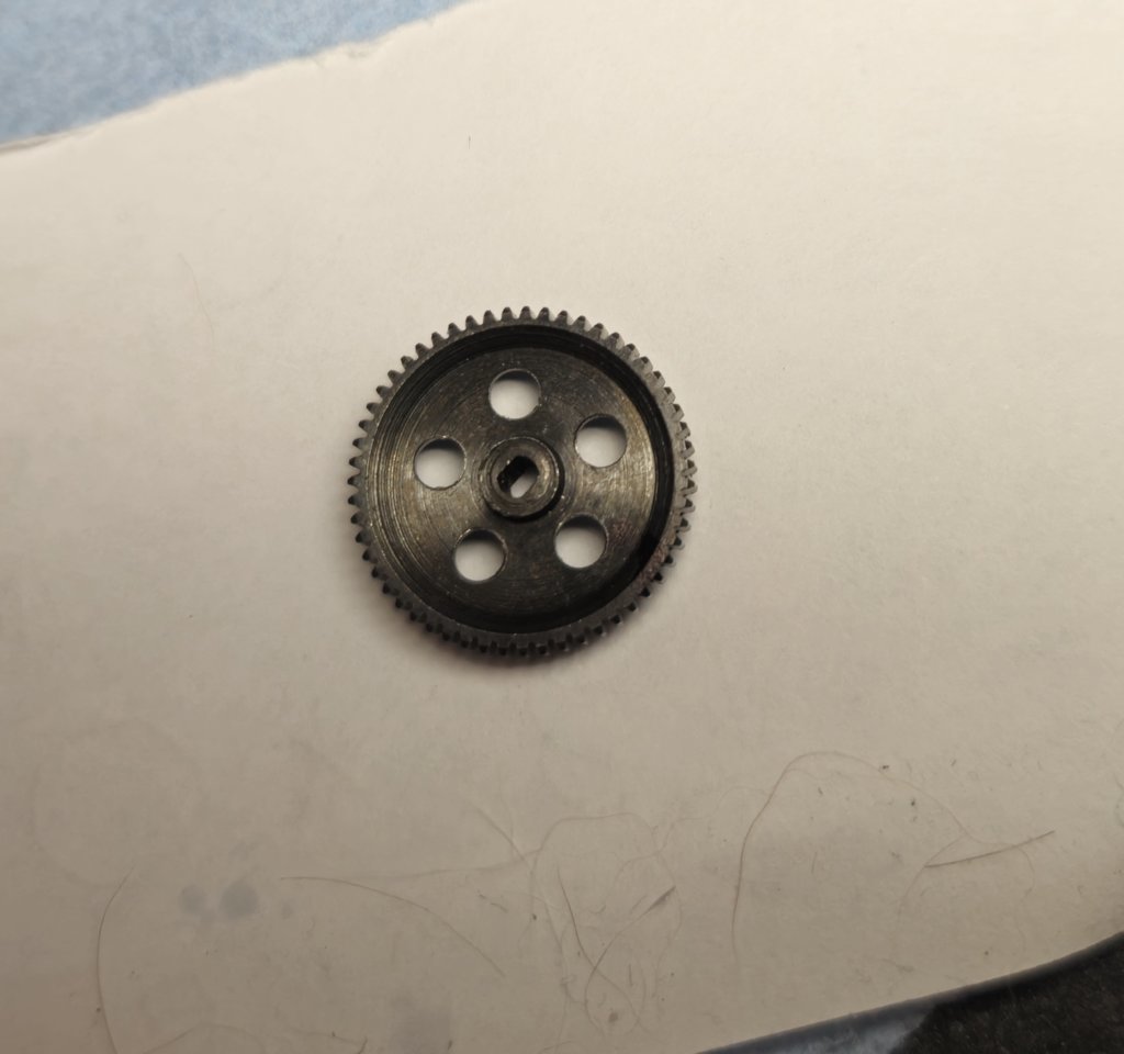

    16t pinion and I can't even see the teeth on the spur. :rofl:
    you can see where the spur takes up that space in the case/mount. The SCX mount doesn't have that bump in the case, so the spur must be smaller as it's spinning on the same shaft.
    Blow this up and see if you can count it. :D

    Take a close up picture like mine above :luvya:

    That is from 6" away :luvya:

    Same pic, edited.:luvya:
  18. Jan 25, 2025 at 7:36 PM
    Kwikvette
    Feb 27, 2019
    #284735
    81,892
    Fresno County
    4 run, 2 don't
    That is also a 55T.
