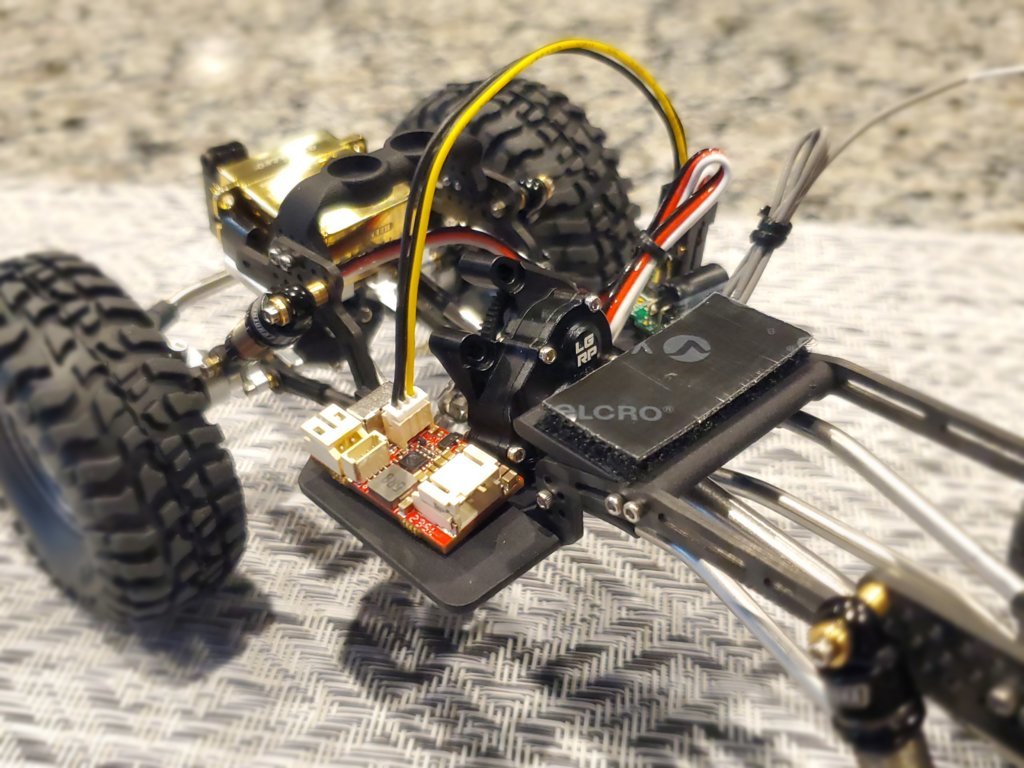

    It's alright, I have my Reefs servo installed.
    Thinking I can run it as is and really just bought the NSDRC so it better matches the body.
    Have you laid out your wiring?
    This is how mine will be, and once the motor arrives I'll go ahead and mount the ESC and RX to the skids.

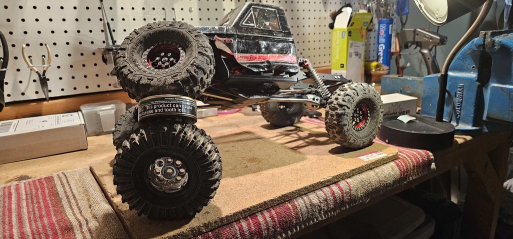

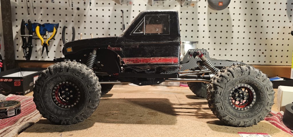

    Don't tell Vanquish I did this. It's just temporary until the real body arrives. At least I can test it today.
    SliMbo4.0, nd4spdbh, Shad194 and 3 others like this.
